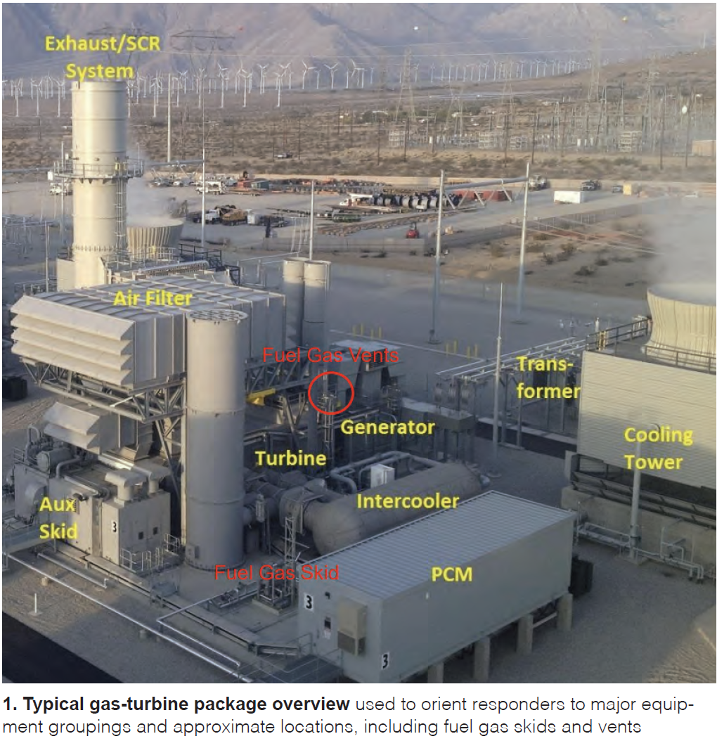

Challenge. Even well-trained emergency responders can be disadvantaged by an unfamiliar site. A gas-turbine-based facility includes high-voltage equipment and overhead lines, pressurized fuel gas systems with vents, combustible adjacent materials, and multiple chemical inventories distributed around the plant. Plant layouts also create navigation and access challenges, especially when equipment yards, switchyards, and fenced areas complicate staging and apparatus movement (Fig 1).

  • Fuel gas systems and vents. Review typical package locations, isolation concepts, and how to avoid unintended venting during response.

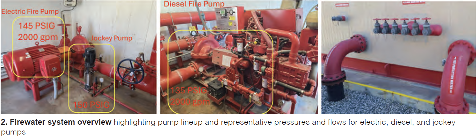

  • Firewater system orientation. Identify pump types and expected pressures and flows to support hydrant and sprinkler operations (Fig 2).

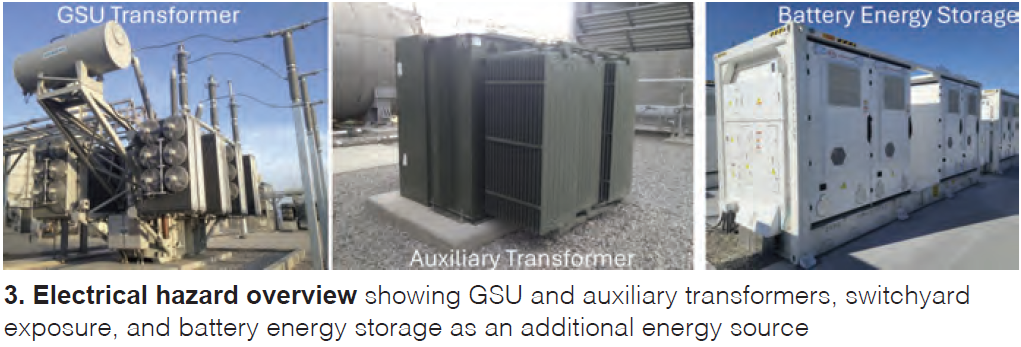

  • Electrical hazards. Emphasize GSU and auxiliary transformers, switchyard exposure, and battery energy storage as additional sources of stored or backfed energy (Fig 3).

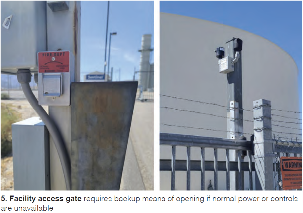

  • Access and egress. Confirm which access gates need a backup means of opening if the site is de-energized and normal controls are unavailable (Fig 5).

  • General access: Whether gates can be locked or held open during de-energization, and whether load limits or unusual site features affect apparatus access.
