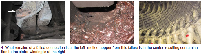

At the extreme high end of the damage spectrum is the failure of the 900-MW generator in Fig 4. Repair involved installation of a new stator winding, a rotating-field rewind to facilitate cleaning of the winding, and extensive and difficult cleaning of the core and frame. The failure was catastrophic in that it involved a six-month forced outage costing more than $100 million in repairs and replacement power, according to Maughan, who has first-hand knowledge of this accident.
All of these conditions would have been radiating high electromagnetic-interference (EMI) energy for some period before failure occurrence. This could have been detected and the failure prevented, Timperley said.

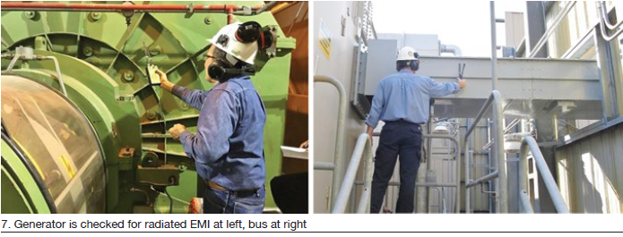

Maughan and Timperley introduced the editors to a small, hand-held instrument on the market that can readily measure the strength of this radiation, the Partial Discharge and EMI Locator (Model 246A, Fig 5) from Radar Engineers, Portland, Ore. There may be other instruments available with the capabilities of this device, but the authors are not aware of any.
This device weighs less than a pound. It is versatile and has a wide range of sensitivities—low using the magnetic H-field antenna, high using the LF/HF/UHF electric E-field antenna. The instrument comes with written instructions for use in a powerplant and can be used without formal onsite training.
The Model 246A has been in use since about 2000. Widespread application has been limited primarily because its availability and capability were not promoted. With this instrument, sources of EMI are identified simply by scanning equipment on a plant walk-around and observing the output of the device (Fig 6). A typical generator or bus can be scanned in a few minutes (Fig 7).
Experience suggests that roughly 90% of typical equipment failure modes emit detectable radiation EM energy, thus accounting for the high potential value of the test.
By observing the location and magnitude of detected signals it is possible to make valid judgments relative to the nature of suspected deterioration. Based on this information, necessary inspection and additional tests can be planned to reduce the likelihood of further damage and/or forced outage on specific equipment.
If signals of concern are identified, trending of signal magnitude over time can be helpful in assessing equipment condition.

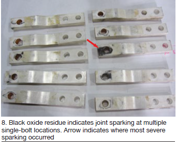

Despite its limited use, the Model 246A and its predecessors have found many dozens of actual defects ranging from minor to serious (sidebar). A particularly instructive and important case involved the large generator that suffered the damage in Fig 4. After this generator was repaired, it was decided to use the Model 246A instrument to survey the repaired generator and an identical sister unit.
While the survey of the repaired unit did not detect any winding or connection problems, the survey of the sister machine identified minor EMI activity in the connection area (the location of the first unit’s failure). It was decided to monitor this area until the next scheduled outage one year later. A scan a few months before the scheduled outage showed continued minor sparking related to the endwinding or phase leads. Note: There was no difficulty obtaining the EMI signals through the imperfect Faraday Cage of the generator terminal box.

When the generator was removed from service, engineers found the bolted flexible joints from connection ring to neutral had started to loosen and were sparking. Flexible connectors for one joint are shown in Fig 8. The engineers believed this generator was well on its way to a catastrophic failure like the one suffered by its sister unit.
