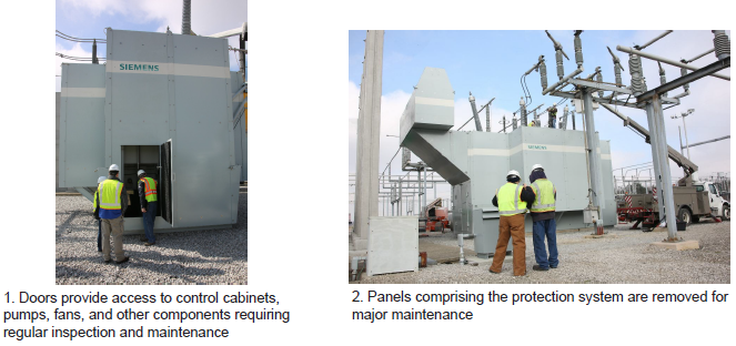

Siemens’ bullet-resistant panels for new and retrofit applications are supported on brackets that attach directly to the transformer foundation or to the oil tank and protect the tank, cooling equipment, conservator, turrets, and the bottoms of bushings—all while allowing air movement for efficient cooling. Neoprene strips isolate the panels from the support structure to minimize the transmission of vibration.

    • First step is a site survey to review the condition, location, etc, of the transformer and its foundation. Only a few days are required for this effort once the survey crew is onsite. At this stage of the project it’s important to decide where access doors will be required in the panels to allow, for example, maintenance of cooling fans (Fig 1).
    • Expect the weight of the protective panels to run 50 tons. For comparison, a typical large transformer will tip the scales at 200 tons (350 tons with oil), which means some foundation work might be needed. In most cases it is possible to install a new pad to support only the panels.
    • Second step is to provide applicable drawings and other materials required by the engineers in Europe who do the requisite analyses and engineering work. Figure this phase of the project to take a couple of weeks.
    • Third step includes manufacturing offshore and shipping to the plant site. This likely will take several weeks.
    • Last step, installation, will take a week or less (Fig 2).
