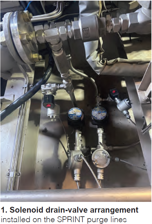

Challenge. The instrument-air purge solenoids were not completely watertight, allowing water to migrate past them as the SPRINT system cycled on and off. When SPRINT check valves degraded or failed, even more water migrated downstream and into the instrument-air system.
The operational impact extended beyond the SPRINT package. Exira experienced repeated problems across multiple systems that depend on instrument air, and the station attributes the condition to several forced outages. Cold-weather exposure increased the consequence: moisture in air systems can contribute to sluggish valve response, failed actuation, and freeze-related restrictions that are difficult to diagnose during short-notice peaking starts.
Solution. Added solenoid drains to SPRINT purge lines. Exira installed solenoid drain valves that operate in opposition to the existing instrument-air purge solenoid valves (Fig 1). The design intent is to remove water at the point of entry, before it migrates into the instrument-air header.
Key elements of the retrofit:
- No control system changes. The new drain valves are wired using the existing solenoid valve wiring.
- Opposed operation. When the purge valve is open, the drain valve is closed. When the purge valve is closed, the drain valve opens.
- Drain to package. When SPRINT is online, the SPRINT check valve should see pressure that keeps it closed. If water passes the check valve, the drain arrangement provides a path for that water to discharge into the package instead of progressing into instrument air.
The modification provides a simple visual indicator for operators and technicians. If water is observed inside the package, it suggests the associated check valve may be passing and should be inspected. That visibility helps shift the response from reactive troubleshooting of plant-wide instrument-air symptoms to targeted evaluation of the likely leakage path.
