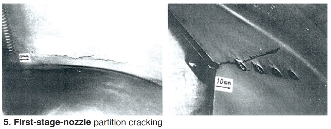

The hot-gas-path (HGP) parts shown in Figs 3-5 will be prone to cracking and distortion if fast starts are used too often. This is particularly true of the first-stage turbine-nozzle partitions and turbine buckets. The OEM says rapid heating without the recommended warmup period may shorten the lives of internal parts by a factor of five.
This means HGP inspection inspections will be required more frequently and the cost of repairs or replacement parts will be significant. Particularly vulnerable to cracking are the trailing edges and sidewalls of the nozzle partitions. Recall that the most expensive parts in the turbine are in the HGP because they are made with the most sophisticated materials and require precise heat treatment.
In Fig 5, consider that if the nozzle partition cracks propagate to connect in a way that material liberation could occur, repairs or a replacement nozzle is highly recommended. You don’t want liberated material traveling downstream and damaging rotating or stationary components in the flow path.
