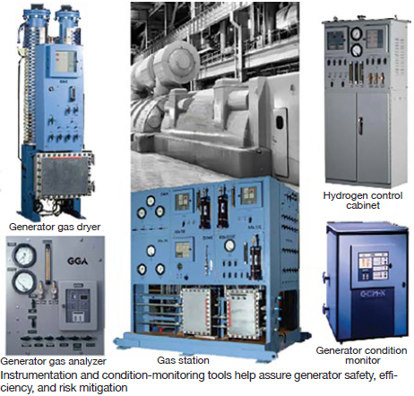

Environment One. FPL case study discussion: Automating your generator degas process, Gary Griffin, generator engineering and operational support services leader, Florida Power & Light Co, and Gus Graham, director of products and markets, and Mark Williams, regional manager, E/One Utility Systems.
If you’re considering the automation of your generator’s degas process, this webinar was made to order. FPL’s Gary Griffin, in his fourth decade of serving the electric power industry, presents a case study that answers questions such as:
    • Why automate the degas process?
    • What safety elements can be achieved from the project?
    • What technical requirements should you consider? This includes such considerations as logic location (DCS or local panel), size or presence of the CO2 vaporizer, time to vent/purge, fill time, generator pressure at CO2 fill, seal-oil pressure control during vent/fill, valve and tubing specifications, etc.
    • What challenges might arise in project implementation?
E/One instrumentation and condition-monitoring tools available to assure generator safety, efficiency, and risk mitigation are summarized.

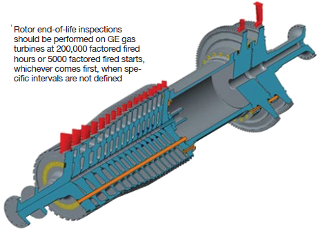

EthosEnergy, You can run longer: What to do when your GE gas turbine is reaching the designed rotor end-of-life limit, Kale Dreymala, gas-turbine rotor project manager, EthosEnergy Group.
In case you missed this webinar in October 2019, rest assured. On April 21, 2020, CCJ and EthosEnergy will once again be onscreen to present an updated versions of last year’s webinar. Register here. Read on for some background.
If your plant is equipped with a GE industrial gas turbine—Frame 3, 5, 6, 7 (A, B, C, E, EA, and/or F)—and mention of the OEM’s Technical Information Letter 1576 doesn’t make your ears perk up, you need to listen to this webinar. Even if you’ve heard about TIL-1576, it’s worth listening to for a refresher.
TIL-1576, released in 2007 and updated in 2011, identifies the equipment and personnel risks associated with operating gas-turbine rotors beyond 200,000 factored fired (FF) hours (144,000 for F-class units) or 5000 FF starts, whichever comes first, when specific intervals are not defined.
Kale Dreymala will take you through the inspection scope recommended by EthosEnergy Group (EEG) for turbine wheels, distance piece/spacers/stub shaft, and compressor wheels. If there are no findings, the rotor is reassembled with new bolts and your engine receives a certification for an additional 50,000 FFH (one time only).
If there are findings, the speaker says the OEM is likely to suggest buying a new rotor or possibly a replacement wheel or disc if that is the life-limiting part.
An affordable aftermarket solution suggested by EEG probably would be to obtain a used rotor with a documented history and refurbish it in the shop. The additional life certified (from 50,000 to 200,000 FFH) depends on an engineering review.
Dreymala will describe EEG’s capability for manufacture and qualification of new rotor components as might be required during the refurbishment process get the best balance between cost and additional life.  Other rotor options also will also be presented during the webinar.
