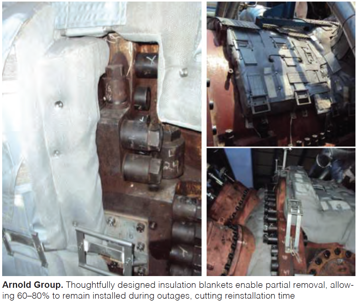

Heat rate improving insulation for GTs
Arnold Group
Pierre Ansmann presented a high-performance insulation system for gas turbines designed to reduce heat loss, improve plant efficiency, and extend component life across W501, M501, and M701 frames. The 3D single-layer insulation system replaces conventional multi-layer or pin-mounted designs that often suffer from sagging, hot spots, and material degradation after a few cycles. Each blanket is individually shaped and calculated for consistent surface temperature, maintaining a maximum of 15°C above ambient across the turbine casing.
The system features interlocking 45° interfaces between blankets to accommodate thermal expansion without creating gaps, eliminating hot spots that can damage nearby components. A stainless-steel substructure fixed by stud welding provides permanent support and safer access for maintenance, while high-temp Velcro fasteners allow selective removal during outages without disturbing adjacent sections. This approach enables up to 60–80% of insulation to remain installed, saving one to three days in outage reassembly time.
Field installations show significant gains in enclosure temperature uniformity and measurable heat rate improvement. Comparative testing demonstrates up to a threefold reduction in heat loss versus standard systems, along with surface temperature reductions exceeding 40%. The result is a robust, maintenance-efficient insulation solution that supports long-term reliability and performance.

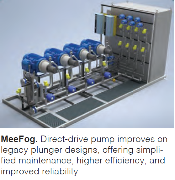

Mee Industries
Slides review the design, reliability, and maintenance considerations of high-pressure fogging and wet compression systems for gas turbines. The technology provides 22 to 28 MW of additional power output at a cost below $50 per kW/hr, achieved through fine atomization and controlled droplet size to maximize evaporative cooling efficiency.
Approximately 90% of MeeFog droplets measure under 20 microns, promoting faster evaporation and minimizing compressor erosion compared to OEM nozzles, which typically produce droplets 3.4 times larger in mass.
The system integrates multiple protective and diagnostic features, including continuous water-quality monitoring through conductivity meters that trigger alarms and automatic shutdowns when conductivity exceeds turbine safety limits. Additional safeguards include drain activation interlocks to prevent large water droplets from entering the compressor.
Recent installations feature direct-drive pump designs and variable frequency drives in climate-controlled or NEMA 4-rated enclosures for improved control and reliability. Over 22,000 operating hours of field data demonstrate stable performance with no reported erosion issues. The presentation emphasizes precise droplet control, automated protection systems, and modular upgrades as key factors sustaining long-term operational reliability in fogging and wet compression applications.

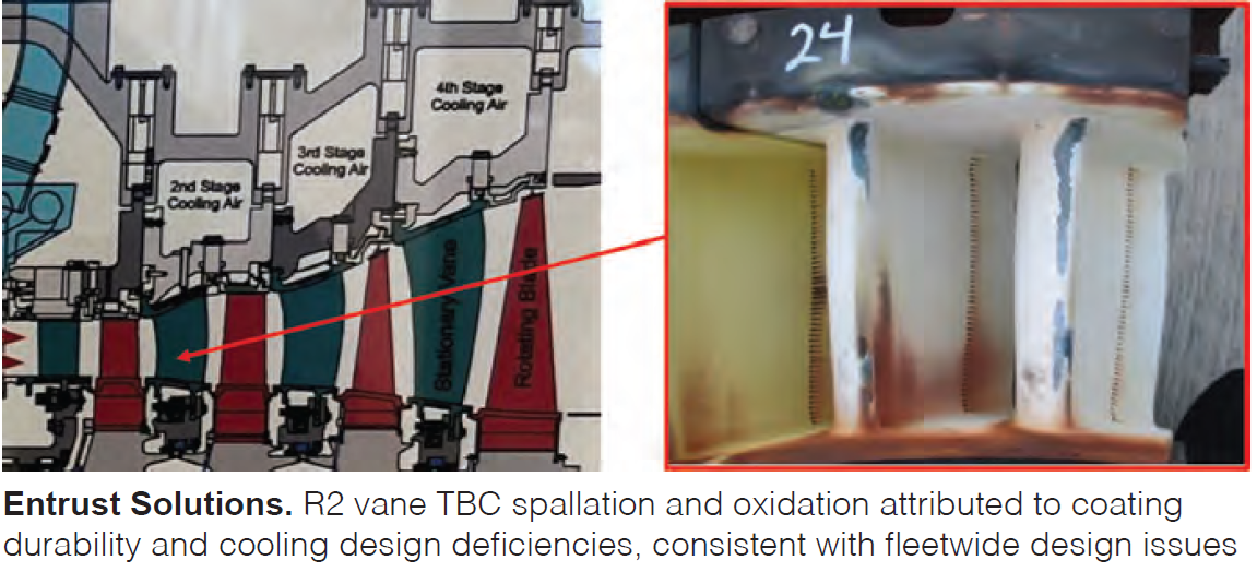

This presentation outlines Entrust’s structured, data-driven approach to root cause analysis (RCA) for turbine and generator failures, applying the Kepner-Tregoe method to distinguish probable mechanical, metallurgical, and operational contributors. The process integrates field inspection, finite element analysis, life assessment, and metallurgical evaluation to verify failure mechanisms and guide corrective actions.
A 501FD3 air separator failure case study attributes damage to fatigue cracking and liberation of the hammerhead section, initiated by fretting and compounded by thermal and centrifugal stress. A second case involving R2 vane burn-through links coating spallation and oxidation to a design deficiency in thermal barrier coating selection and vane cooling. Together, the examples illustrate how disciplined RCA supports fleet reliability, OEM negotiation, and preventive maintenance strategy.

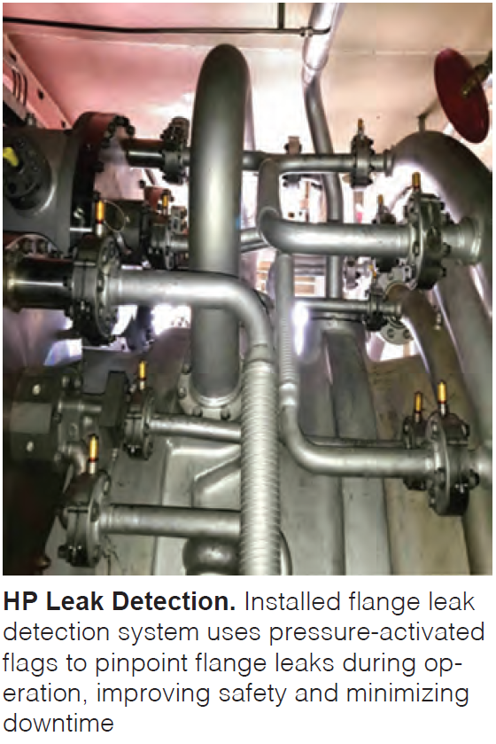

Flange gas leak detection to maximize safety at reduced cost
HP Leak Detection
Learn about a patented flange leak detection system that identifies active fuel and compressor leaks during operation using visual flag indicators that trigger at approximately 6 psi. It eliminates unsafe manual leak checks, shortens troubleshooting time, and prevents costly outages.

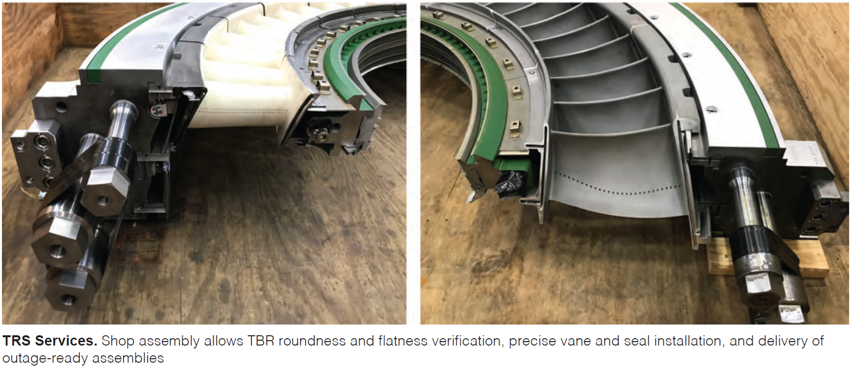

TRS Services discussed a structured approach to repairing and assembling 501F and 501G turbine blade rings (TBRs) to reduce outage delays and improve fit-up accuracy. Field cases show that TBRs often exhibit radial out-of-roundness and axial distortion after engine service, affecting vane alignment and interstage seal housing fit.
Using precision jacking fixtures, TRS restores roundness from 0.117 to 0.037 in. total indicator runout and flatness from 0.085 to 0.022 in. Repairs include dimensional restoration, downstream deflection correction, and braze preform applications for vane and seal surfaces. Performing TBR centralization and assembly in a controlled shop environment ensures alignment accuracy, minimizes on-site labor, and shortens outage duration.

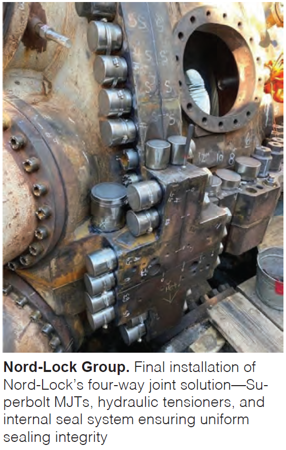

Four-way-joint and coupling-bolt solutions
Nord-Lock Group
Company provides engineered solutions addressing persistent leakage and maintenance issues at turbine four-way joints and coupling interfaces. The four-way joint design combines a variety of custom solutions to correct cylinder misalignment and achieve uniform tensioning. The system integrates an internal sealing assembly with adjustable retainers that prevent air escape and accommodate thermal expansion during operation.
For coupling interfaces, the EzFit mechanical expansion bolt replaces traditional fitted bolts that are prone to galling and removal difficulties. EzFit allows installation and removal with hand tools while maintaining high torque transmission and precise shaft alignment.
Field cases show installations completed in under three hours, significantly reducing outage duration and machining time. Together, these technologies improve sealing reliability, alignment precision, and maintenance efficiency for the 501F and 501G fleets.

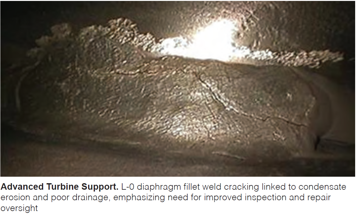

Steam turbine major contingency planning
Advanced Turbine Support
In a lively vendor session led by Bryan Grant, attendees were urged to treat steam-turbine major-outage contingency planning as a structured, 18-month process. The goal: lock down scope, suppliers, spares, people and specialty tooling early enough to avoid delaying the outage critical path.
Start 18 months out. Grant recommended beginning with scope development, budget approvals and RFQ packages; supplier vetting and parts quote lead times often dictate schedule realism. Aim to release POs roughly a year ahead to secure shop and field capacity.
Build scope from history and TILs. Use outage, operations and fleet history to frame risk; then review OEM technical information letters (TILs), confirm open/closed status, and bring in independent technical expertise. Don’t rely solely on OEM guidance; leverage user groups and subject-matter experts to stress-test “what-if” scenarios.
Identify critical spares. Priority components include diaphragms (with L-0 fillet-weld issues), rotors, HP/IP front-end blades, L-0 mid-span sleeves, stationary packing and heads, valves, bearings, and oil-system hardware.
Plan roughly 90 days for RFQ through PO, which covers shop support, repair resources and contracts. Then hold 60-day gates for scope finalization and maintenance/operations review to keep alignment.
Control manufacturing and repair risks. Top shop-floor defect drivers called out: drawing-revision errors, insufficient CNC-program verification, operator qualification gaps, missed operations in the manufacturing process plan, documentation and gauge errors, and material-selection mistakes. Treat finger-dovetail and cover installs as high-risk steps; verify fit before reaming and inspect before closing.

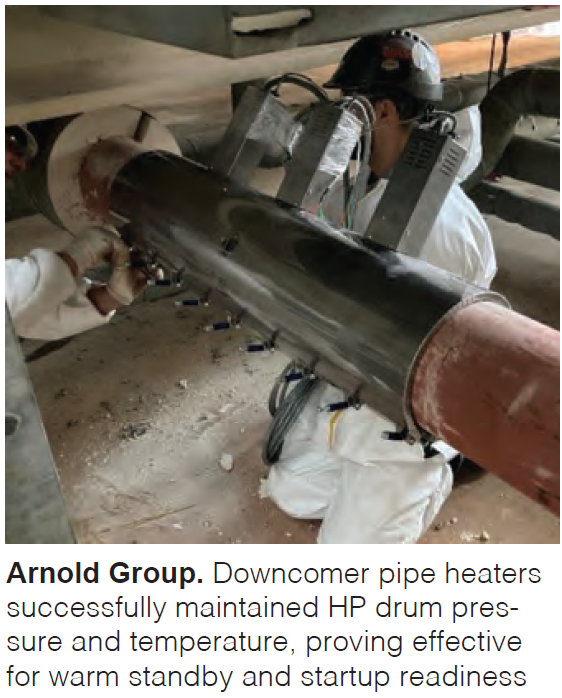

Steam turbine warming system for CCGT flexibility
Arnold Group
If dispatch appeal and reduced startup costs are what you desire, then Norm Gagnon urged users to consider this three-pronged approach—steam-turbine warming, HRSG warming, and steam-valve service—aimed at improving starting reliability, emissions performance, and cycling life for your CCGT units.
A D11 steam-turbine warming case study reports total plant cycle time cut from 266 to 149 minutes, ~25% HP-rotor LCF reduction, and hot-start temperature hold for ~60 hours using insulation alone; casing differentials dropped up to 95% with active warming. Key takeaways include up to 75% startup-time reduction and ~50 kW parasitic to maintain temperature at shutdown.
An evolving HRSG warming concept, verified in an EPRI project, uses custom heating panels and PLC control to maintain ~200°F in HP drum downcomer piping with ~300 kW power; test demonstrated maintaining ~20 psig drum pressure for hours and reduced thermal shocks compared to sister unit.

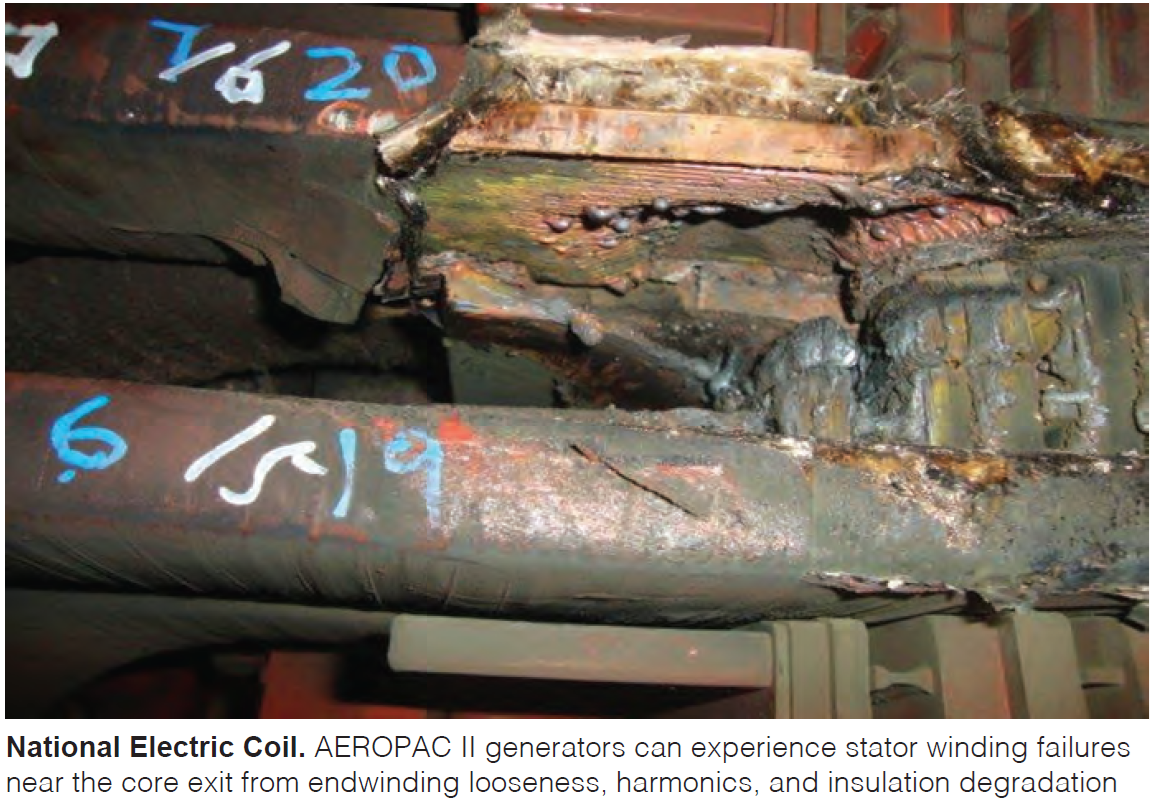

Howard Moudy briefed attendees on maturing 501F/G generator fleets. With most units at or beyond 30-year design life he reiterated persistent focus areas: air-cooled generator issues, cyclic-operation damage, GVPI failure modes, and model-specific known issues.
For AEROPAC I units, common pain points include partial discharge (PD), end-winding looseness/resonance, phase-ring and flex-link failures, and rotor pole-to-pole risks. NEC’s response centers on pole-to-pole crossover upgrades (in-situ or rotor-out) and stator rewinds using optimized coil designs, upgraded OCP, improved coil-to-slot interfaces, and verified detuning via bump tests.
AEROPAC II (GVPI) machines show PD, end-winding looseness/harmonics, slot movement, and end-winding failures near the core exit; diagnostics emphasize bump tests, EMI/PD monitoring, and borescope inspections. Solutions range from pole-to-pole hardware replacements (connectors, shrouds, radial blocks) to selective stator rewinds, sometimes converting GVPI to conventional systems.
NEC’s closing message: know your unit’s known issues, monitor them methodically, and plan proactive fixes to avoid forced outages.

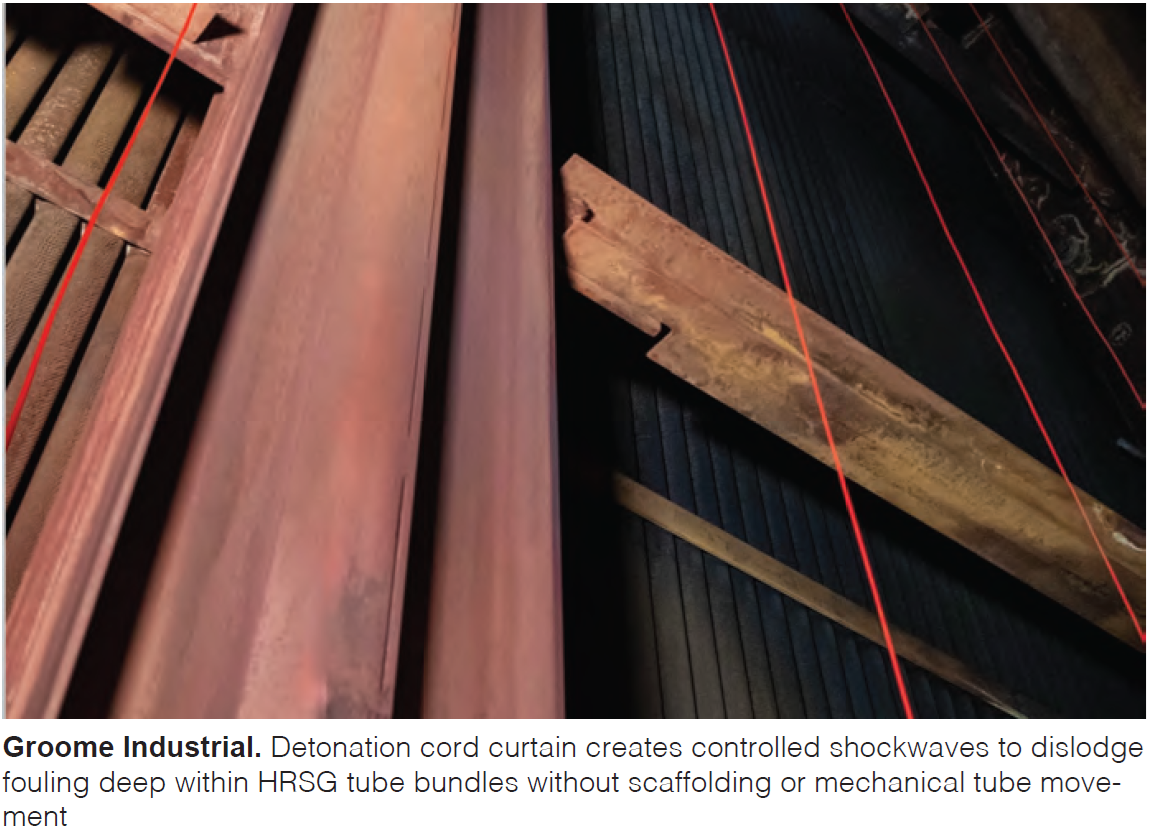

KinetiClean™ HRSG tube cleaning technology
Groome Industrial Service Group
Growing demand for peak output and efficiency places HRSG cleaning in the spotlight, offering one of the most attractive ROIs in CCGT plant optimization regardless of cleanind method. The patented KinetiClean™ process removes fouling and deposits from HRSG finned tubes using a controlled three-step method. The system combines a kinetic shockwave generated by a detonation cord curtain, automated high-pressure air distribution, and in-house debris removal to achieve full-coverage cleaning without tube spreading, scaffolding, or manual handling.
Each curtain is engineered for the HRSG’s size, fouling level, and fin configuration, ensuring deep penetration into tube bundles and removal of iron oxides, ammonia salts, and other contaminants. The detonation cord is cap-sensitive and handled only by licensed blasting professionals, ensuring safe, non-destructive operation.
Case studies demonstrate measurable performance gains: a derated Northeast CCGT plant reduced backpressure by 2.4-in water column (WC), recovered 9 tons of debris, and restored baseload operation, while a Southeast site saw a 1.5-in WC drop in dP and a 2–4 MW output increase across two units.
KinetiClean improves heat transfer, lowers stack temperature, and restores gas turbine heat rate while minimizing outage duration. Independently reviewed by EPRI and approved by Siemens Energy, the method offers a reliable, repeatable, and safe approach to HRSG cleaning that supports efficiency recovery and sustained CCGT performance.

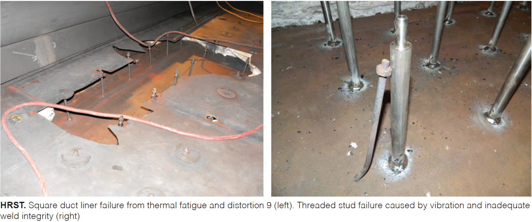

Transition duct enhancement: A 3D-scanned approach
HRST Inc
Slides detail a case study on improving the Siemens SGT6-5000F transition duct using LiDAR-based 3D scanning to address common liner and stud failures. The round-to-square duct, measuring roughly 13 ft in diameter and 14 ft in length, presents geometric challenges that have historically led to stud cracking, scallop bar detachment, and liner misalignment. Traditional field measurements and incomplete fabrication drawings made precision retrofits difficult.
To overcome these issues, HRST deployed LiDAR scanning to capture a detailed point-cloud dataset of the duct interior. Integrating this data with CAD tools enabled accurate modeling of stud locations, liner geometry, and sheet-metal cut patterns to ensure exact fit-up. The 3D overlay verified component interfaces before fabrication, minimizing rework and installation errors.
Installation procedures emphasized alignment of centerlines, shingled liner orientation for gas-flow optimization, and welded washer retention for structural integrity. The approach demonstrated how combining high-resolution scanning with disciplined installation practices can extend duct life, enhance reliability, and reduce turnaround times.

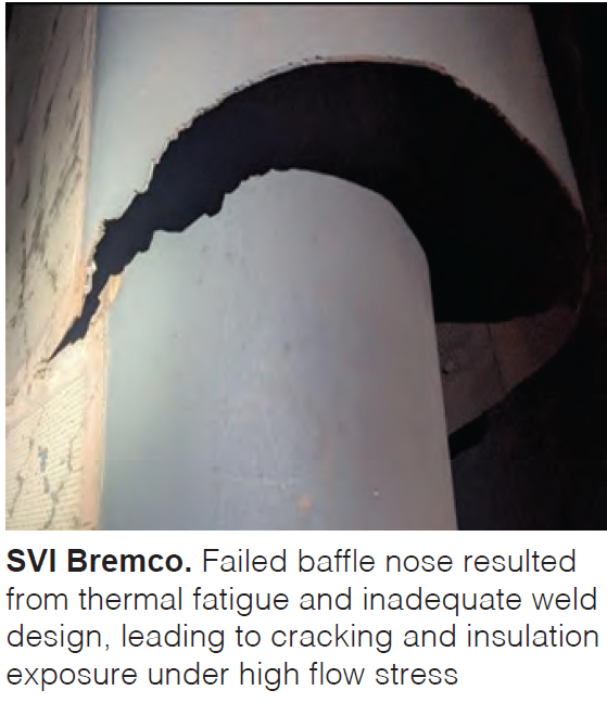

CT exhaust silencer design approach
SVI BREMCO
Tucker York invites end users to read up on his engineering-based approach to CT exhaust silencer design, emphasizing material selection, structural integrity, and long-term reliability. The presentation covers parallel, bar, and cylindrical silencer types used in simple-cycle, bypass, and HRSG exhaust systems, each engineered to reduce turbine-generated noise and backpressure.
Design methodology incorporates finite element and computational fluid dynamics analysis to assess thermal fatigue, creep rupture, and vortex-induced vibration. Material choice—typically 409SS, 11Cr-Cb, 304SS, or 321SS—is guided by ASME II, Part D allowable stress limits for high-temperature service.
Fabrication guidance covered stitch and plug-weld techniques for perforated skins, protection of acoustical pillows/insulation, and common failure root causes with corrective practices.

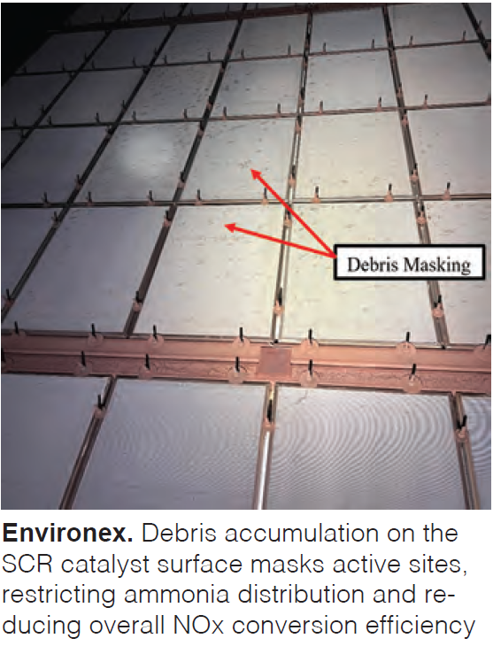

Andy Toback dove deep into strategies to extend the operating life of SCR and oxidation catalyst systems through detailed system evaluation, data analysis, and sample testing. Accessing his extensive slide deck is highly recommended after reading the Cliffs Notes version below.
Catalyst degradation is often accelerated by factors external to the catalyst itself, including exhaust temperature variability, uneven ammonia injection, seal leakage, and particulate buildup. Comprehensive inspections assess catalyst face fouling, side and floor seal integrity, bypass leakage, and ammonia injection grid condition to identify non-catalyst issues limiting performance.
Operational data analysis, typically spanning two to three years, includes load profiles, catalyst differential pressure, NOx inlet and outlet concentrations, ammonia slip, and vaporizer performance. Laboratory testing of catalyst samples across multiple temperatures and NH3-to-NOx ratios determines true activity levels and projects remaining service life based on the most demanding operating mode.
Field experience shows that a full-system approach (mechanical inspection, operational review, and analytical testing) extends catalyst service intervals, minimizes ammonia slip, and maintains emissions compliance at lower reagent consumption. Targeted corrective actions can realign catalyst performance with design expectations, helping operators preserve compliance margins, reduce operating cost, and avoid premature catalyst replacement in both combined-cycle and simple-cycle gas turbine applications.

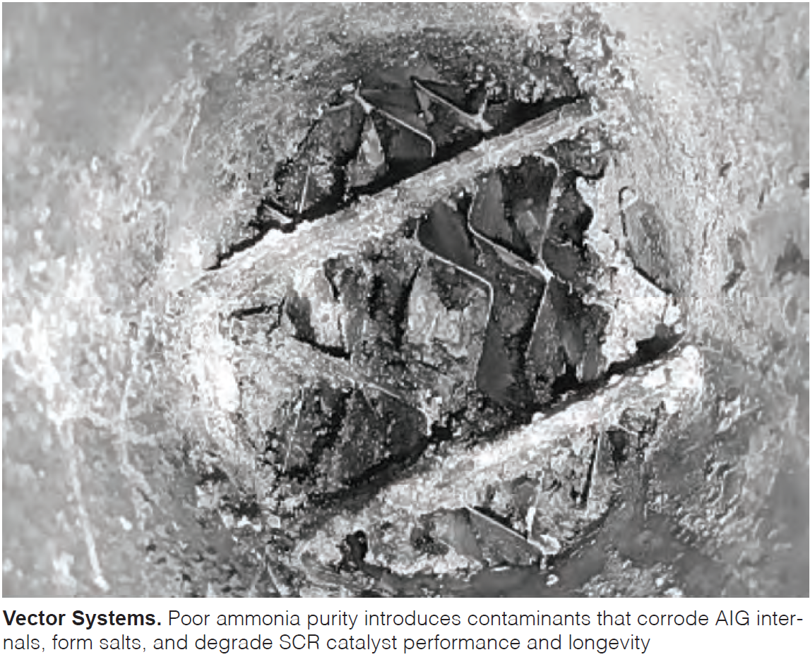

Vector Systems
Vaughn Watson dives into how AIG tuning directly affects SCR performance and catalyst life. Uneven NH3-to-NOx ratios often stem from maldistribution, velocity stratification, and fouling in AIG lances, leading to elevated slip and inefficient NOx reduction. Precise tuning aligns NH3 flow with measured NOx profiles, optimizing reaction uniformity and minimizing reagent use.
Case studies highlight these benefits. In one F-class CCGT retrofit, Vector’s Katana AIG reduced ammonia consumption by up to 40% and stabilized NOx control without catalyst replacement. Another 501F site resolved poor performance in a new catalyst by rebalancing AIG flow after discovering excessive maldistribution caused by reduced system pressure drop. Together, the results demonstrate how AIG geometry, orifice precision, and in-situ tuning restore SCR performance, extend catalyst service life, and reduce total operating costs.
CT outlet expansion joint and transition duct liner issues
IAFD

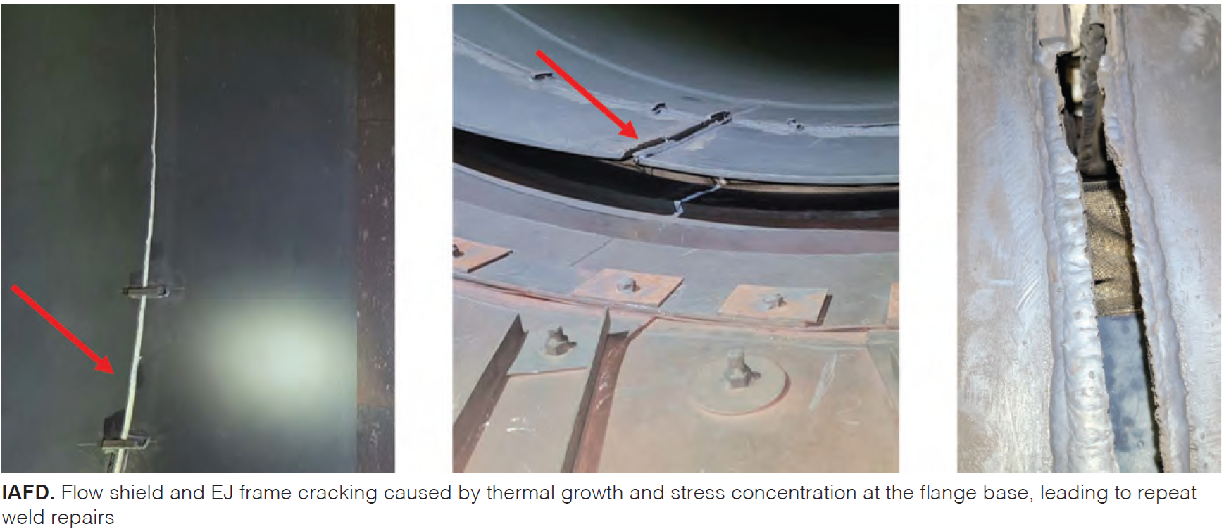

This presentation analyzes failure mechanisms and upgrade strategies for Siemens 501F/G outlet expansion joints and adjacent transition duct liner systems. Accelerated wear in fabric joints is traced to startup vibration and operational flutter, all intensified by engine performance upgrades that increase exhaust energy. Original joint materials and frame geometries exhibit high stress at the base of the EJ flange, promoting cracking at weld interfaces.
IAFD recommends redesigned flanges that accommodate thermal growth and flexible, heavy-duty PTFE-based joint materials with improved insulation to resist fatigue and flutter. Thermographic inspections reveal consistent liner plate deterioration, misaligned overlaps, and insulation breakdown contributing to localized hot spots.
Corrective actions include increased stud density, proper baton channel installation, and re-lapping of liner plates to maintain gas-tight integrity. These targeted upgrades enhance structural flexibility, extend component life, and reduce recurrent welding and outage frequency in aging units.

Expansion joint upgrades for legacy 501FD and 5000F units
Frenzelit Inc
Case studies were presented on recent field upgrades to exhaust expansion joints on legacy 501F units. Failures in original manifold sections are linked to moisture intrusion, vibration during low-load operation, and thermal cycling fatigue. The upgraded design introduces scalloped TEM flanges and reinforced flow shields to reduce stress concentration at weld joints. Enhanced soft goods protect against water ingress and startup pulsing, while redesigned hard parts maintain flexibility through repeated thermal cycles. Externally, spring-loaded insulation bands keep the manifold wrap tight during expansion and contraction, preventing radiant heat exposure on the lower joint. The improvements extend durability and minimize maintenance frequency for aging F-class equipment. CCJ
