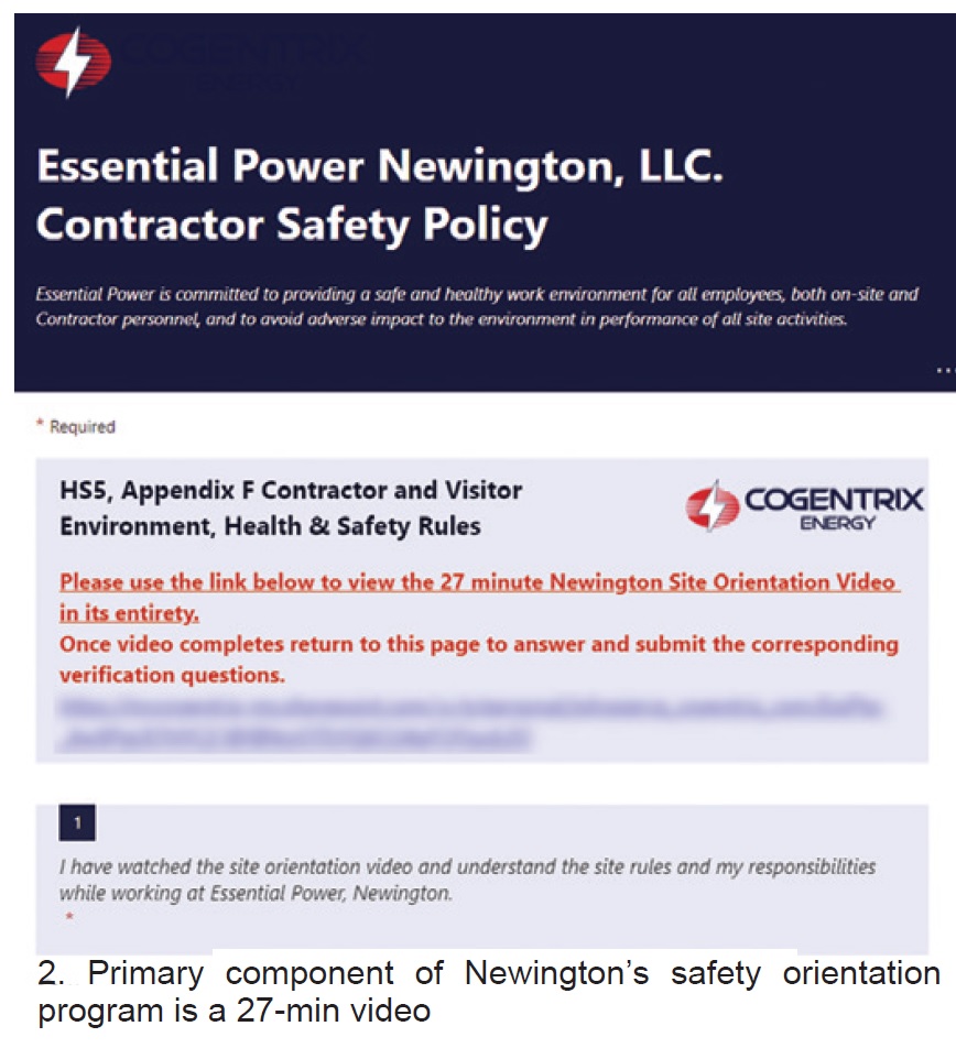

Solution. Staff explored various electronic resources to deliver its safety orientation video, facility EH&S rules (Fig 1), and NERC CIP compliance protocols to personnel arriving onsite. Critical quality features included the following: (1) ease of use for the end user and administrator, (2) ability to edit content as needed going forward, (3) compatibility with mobile phone use, and (4) ability to electronically verify completion.
Microsoft Office 365’s Forms program was the solution selected. It has the ability to e-mail contractors/vendors a message with an optional QR code and/or forms.office.com hyperlink.
Use of a mobile device and QR code allows quick navigation and orientation, and completion of required tasks. A hyperlink also is provided for PC use. Once the user receives the e-mail and accesses the form using either the QR code or link, he or she is able to review a customizable and site-specific embedded SharePoint link to the site’s 7-min orientation video (Fig 2).
There also are several easily navigable electronic forms to review and verify completion.
Once the video has been watched and the form completed, the user initials the electronic form and submits it to the site’s EH&S manager. From there, data are compiled in a user-friendly electronic database for staff to review and to track the completion status of contractors. Electronic timing of form completion identifies potential attempts at subversion of the orientation process.
Results. The Office 365 Forms program has been tested by several employees and found effective and easy to use. Having the ability to watch the video and review and submit the electronic form from a mobile device provides contractors a user-friendly method for completing site orientation from outside the plant prior to arriving for the Newington outage.
Plus, electronic submission frees up significant paper resources and filing requirements.
Also, headcounts onsite in contractor orientation workspaces are reduced to those infrequent occurrences where electronic submission was not feasible ahead of time. When prequalified contractor personnel arrive onsite, they immediately report to the specified Point of Contact (POC) and receive their orientation-completion hardhat stickers.
The POC is able to quickly review orientation completion status in the electronic repository and directly answer any questions relevant to the training in the context of the contractor’s work scope.
In sum, investment in electronically facilitated site orientation saves resources and time and the efficiency of contractor safety- and compliance-training certification.

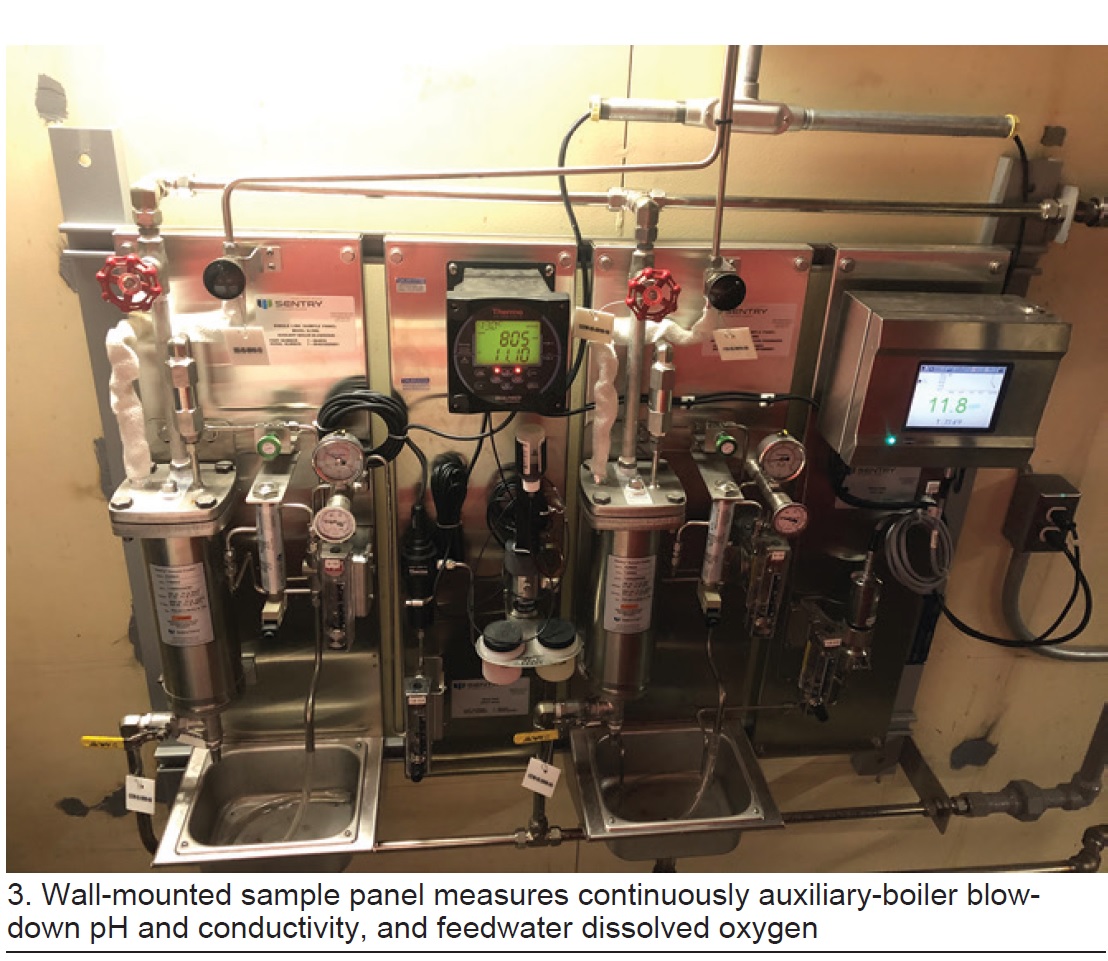

Challenge. EPC engineers integrated a firetube boiler into the design Essential Power Newington for use during cold-plant startups to provide steam for turbine seals and HRSG sparging. The auxiliary steam system includes a deaerator supplied with cold demineralized-water makeup. Aux boiler use for HRSG sparging has increased as the plant moved from its original baseload operating profile to more of a seasonal peaking operation.
Sparging can be necessary for days at a time, or longer, depending on market dynamics and ambient temperature. Treatment chemicals are added via small electronic metering pumps. Chemical-pump stroke rates are adjusted manually based on grab-sample analysis in the water lab by an auxiliary plant operator. The original construction did not include any continuous analyzers to ensure proper control of boiler-water chemistry.
Solution. Site personnel reviewed water-chemistry key parameters for the low-pressure firetube boiler, selecting these three characteristics for continuous measurement: blowdown pH and conductivity, and feedwater dissolved oxygen. Staff then worked with a vendor to design a sample panel to measure the three variables using sampling equipment currently used onsite in the HRSG sampling system (Fig 3).
The final challenge for design of the sample panel was to find a location in the aux-boiler building where the panel would be close to the sample sources while also allowing O&M personnel proper access to other equipment. This involved minimizing the wall panel’s depth to maximize aisle space.
Results. Personnel completed installation of the sample panel during a recent plant outage. Analyzer outputs were wired to the DCS, where screen graphics were added and alarm triggers set. The analyzer outputs also were added to the PI historian for long-term trending and alerts.
While several additional continuous analyzers would be necessary to automatically control boiler chemistry, these three continuously measured characteristics help ensure proper chemistry maintenance between grab-sample analyses.

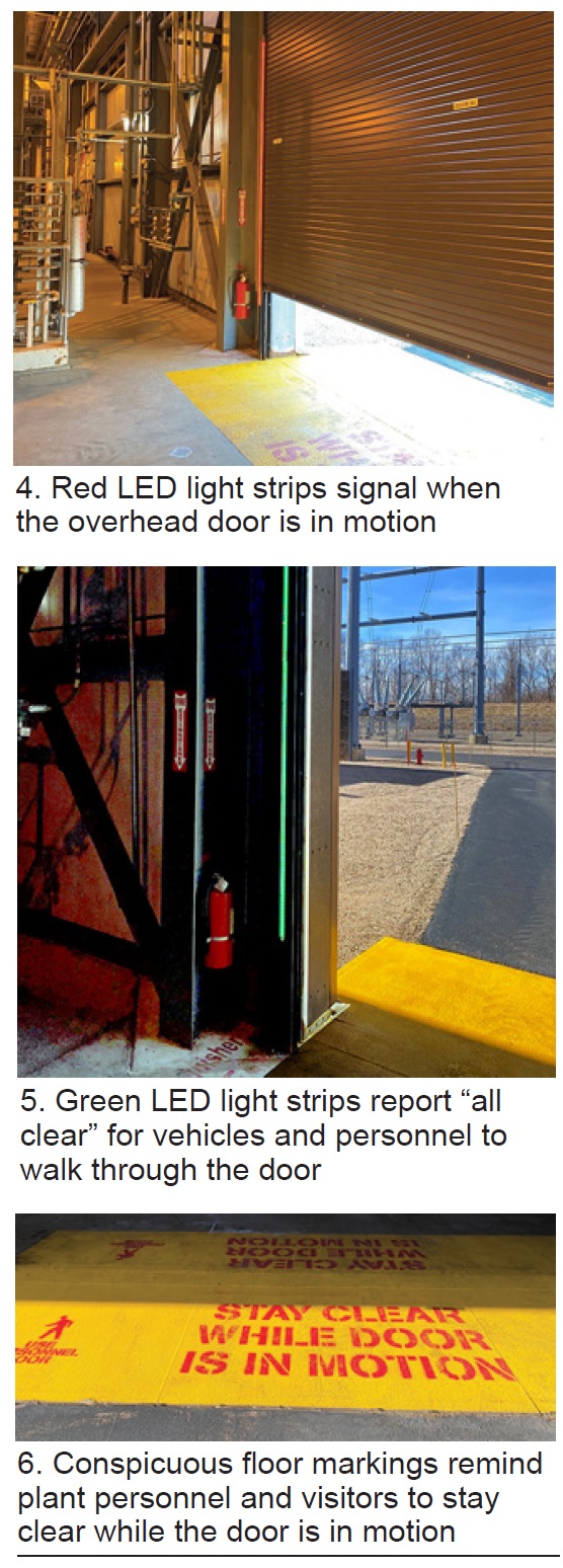

Challenge. Large overhead roll-up doors are a concern in industrial workplaces—a recognized hazard that could cause serious physical injury or equipment damage if not acknowledged and controlled. Reasons include these: They are heavy, may fall closed while traveling if the head works fails, and may not be equipped to auto-reverse when they come in contact with an object or person.
Solution. Staff analyzed options for improving the safety and communications protocols for traversing through the plant’s large 20 × 20-ft turbine-hall overhead doors (Fig 4), commonly used by a large number of people. Visual indicators were deployed to provide additional warning and to remind personnel and visitors about overhead-door safety and site expectations.
Industrial LED light strips were a practical solution. The power and controls for them are incorporated easily into the operation of the door opener while providing warning lights by flashing RED when the door is in motion. Once the door reaches its fully open limit switch, the light strips turn solid GREEN (Fig 5). When the door moves closed, the LED strips again flash RED until the door fully closes against the pressure limit switch; the lights shut off after 30 seconds. The warning-light system is installed on both sides of the door frame, and both inside and outside.
In addition, large floor markings were developed to remind walking personnel to use the adjacent walk-through door for exiting and entering the turbine hall rather than an overhead door.
In conjunction with installation of the light strips on the door frame and conspicuous floor markings (Fig 6), the site instituted a standing directive that the doors not be driven or walked through while in motion. They can be traversed only when in the fully open position and the lights are solid GREEN.
Results. Use of visual stimuli to let staff and contractor personnel know a door is in motion, and communicating that you must not drive/walk through an overhead door in motion, has helped to prevent equipment damage and other safety events. While nothing is fail-safe, the addition of warning lights and floor markings remind about site protocols and the need to wait for the fully open status before moving through.
