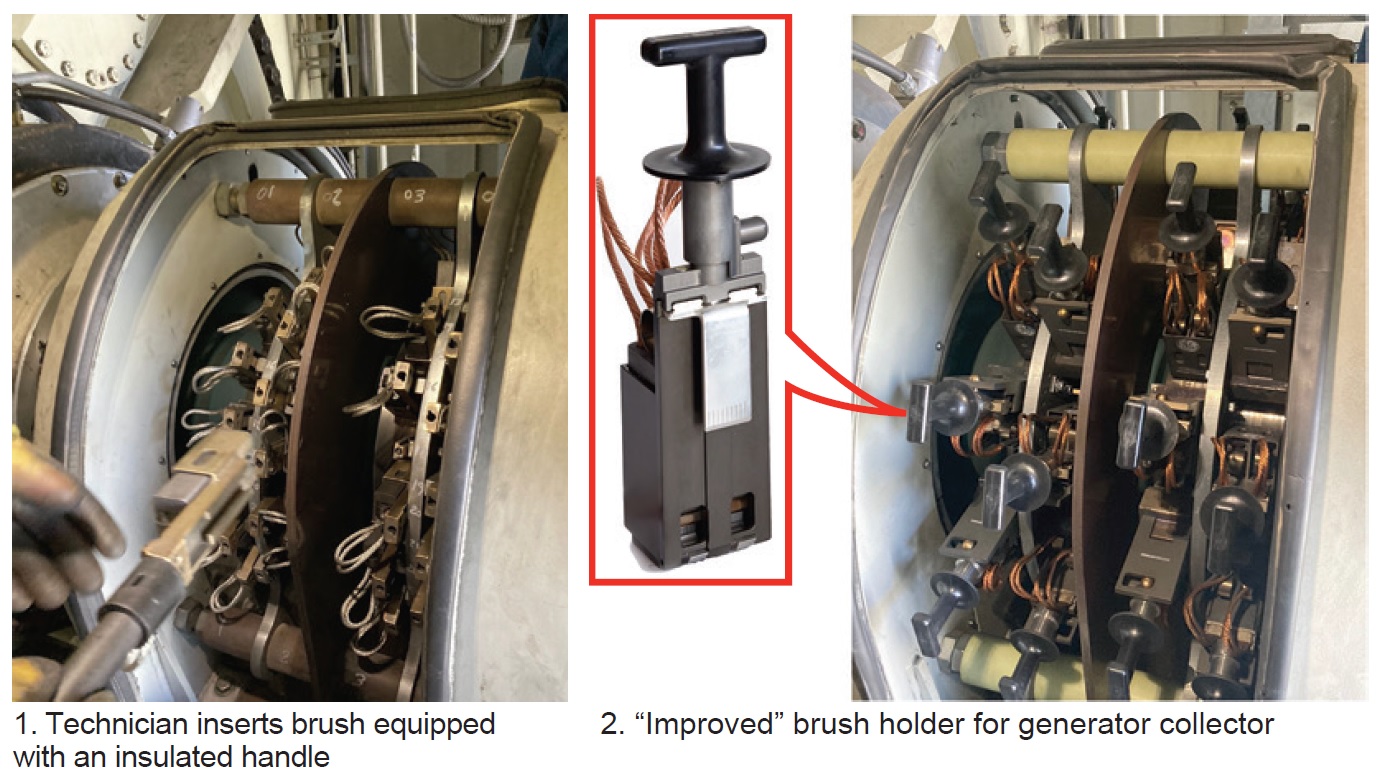

Background. CEP’s four generators are equipped with the OEM’s EX2100e excitation system to control ac voltage at the generator terminals and/or reactive volt-amperes (VAr). Plant’s excitation system has a collector on the free side of the generator, where carbon brushes transfer the excitation current to the rotating slip rings and produce an electromagnetic field in the generator.
Incident. During normal monthly preventive maintenance, the following occurred when changing a brush on the negative pole: Technician inserted the brush holder, using its insulated handle (Fig 1), unaware that the carbon brush had slid out and been pushed to the middle space between the collector rings. The resulting electric arc damaged the rings and generator rotor.
Solution. After the event, the maintenance and technical control team conducted a root cause analysis (RCA) and investigated collector-brush-system replacement options. GE’s “improved” brush holder (Fig 2) was selected for the following reasons: (1) Reduced the possibility of contact with live brushes, a significant safety benefit; (2) Provided higher reliability by eliminating incomplete insertions; and (3) Assured higher availability by reducing the risk of collector discharges.
Plus, brush wear can be seen easily through the inspection window, or by inspecting the wear indicator on the brush pigtail.

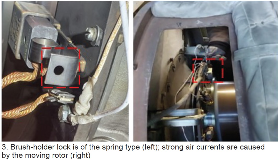

The original grounding-brush system has a spring-type lock (Fig 3 left) that must be pulled and removed to release the brush for replacement or to perform maintenance, which sometimes must be done with the generator in operation (Fig 3 right).
These factors are conducive to an unsafe condition because of the close distance between the operator and the working generator—a noisy environment with strong air currents.

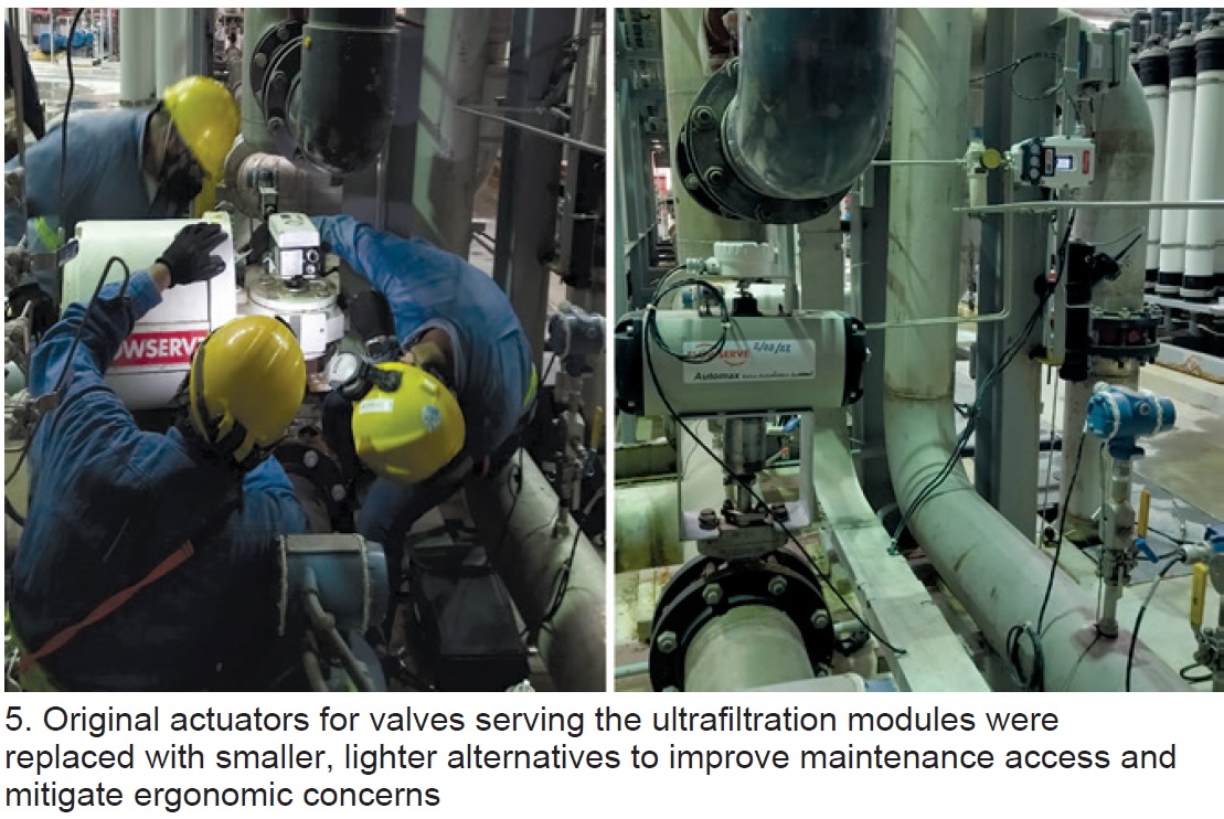

Challenge 1. Reduce or eliminate failures of actuators for valves serving CEP’s five ultrafiltration modules. The original actuators were of a very robust design, each weighing about 200 lb. Thus, their removal for maintenance required cranes and the intervention of specialist personnel from different areas of the plant’s O&M team (Fig 5).
Regular actuator maintenance, typically required every six months because of wear and tear experienced by positioners, instruments, and other components primarily attributed to high vibrations, took about 16 hours. Actuator location complicated maintenance because of ergonomic concerns.
Solution 1 involved replacement of the original actuators with smaller, lighter ones (about 50 lb), thereby improving maintenance access to mitigate ergonomic concerns. Remote positioners were another improvement. Maintenance on the new actuators can be performed in-situ, eliminating the need for cranes and specialist personnel.
