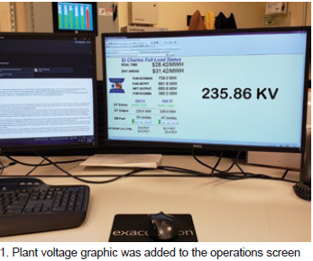

During plant starts after cycling, CROs sometimes noticed voltage spikes that would linger on the high side of 238 kV. For a 235-kV voltage schedule, generator output cannot exceed ±4-kV from the set point. The limited information easily accessible to operators was not in keeping with the plant’s proactive safe and efficient culture.
Solution. The “Plant Generator Voltage Schedule per NERC standard VAR-002” guideline was created so all operators would be aware of the NERC requirements regarding the plant’s specific voltage schedule. It includes the information needed by operators to deal with a regulatory exceedance or near miss.
A PowerPoint also was created to explain NERC’s voltage schedule guideline. Operations personnel were required to review this presentation and answer questions afterwards. Any questions raised were answered thoroughly to assure complete understanding.
A plant voltage graphic also was added to the operations screen so all CROs and lead operators could continuously monitor grid pricing and the dispatched generation set point (Fig 1). When the voltage changes ±3 kV, a red light flashes, bringing the voltage schedule to the operator’s attention.
Results. The enhancement, credited to Mario Longmore and Jonathan Bennett, has proven very helpful. Also, operators are less stressed knowing they have the tools to respond to a regulatory episode in the unlikely event one occurs. Finally, the work described further reflects the culture of St. Charles and the continuous efforts made by staff to make proactivity and forward thinking a priority among all employees.
