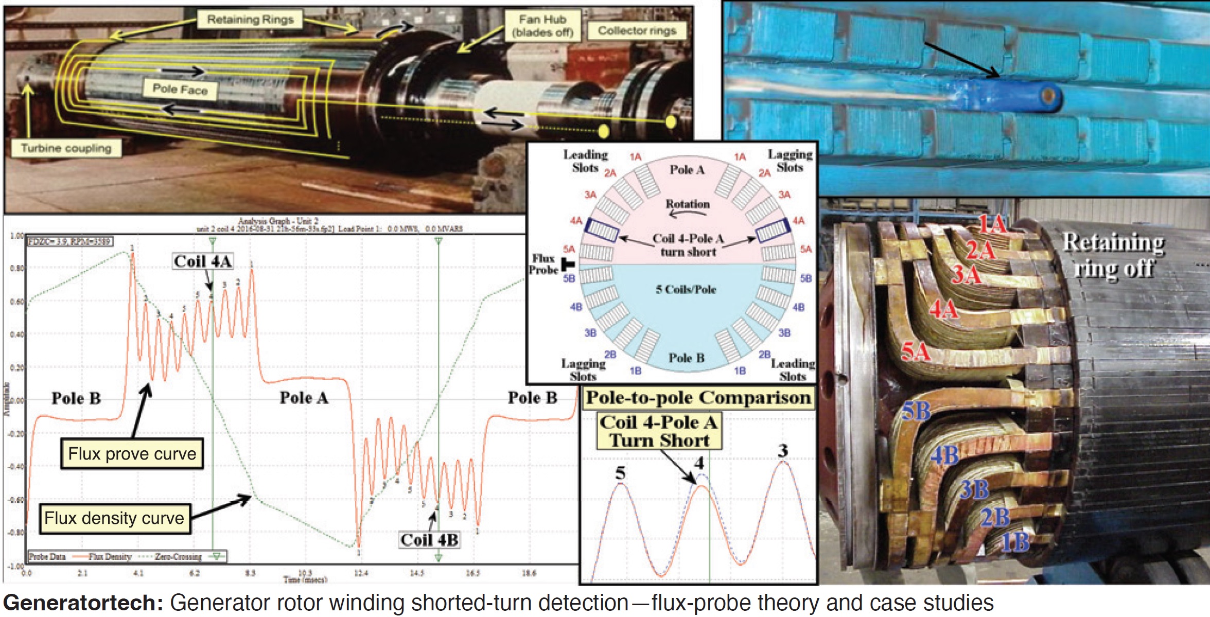

Generator rotor winding shorted-turn detection: Flux-probe theory and case studies
David Albright’s conclusions suggest what you can expect to learn from his presentation. They are:
  • Shorted turns in field windings occur frequently. While not a big issue in many cases, they can be a serious and expensive problem.
  • Online testing is critical because offline tests will miss speed- and temperature-dependent turn shorts.
  • Testing over a full range of loads is critical to identify all true turn shorts and eliminate all false turn shorts.
  • Installing flux probes during outages can save time and money on future generator maintenance decisions.
Albright explains turn-to-turn (and coil-to-coil) shorts with good illustrations and provides photos of typical damage. Beware the vicious cycle of turn short development, he warns, explaining that each turn short creates higher temperatures that increase the likelihood of new turn-short development, possibly leading to rapid insulation degradation. Example given: Rapid degradation of a rotor winding for a 680-MW generator caused an increase in turn shorts from two to 10 in 18 months. Several two-pole rotor case studies enhance the learning experience.
