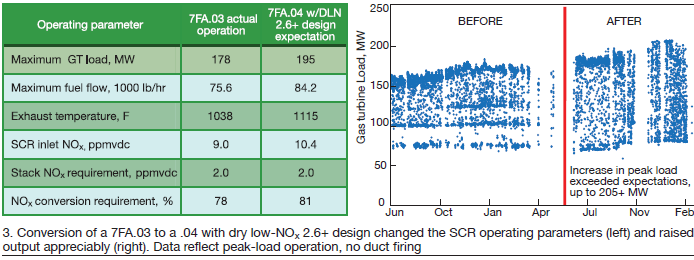

Toback’s second example is a 7FA.03 to 7FA.04 + DLN 2.6+ upgrade (Fig 3). The good news is that the megawatt output gain was higher than expected, another reason why actual measurements are important. However, peak-load fuel and exhaust flows increased accordingly, the turbine exit NOx levels did not change appreciably, but the SCR temperature increased by about 20 deg F after the upgrade.
The original Dot 03-machine catalyst design life projection was about 21 years. The upgrade design expectation reduced it to around 13 years. Based on the actual operating data, however, the catalyst life should be more like 18 years (Fig 4). Both an expected increase in engine NOx from 9 to 10.4 ppm and higher exhaust flows impair catalyst life, but because the actual operating data showed no change in gas-turbine NOx levels, the minimum catalyst-activity requirement did not increase as much as anticipated.
