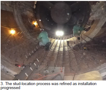

After demolition, crews supervised by HRST installed the bottom half of the liner first. Because the scallop bars had been eliminated, studs were welded to the casing one at a time in a density for heavy duty service (Fig 3).
Then, with the lower half complete, scaffolding was erected on the new liners and upper-half work began, first the studs, then the insulation, and finally the liner panels and corner angle.

“At the first Iowa unit we put the studs in one at a time. But in Wisconsin we decided to put these on a bar fabricated previously at a shop. The bars are however long they need to be, based on the geometry. The weld point in the field then becomes bar plate-to-casing.”
He continues: “The studs upstream to downstream are evenly spaced, but the distance in the lateral position upstream to downstream can be different stud-to-stud (perhaps a sixteenth of an inch). And the liner sheets reflect that. We pre-design and pre-make the liner sheets and stud bars, and the vast majority don’t need any trimming. There is just some custom fitting.”

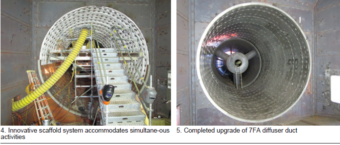

Ya’ gotta’ listen. “A lot of the details become even more clear with experience,” reflects Miller “And at our most recent site we had a 28-year-old foreman, sharp as a tack, who wanted to show the world we could do this more efficiently.” The result was an innovative scaffold system that allowed multiple, simultaneous activities (Figs 4, 5).
“They put some outriggers on the interior side of the duct,” explains Miller, “and they outfitted it so we could work on the top and the bottom at the same time. This was huge!”
“It’s like a suspended scaffold,” noted the owner/operator. “You can work top and bottom at the same time, and there’s room to get more people in there than you would think.” States Miller, “Each job is contractor-dependent, and you need to listen to everyone’s ideas.”
