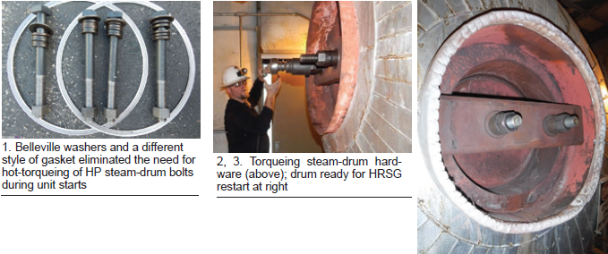

Dogwood worked with an engineering firm that was in the process of developing a solution using Belleville washers and a different style of gasket to eliminate the need for hot torqueing (Fig 1). Dogwood removed the existing studs and washers and replaced them with longer studs to accommodate the Belleville washers.
In addition, the engineering firm recommended use of a graphite ring gasket that does not liberate like the spiral-wound gaskets typically selected for drum doors. This design relies on the spring pressure of the Belleville washers to hold the gasket sealing surface tight as drums go from atmospheric to normal operating conditions (Figs 2 and 3). Note that the gasket has a spring-wave feature that allows it to accommodate thermal growth.
Dogwood Energy’s HP drums have round manways, not the elliptical ones found on most steam drums. Personnel confirmed that the recommended gasket was flexible enough to install through the drum door opening without distorting or damaging it.
Dogwood offered to be the beta test site for the Belleville washer and gasket arrangement in an effort to validate the engineered solution on its HP drums. The new assembly was installed on one of the HP drums during the fall 2017 outage and followed a test plan to validate the assembly.
