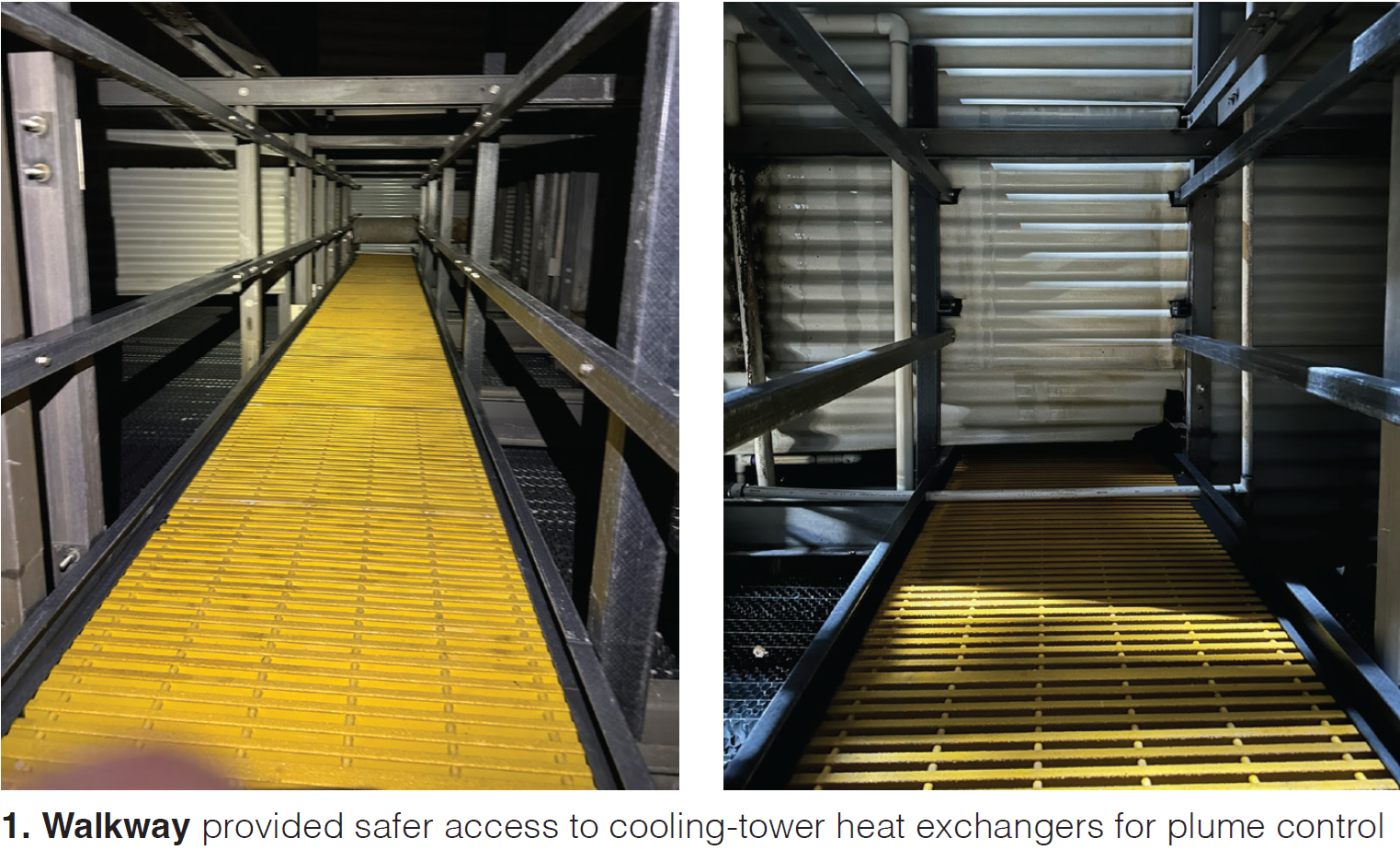

Challenge. Empire Generating’s cooling tower is designed with a dry section that contains heat exchangers to assist in plume abatement. Because of their location, age, and duty cycle these heat exchangers routinely develop leaks that require tubes to be plugged and pipes repaired.
Work on the external side of the heat exchangers (on the outside of the cooling tower) was never an issue, as there are work platforms. However, work on internal side (inside the cooling tower) proved more problematic given the lack of work platforms and the need for fall protection and to work at odd angles off tower structural-support members or scaffolding.
Solution. At the suggestion of plant personnel, the installation of an internal walkway was investigated. As envisioned, it would run the entire internal length of the cooling tower, like the existing external walkways. But to accomplish this it would be necessary to modify the internal structure of the tower, cutting “doors” between the sections, thereby reducing each section’s effectiveness.
This was not viewed as an acceptable solution. Instead, the design was modified such that internal cooling-cell integrity would be maintained and the walkway would only provide access to two cells from one ladder entry point (similar to access before the walkway was installed).
Results. The walkway was installed by Cooling Tower Depot during Empire’s 2023 fall outage (Fig 1). With improved access, Empire employees can work more comfortably on the internal side of the heat exchangers, without worrying about falling or being at odd angles and trying to hang onto slippery support cross members.

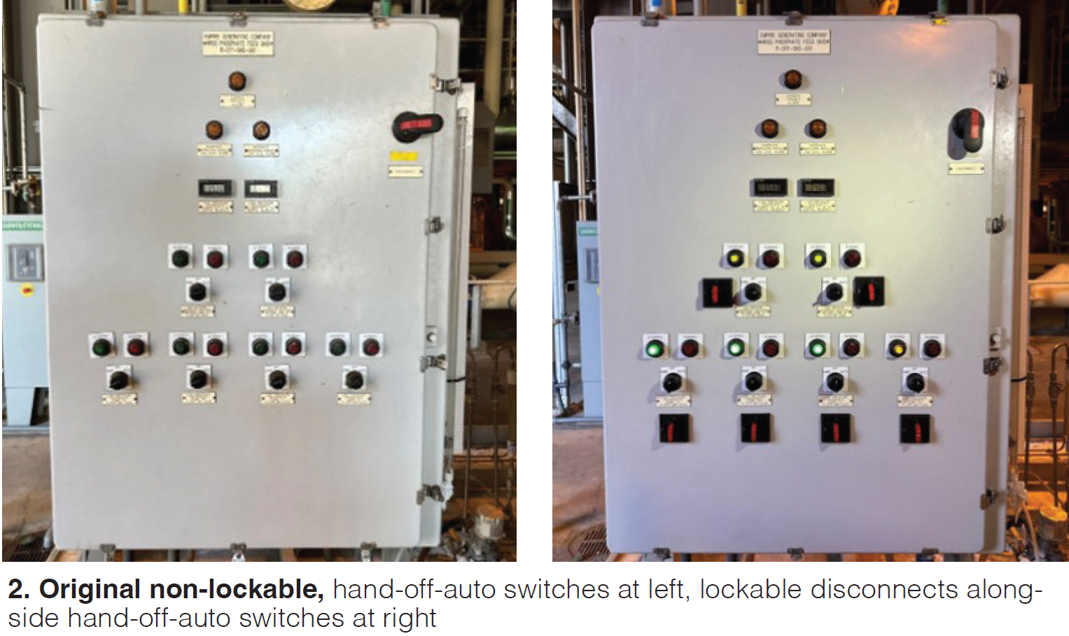

Challenge. Empire has several types of chemical-pump skids that vary in pump type, size, and power requirements. Additionally, some skids are powered by multiple sources from their local power distribution panel (PDC).
As some of the older pumps hit their lifespans and required replacement/repair, staff recognized an issue that also was an opportunity. When performing LOTO on a single failed pump on the phosphate-feed-pump skid, which has four 120-V single-phase and two 480-V 3-phase power sources, techs found that each of the individual pumps fed from the PDC could be isolated only by pulling fuses after hanging a LOTO on the entire PDC. This meant taking all the associated pumps out of service.
Thus, to work on a single chemical pump without interrupting normal plant operations, multiple LOTOs had to be hung for an IC&E tech to open the associated PDC and remove and reinstall the applicable fuses.
Solution. After some deliberation at a management-of-change meeting, staff determined a better solution for servicing the phosphate feed pumps. Rather than having to use multiple LOTOs to remove and reinstall fuses, Empire management approved installation of individual, lockable, door-mounted disconnects for each pump within the PDC (Fig 2). This would eliminate the need for an IC&E tech to open the panel and pull fuses and shut down power to the whole system.
The individual disconnects would enable any qualified Empire employee to LOTO individual pumps on the skid, which also would simplify the LOTO process while the phosphate system is in use.
Results. The design upgrades worked as planned and the modifications ensure a safer, more efficient LOTO and repair process. Given this success, the same upgrades are planned for other chemical-feed-pump PDCs during upcoming outages.
