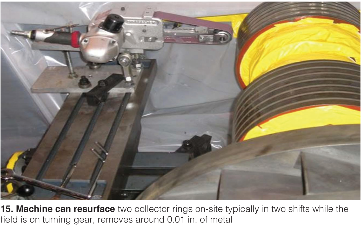

In-place machining of collector radial leads was tackled by an O/O in Texas, slides essentially providing a pictorial of inspection, testing, and replacement of both inboard and outboard leads and associated hardware. Although a prior visual inspection showed no obvious signs of overheating, tracking or distress, the outage plan included replacement, along with H2 seals, which had been responsible for an increase in forced outages within the fleet.

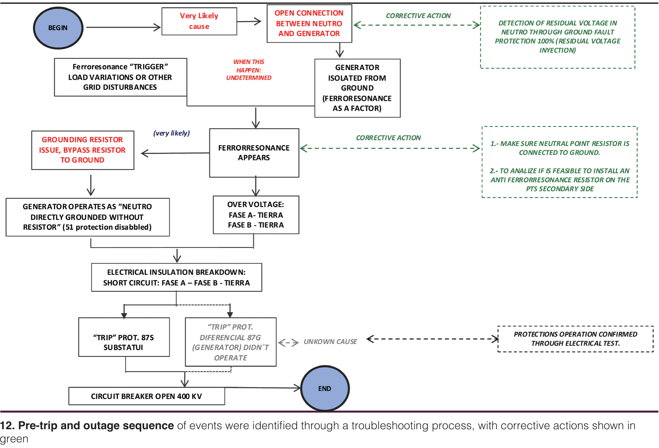

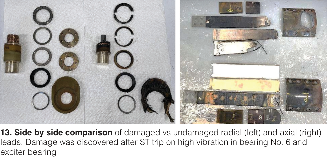

Troubleshooting a generator line-side failure could have been named, according to the Italian O/O rep who delivered the talk, “how troubleshooting can be complicated if you don’t have enough information.”
  • Summary of the salient lessons learned include:
  • Make sure 100% of the generator is protected against ground faults
  • Verify routine relay protection systems
  • Inspect grounding systems as part of routine maintenance
  • Make sure disturbance registers work properly
  • Check the integrity of resistors located on top of the generator neutral connections
  • Spares are key to prompt return to operations.
The sequence of events (Fig 12) which led to the ST/G trip and subsequent 12-day outage; the associated inspections, troubleshooting logic, findings, and thought processes; and the recovery plan and repair process are all explained in great detail, with very helpful diagrams, in the slides.

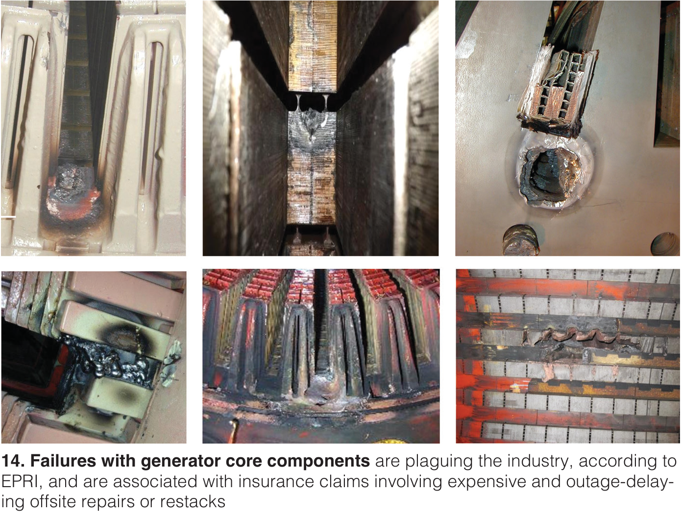

Too many core issues (Fig 14) are affecting our industry, according to an EPRI presentation, and they are “ugly and expensive.” Largest contributors to core failures are lamination, insulation, and deterioration, but stator winding short circuits, oversaturation, and poor repair/rewinding workmanship are significant as well, according to some insurance company data presented.
Balance of slides review data from EPRI studies, evidence from visual inspection, knife checks for core tightness, core-bolt torque check, stator core and ELCID testing, step iron testing, core loop high energy test, hot spot infrared thermography, on-line condition monitoring, acoustic monitoring, and leakage flux.

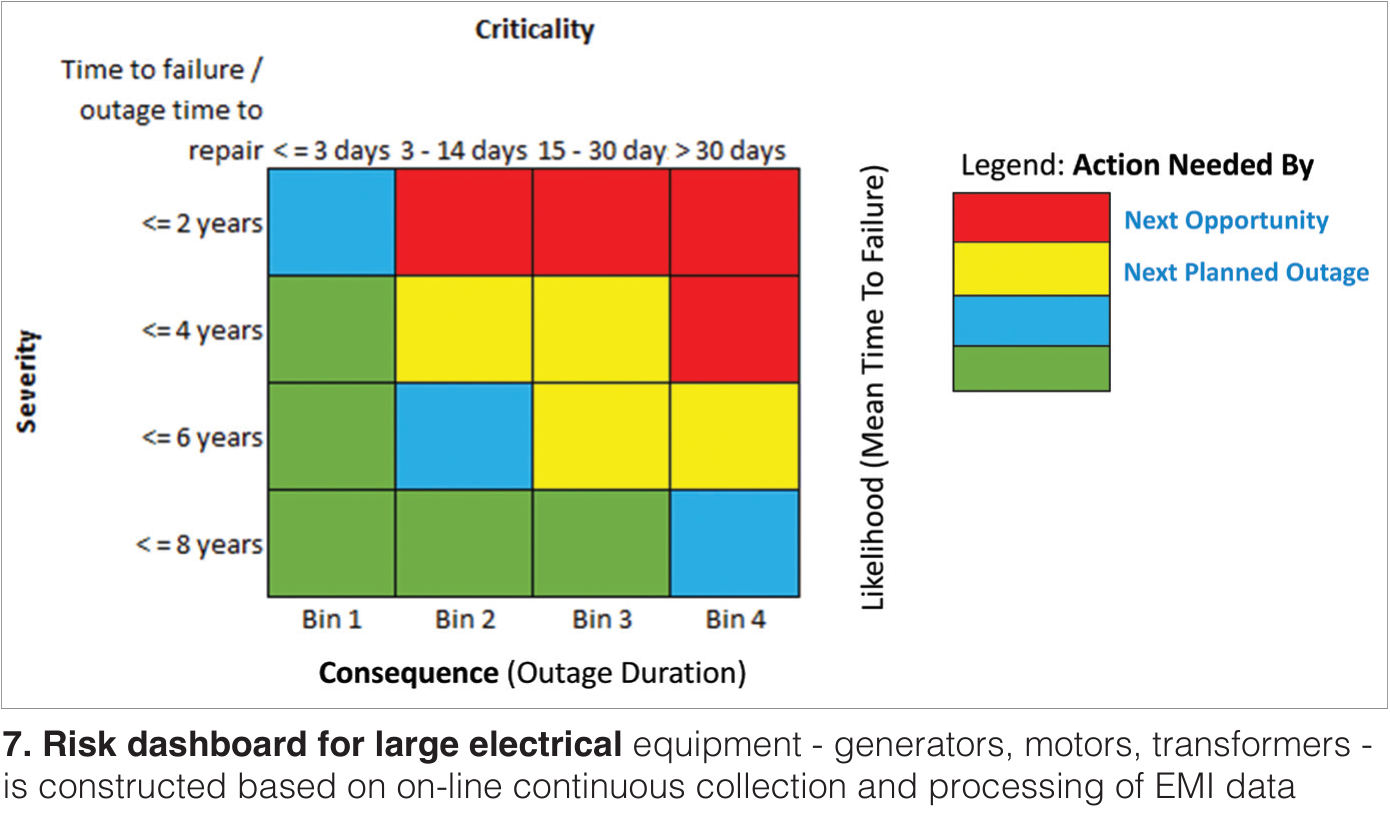

“CPV Valley and Cutsforth: Enhance Technological Advancement with EMI Monitoring Diagnostics,”
Cutsforth
Monitoring electromagnetic interference (EMI) to detect incipient failures in large generators was first proposed in 1979 according to Cutsforth specialists. Over the following four decades, several large utilities progressively applied the concept to monitor generators, motors, transformers, and other large electrical components. Now, a plant in upstate New York is working with Cutsforth to convert ~50 plant-wide EMI detection system outputs into 20 diagnostic severity and urgency indicators and a color-coded production-risk dashboard of potential consequences (e.g., outage duration) paired with a list of troubleshooting steps to inform the outage scope.

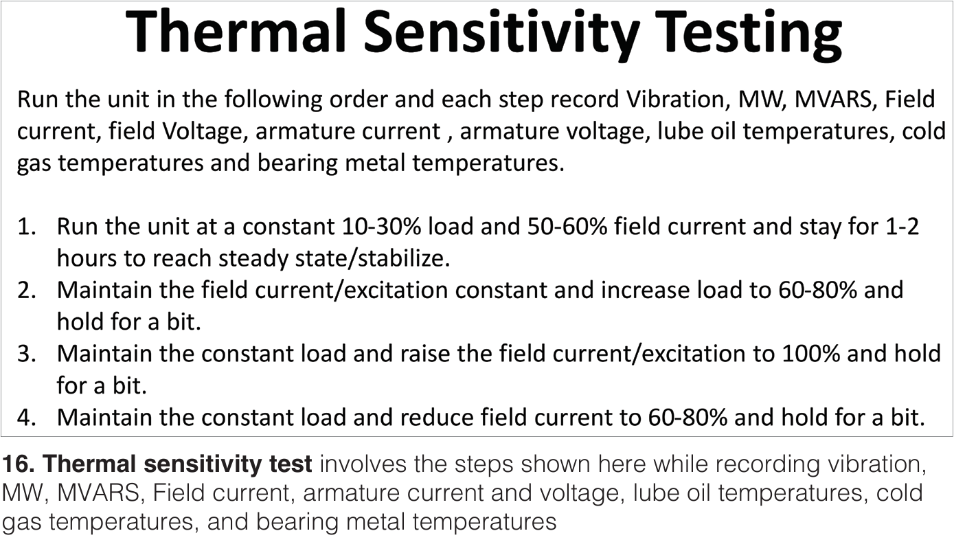

“Thermal Sensitive Generator Rotors: Testing, Causes, and Repairs,”
Roger Kondos, Entrust Solutions Group/TG Advisors
A generator field is deemed “thermally sensitive” when there is a bow in the rotor that changes due to excitation.” Reversible causes include shorted turns, distance block fitting, blocked ventilation, and heat sensitive rotor forging; Irreversible causes are wedge tightness and insulation. Slides offer a testing procedure (Fig 5) and mitigation (essentially limiting load/MVARs output) and repair options. Data, analysis and conclusions from a case study are included.
