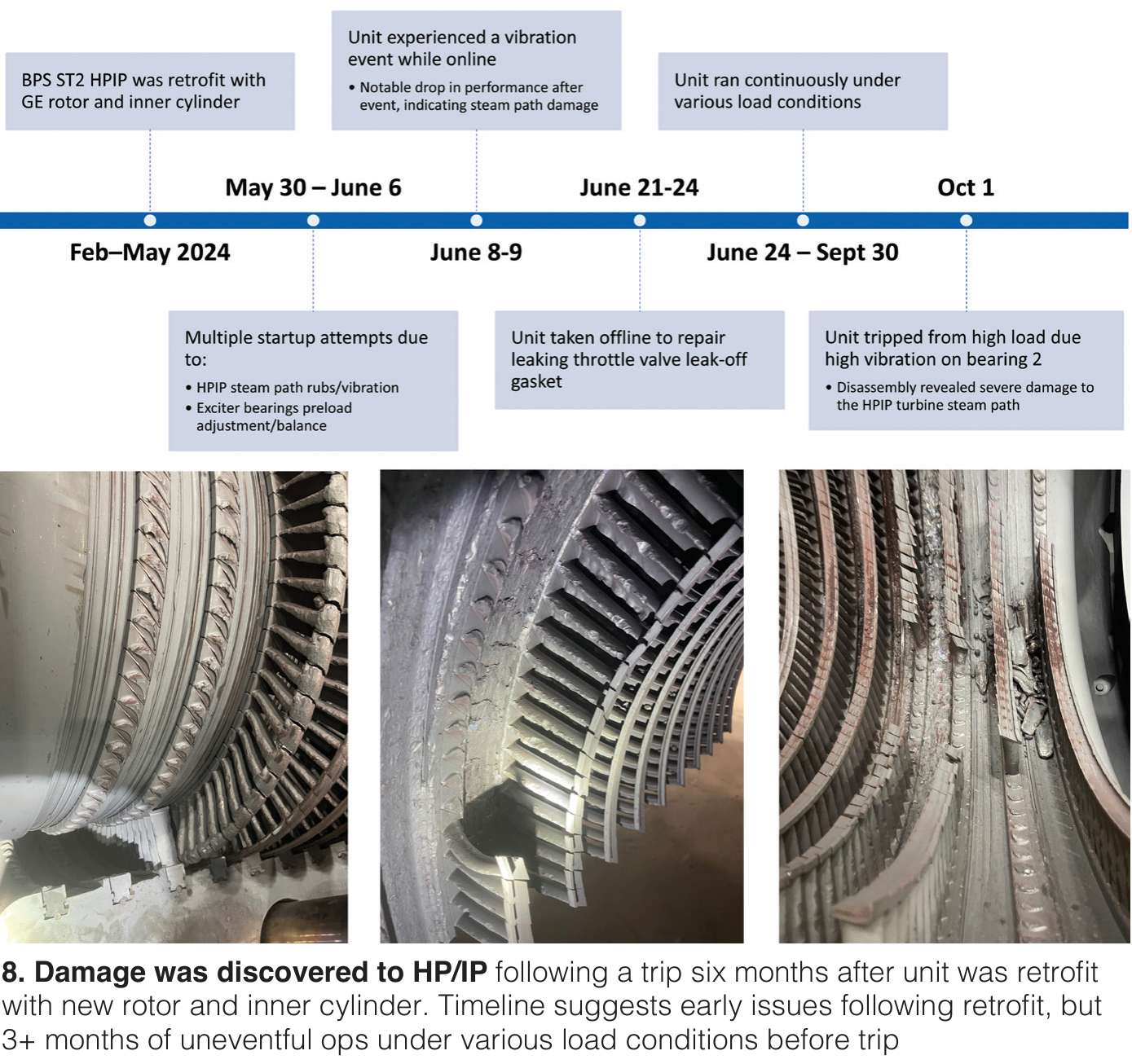

Lessons learned from a steam turbine forced outage is an example of why every owner/operator should have people at these conferences. The HP/IP incident in question involves two and an half rows of rotating blades liberated at the platform, four rows of stationary blading missing 10-60% of airfoils, rubs observed on the lower halves of the HP seals and packing, and a total of 15 rows of rotating and stationary blading needing to be replaced (Fig 8).
The OEM root cause analysis (RCA) is a real mouthful but goes like this: Cold misalignment led to hard rubs during startup which generated excessive heating of the shrouds, leading to loss of pre-twist in the blades because they were more susceptible to the high cycle fatigue by which the blades were liberated. Addressed as part of the remediation plan are the misalignment, seals and clearances, LVDT position errors, insulation, steam blows, and oil flush. Reams of operating data ahead of the failure are also included.
Worth noting is that this ST unit was commissioned in 1957, then repowered with the conversion of the old fossil plant to a 4×1 CC in 2003. More recently, when concerns with rotor bow (run-out), creep/embrittlement, and inner casing cracking surfaced, a new HP/IP rotor and inner cylinder were installed in early 2024. While the failure occurred October 1 of that year, several operating hiccups were noted prior, supported with much operating data ahead of the failure.

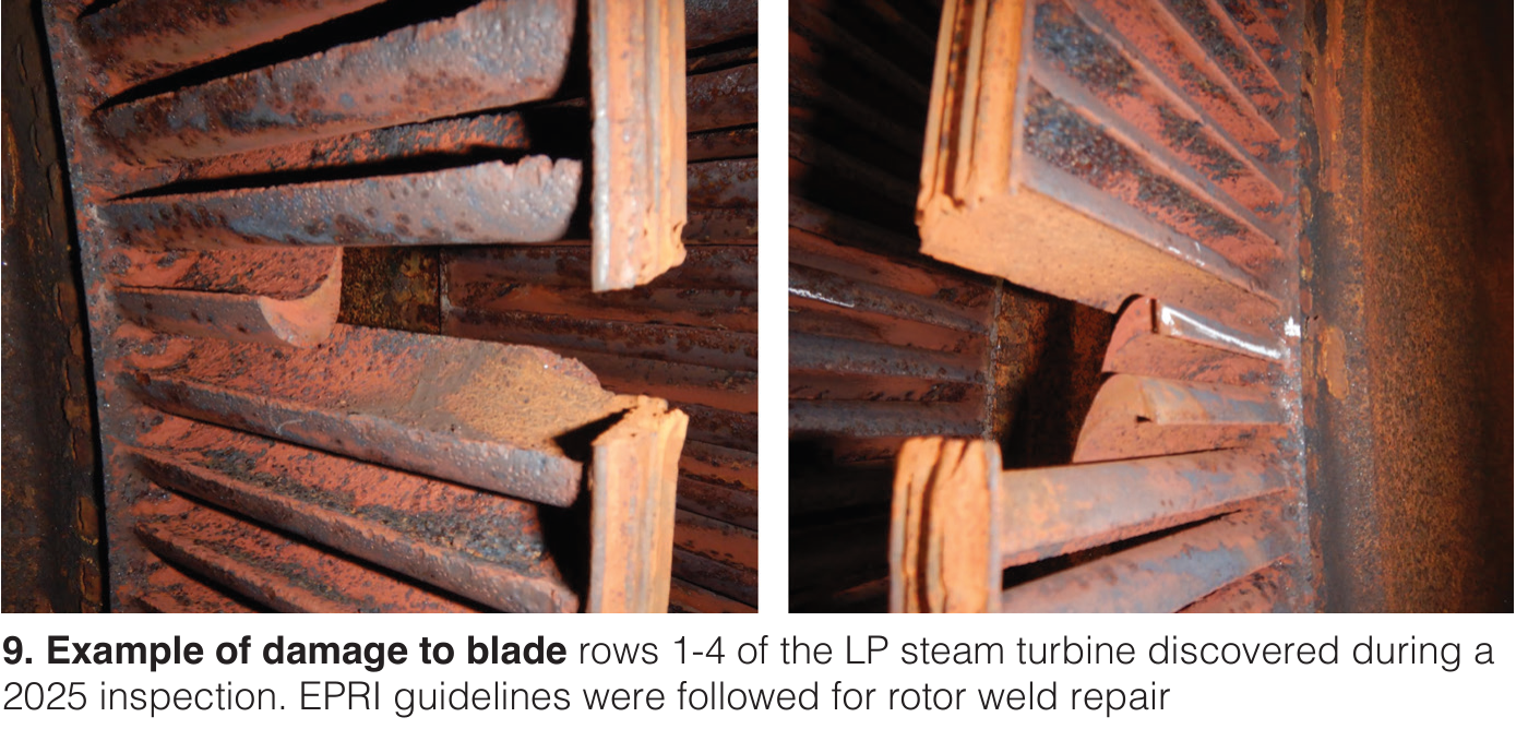

ST rotor crack repair. Speaking of weld repair, ST experts from one of the nation’s largest O/Os reported on a rotor crack repair applying the guidelines in EPRI’s “State-of-the-Art Weld Repair Technology for Rotating Components, Vol 1: Weld Repair of Steam Turbine Discs and Rotors.” The LP ST (part of a 1990-vintage peaking CC unit limited to 10% capacity factor because of environmental restrictions) is described in the slides as an “unusual configuration” requiring “unorthodox lifting.”
During a 2017 inspection to locate the source of air in-leakage, specialists found heavy deposits on rows 1-4. Plant continued to operate (low annual hours) until a vibration trip event in January last year. Upon inspection, significant damage to stages 1-4 was discovered (Fig 9). The blades were replaced. Balance of the slides offer a detailed pictorial with diagrams of rotor repair, including prep, machining, welding, post-weld heat treatment and finishing; blade replacement, high speed balancing at a facility in Houston; and reassembly.

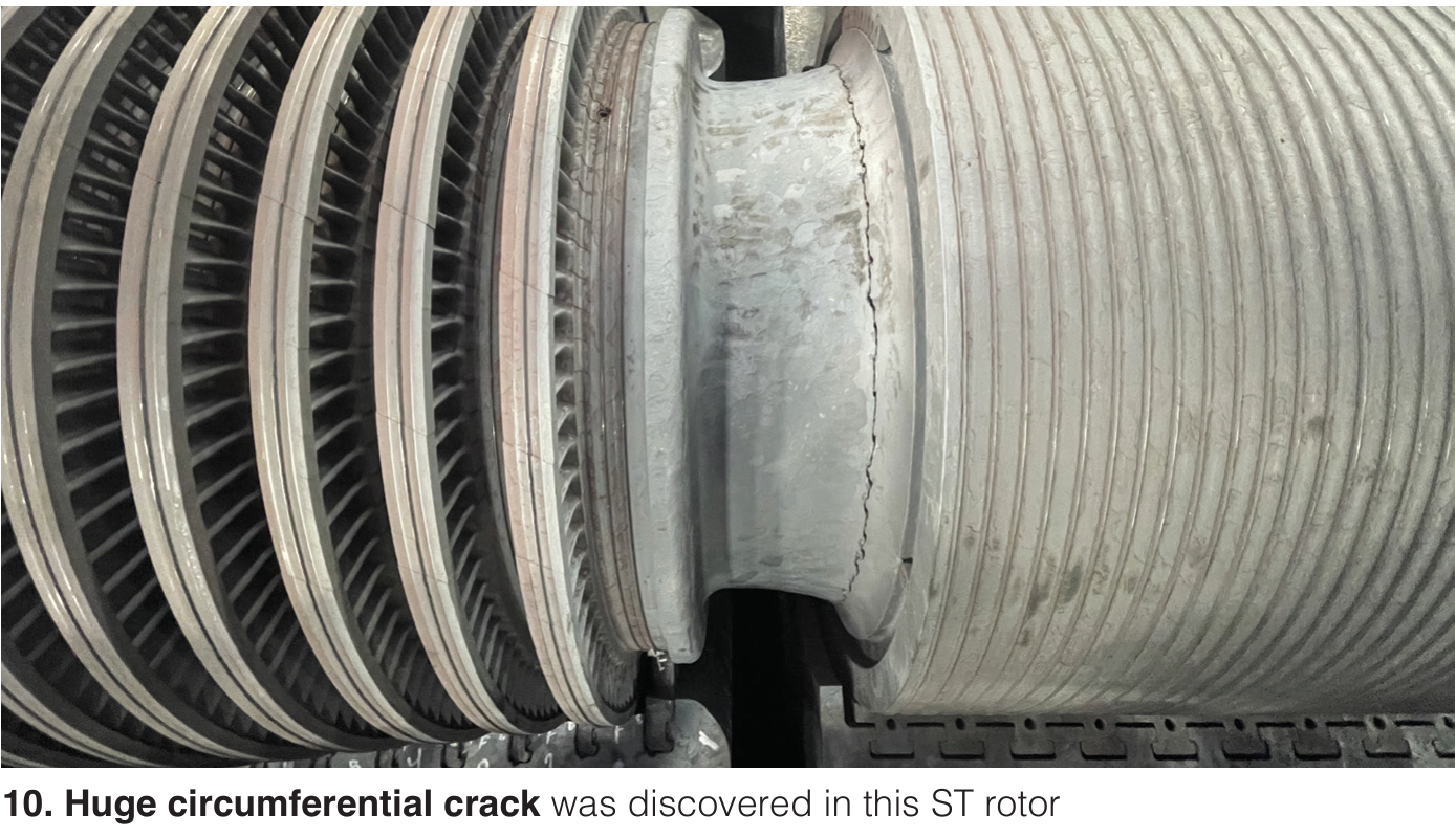

The good, bad, and ugly. You may be unsure of where the “good” is in this slide deck but if you have “wreck on the road” viewing fantasies, this deck features a huge circumferential crack (Fig 10) in an undesignated ST rotor, last stage blade erosion near the platform, missing, liberated, and deformed LP blades, and blades which look like gravel went through them along with the steam. If you have a new green ST engineer on your staff, this might be the slide deck which “puts the fear of god” in him.

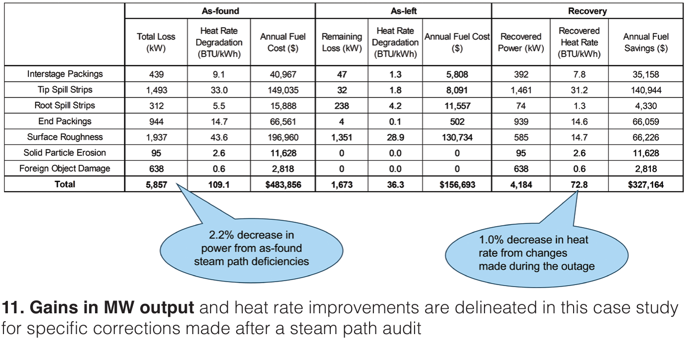

“CC Performance Testing and Steam Path Audit Case Study,”
Jim Miller, MD&A
Improving turbine cycle heat rate not only leads to significant annual cost savings but informed decisions for prioritizing maintenance. As a rule of thumb, a 1% step change in turbine efficiency at valves wide open should cause an investigation. Two primary aspects of a performance improvement program are (1) conduct as accurate an efficiency test as possible before and after the audit, benchmarked to a reliable reference, and (2) inspect the steam path off-line to identify deficiencies and quantify economic impact.
Examples of typical as-found sources of performance loss include seal leakage, solid particle erosion, deposits, foreign object damage, water erosion, changes in blade trailing edge thickness, surface roughness, and flow changes from HP turbine inlet area alterations. Other common issues which surface are damage to first reheat stage, inlet seal ring leakage, and distortion in packing casings and diaphragms. Results from a case study round out the slides, with a breakdown by issue of performance impact and economic benefit/cost ratios (Fig 11).
