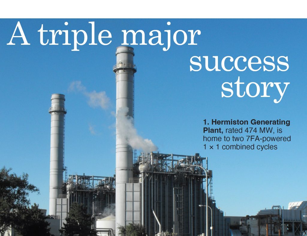

Perennial Power’s 474-MW, two-unit Hermiston Generating Plant in northeastern Oregon (Fig 1) provides power to nearly 500,000 households in the Pacific Northwest. It also sends steam to Lamb-Weston’s adjacent potato processing facility.
Both Hermiston units feature identical gas turbine/generators and steam turbine/generators, all commissioned in 1996. The plant has been recognized by the Oregon Occupational Safety and Health Division in the past for its exceptional health and safety record and to date has never experienced a lost-time injury.

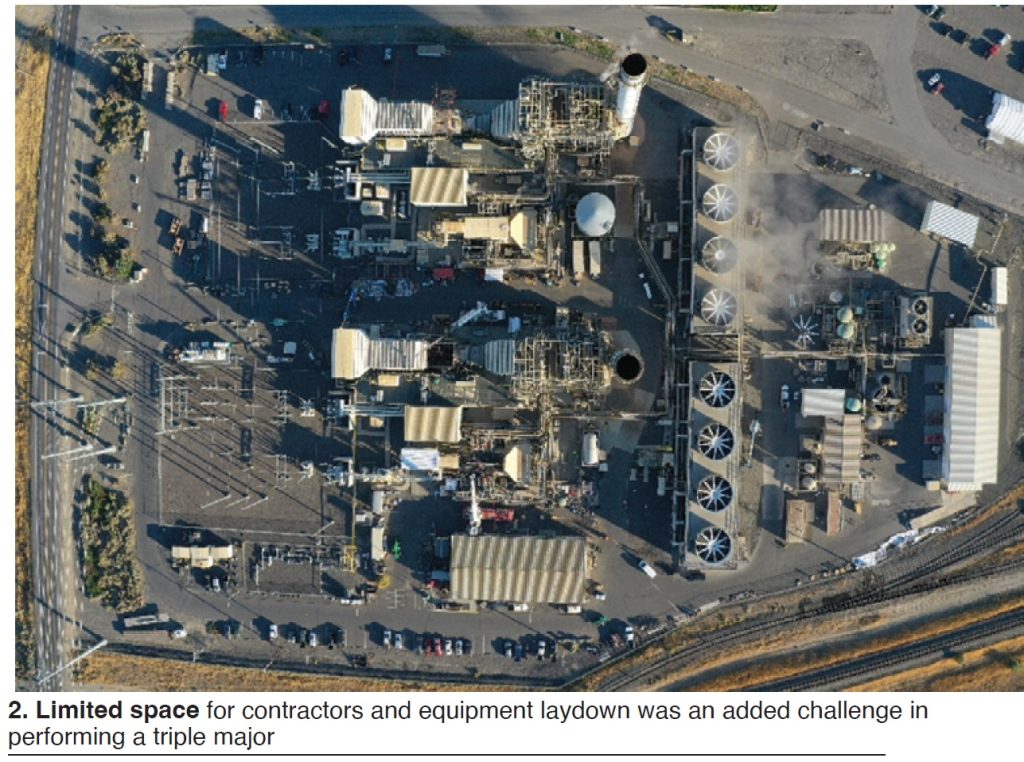

He continues: “With nearly two-dozen contractors onsite and within limited space (Fig 2), communicating and coordinating contractor milestone schedules and needs become crucial (competing for space, LOTO timing, equipment testing, safety concerns, etc).
“Our plant has found that by having multiple internal pre-outage meetings combined with specific responsibilities and work-order and contractor assignments, you make sure that no single person is overloaded. At Hermiston everyone shares those responsibilities, both salaried and non-salaried. Our internal meetings and reporting start several months before the outage. Meetings with contractors are also held onsite or virtually as often as needed.”
“It starts with the plant,” states Daniel. “I feel it is the site’s responsibility to build the dialogue, the trust, and the open communication to bring up any and all questions and make it a streamlined and safety-conscious outage.
“The result,” as he explains, “is that once you get rolling into the outage, you have the relationships, you know who you need to talk to, you have people that you are comfortable with
and have faith in so you can walk through the issues, get them resolved quickly, and keep everyone involved and moving ahead.”

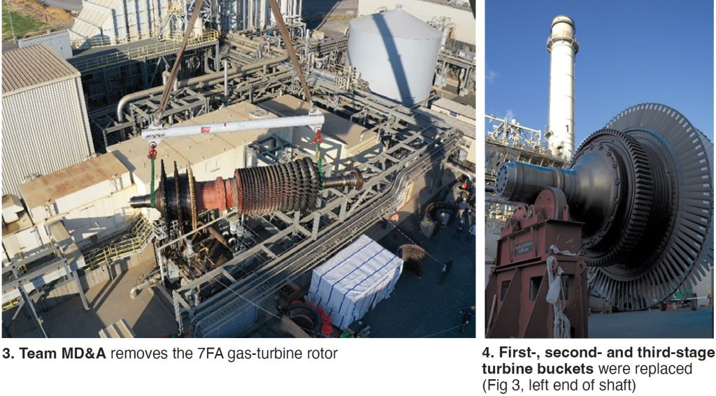

MD&A mobilized and completed the disassembly process utilizing a two-shift operation (Fig 3). Detailed visual inspections began, coupled with detailed NDE, followed by the recommended refurbishments.
In the turbine section, first-, second- and third-stage buckets were replaced (Fig 4) due to rubbing wear and loss of the thermal barrier coating (TBC).
First-, second- and third-stage nozzles also were replaced because of foreign object damage, evidence of cracking, and coating loss. Inspections and similar indications revealed the need to also replace the shrouds.
In the combustion section, liners and transition pieces were replaced with refurbished sets due to TBC loss. New inner crossfire tubes and retainers were installed because of wear and outer crossfire tube packing was replaced at reinstallation.
Although no abnormal visible wear was found, forward combustion cans and fuel nozzles were replaced with customer-provided refurbished sets. Flow sleeves also showed no wear, but the flow-sleeve piston rings were replaced.
Liner caps were replaced with refurbished ones, and transition-piece bullhorn brackets were found worn and replaced with new.
For the compressor-section inlet guide vanes (IGVs), MD&A replaced gears, rack, inner and outer bushings, and spacers. IGV blades themselves will need to be replaced at the next major inspection.
Rotating and stationary blades showed no damage. R-0 inlet compressor blades were replaced with a refurbished set and shims were added to stages 14, 15, and 16. The casing and rotor showed no need for immediate action, but the discharge casing retention bars were replaced.
The inactive thrust bearing showed heavy scoring and the T-1 and T-2 bearings revealed pitting and scoring, which were subsequently replaced with refurbished bearings. The active thrust bearing was cleared for service.

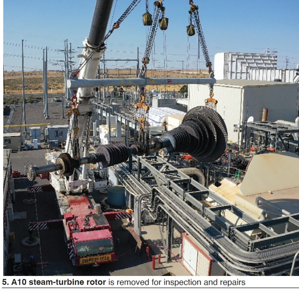

MD&A performed a major inspection and overhaul of the 81-MW A10 steam turbine (Fig 5) and its generator stator and field—all installed in 1996. The main steam valves also were removed by MD&A and sent to the company’s St. Louis facility for inspection and repairs (Fig 6).
MD&A specialists performed a complete steam-path structural audit of the A10 machine. Although many minor diaphragm indications could have been repaired by MD&A onsite, ILP diaphragms 9, 10, 11, and 13 were shipped to MD&A’s facility for major repairs. Stages 10 and 11 also had inserts installed on the steam-seal face because of dishing.
HP and ILP rotors remained coupled and were removed for sandblasting and NDE. Minor bucket repairs were performed onsite to correct impact damage and moderate solid particle erosion.
On reassembly, MD&A performed a Topless Laser Alignment® and its On-Site Seal Services fit and installed new diaphragm and gland-steam packing.

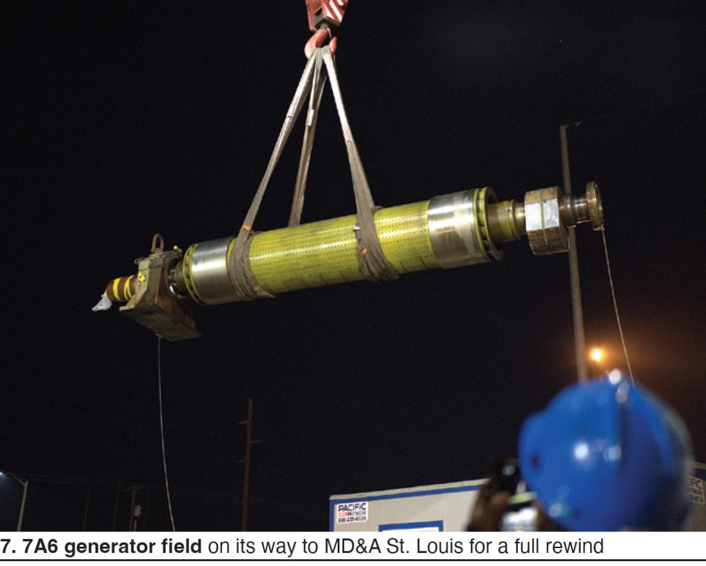

The 7A6 air-cooled generator was disassembled and its field removed and shipped to MD&A’s St. Louis facility for a full rewind (Fig 7). In addition, the company’s Generator Div mobilized onsite to perform a full stator rewind.

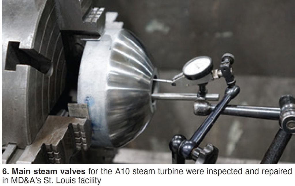

The combined HP stop and control valve was disassembled and the cores shipped to St. Louis for inspection and repair. The Steam Turbine Repairs Div also received two reheat stop valves and two intercept-valve cores for inspection and repair.

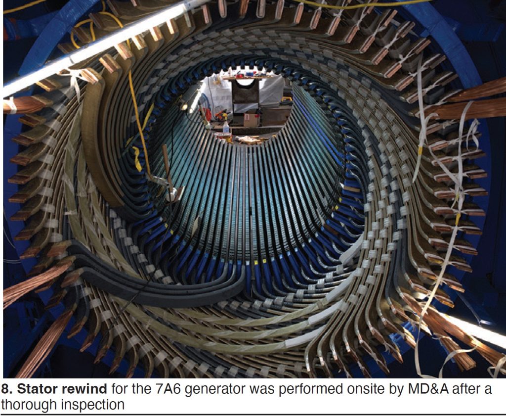

Stator. Concurrent with the steam-turbine major inspection, an elevated workspace was constructed onsite to support the generator division in stator disassembly and reassembly work. A baseline ELCID was performed to determine integrity of the current stator core iron. No shorted laminations were noted.
The wedge system was removed, then the flex probe was carefully set aside for reassembly.
With wedges and series loop connections removed, bar removal began. Inner axial supports were left in place and prepared for the reassembly. Connection pieces were cleaned for reuse.
The stator was thoroughly cleaned to remove any contaminants from the wedge/bar removal process. A post wedge/bar removal ELCID indicated no core-iron damage during wedge and bar removal.
Each core slot was cleaned, and a detailed inspection of any abnormalities was conducted. The core compression flange and all exposed areas where the endwindings sit were painted with an epoxy paint for a uniform color on the compression flange.
After thorough cleaning, the rewind began (Fig 8).
Bar boxes were moved to the scaffolding deck with an innovative safety-conscious method of disassembling the scaffolding roof and flying the boxes to the deck with a crane following completion of a detailed lift plan.
Each of the six circuit rings were acceptance-tested, and the outside binding bands installed.
A tapered gauge from the bar manufacturer was used to ensure concentricity was achieved on the four binding bands. Concentricity of each band is a vital step that will properly align each bar and subsequentially the endwinding basket once the rewind is completed.
Two top and two bottom bars were installed to ensure alignment. Bars were fit into a shoe on the collector end and carefully transferred through the bore to the turbine end. All 72 bottom bars were installed, blocked and tied. All 72 top bars were then installed, blocked and tied, along with 12 new resistance temperature detectors (RTDs).
After all bottom bars were installed, a Hipot test was performed to ensure there was no bar armor insulation damage. Another Hipot was performed on all top and bottom bars at the completion of top-bar installation.
Wedges were then installed, and filler was adjusted at each wedge for proper radial compressive force. Axial locking pins were installed, followed by a final ELCID and brazing. The existing circuit-ring copper connection pieces were re-used and brazed to respective top- and bottom-phase connections.
Upon completion of all rewind activities, final electrical testing consisted of winding copper resistance, insulation resistance, and a final Hipot of each respective phase. Each phase produced satisfactory resistance values.
The stator rewind activities progressed as expected throughout this project. The consistent bar shapes and robust bar design aided in completing the project without incident.

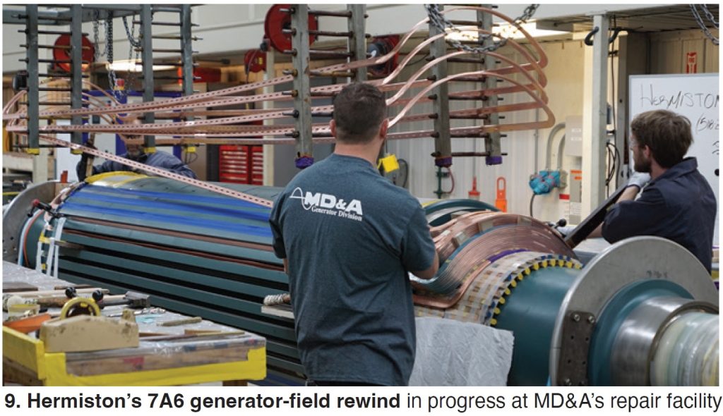

Field. The 7A6 generator field was sent to MD&A in St. Louis for testing, disassembly, coil removal and cleaning, further testing, reassembly, and high-speed balance (Fig 9).
During initial electrical testing of the heavily dished collector rings, collector studs, and bore copper, the collector studs failed high-potential testing. This resulted in the replacement of the collector rings which included removing the old collector rings, manufacture of new collector rings, new collector-ring insulation, and reinsulating of the collector studs.
Coils were removed and sent offsite for cleaning. They were then returned and checked by MD&A. After reinstallation, each coil received ac Hipot and turn-to-turn testing.
Also, during the rewind process, the blocking was upgraded to the MD&A standard block and tie design. Turn insulation was coated, requiring a rotor bake cycle.
Electrical testing, high-speed balance, acceptance testing, and shipping followed.
