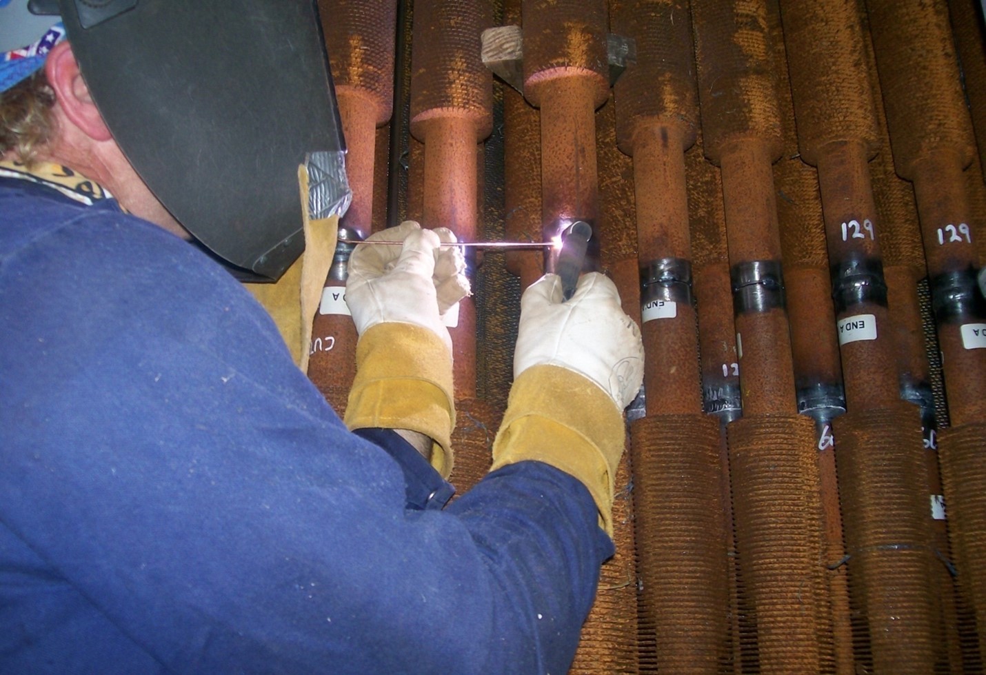

Major maintenance. Any number of factors can lead to a major maintenance issue. These may include anticipated events—for example, catalyst degradation over time—to sudden boiler tube failures from perhaps a water-chemistry upset, metallurgical problem, or fatigue issue. Some of the most common major maintenance items include the following:
  • Boiler tube repair or replacement.
  • Harp or panel replacement.
  • Catalyst replacement.
  • Duct-burner repair or replacement.
  • Main-steam stop valve replacement.
On rare occasions, replacement of a failed boiler tube might not be severely compromising if the failure occurs in an outer tube with easy access. However, from a statistical standpoint, failures most often occur in tubes buried within a harp or bundle. Such locations are very difficult to reach without extracting other tubes.
Potential tube failures emphasize the importance of operating the HRSG within proper ramp-rate guidelines, and in maintaining recommended chemistry at all times, acknowledging that unit cycling can make these tasks difficult at times. CCJ has reported on HRSG chemistry for many years, so this information is readily available in the publication’s archives as well as from other sources—such as the Electric Power Research Institute (EPRI) and the International Association for the Properties of Water and Steam (IAPWS).
A full-harp replacement represents a major maintenance task that is costly, requires a precisely engineered component and field welding according to the ASME Boiler and Pressure Vessel Code. A critical point to remember: Often, upset conditions which caused an initial tube failure, have also damaged other tubes, making harp replacement the most practical option.
Catalyst replacement is a major maintenance issue, too, but if catalyst degradation is simply attributed to normal operation, then planning for catalyst change-out should be straightforward.  By contrast, steam-stop-valve replacement represents a major undertaking that requires careful planning. Replacement of large pressure components is not easy.
