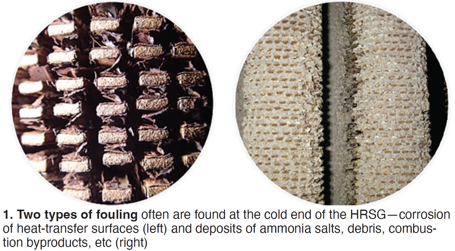

User challenges. On the gas side of finned tubes, two types of fouling often are observed in the cold end of the HRSG: corrosion and deposits (Fig 1).
Corrosion occurs when water and carbon steel interact, causing oxidation. Spallation of the material on the tubes (rust) leads to reduced surface area, impacting HRSG heat-transfer efficiency and potentially causing reliability issues (leakages).
Different types of deposits can accumulate on the finned tubes—typically these:
  • Ammonia salts downstream of the SCR.
  • Sulfur deposits if fuel has high sulfur content (natural gas or oil).
  • Debris from insulation damage, upstream damage, or broken equipment.
  • Combustion byproducts from liquid fuel firing (ash and contaminants).

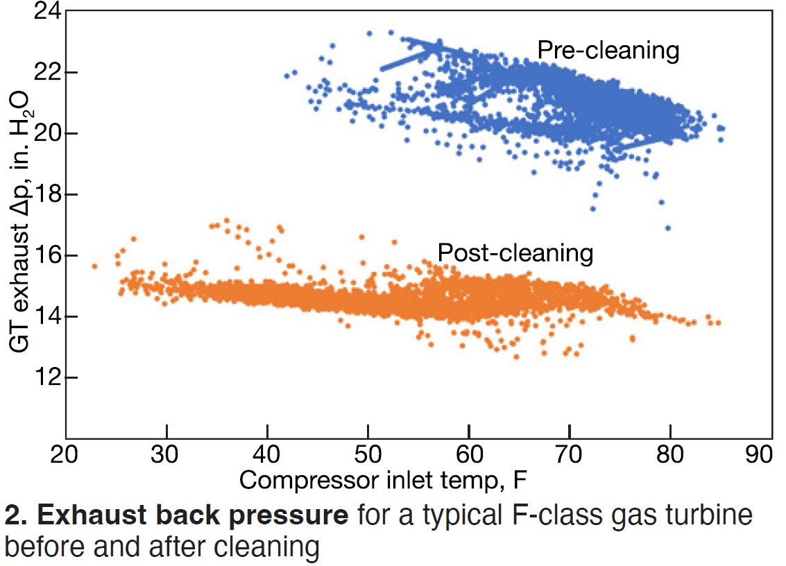

Fouling penalizes combined-cycle performance in two ways:
  1. It increases gas-turbine backpressure (Fig 2). Recall that the HRSG is designed aerodynamically in the gas path. Fouling disrupts this flow, increasing the backpressure and slowing the rotation of the gas turbine. Result: Reduced GT power output and increased fuel costs to maintain the same mass flow at lower efficiency.
  2. It reduces HRSG heat-transfer efficiency, thereby increasing the moisture content of the steam produced and reducing steam-turbine output.

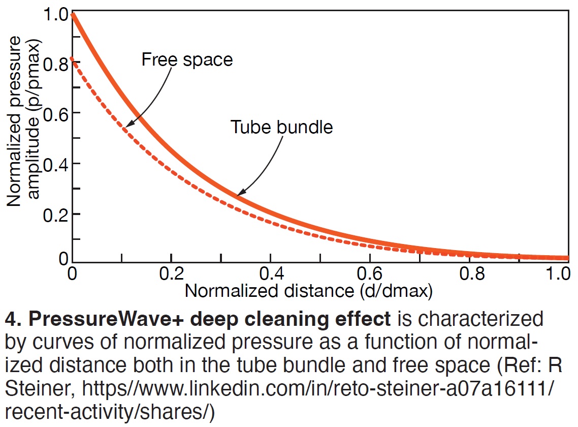

First, effective cleaning deep into the bundles is possible without manual handling or high explosives. User-funded research institutes, Bang&Clean, and GE collaborated on data collection and analysis to define the results observed during outages. Fig 3 shows how the pressure waves interact with the tubing to clean deep into the bundles. This demonstrates the observed cleaning of tubes shielded directly from the PW+ tooling.
When comparing the pressure amplitude in the free space with that in the tube bundle, the amplitude within the bundle is higher. This amplification within the bundles is attributed to the interaction of the pressure wave shock front reflecting both off the tube walls and itself. This integration of waves (mach reflections) allows for removal of the debris that has built up on the back side of the tubing, thus increasing cleaning effectiveness (Fig 4).

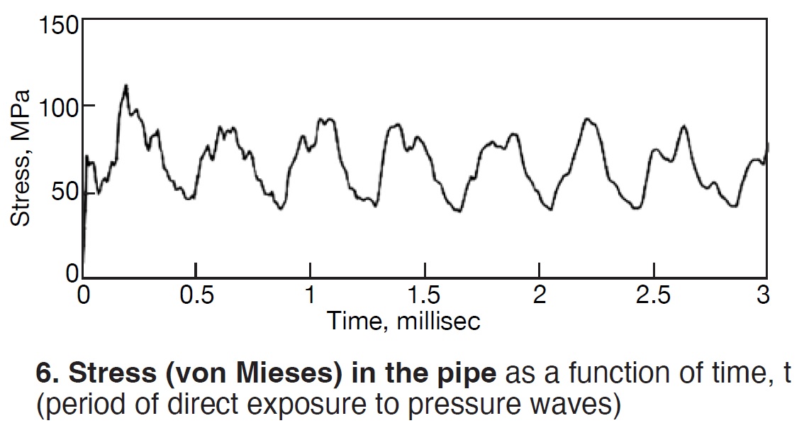

PressureWave+ wave propagation and its strength influence on structures was investigated and validated by simulation (Fig 5). Using existing and new data, numerical stress analyses were completed (Fig 6). The modeling led to this conclusion in the Zurich University of Applied Science review, “In the considered realistic load cases, a permanent deformation due to the detonation can be excluded.”

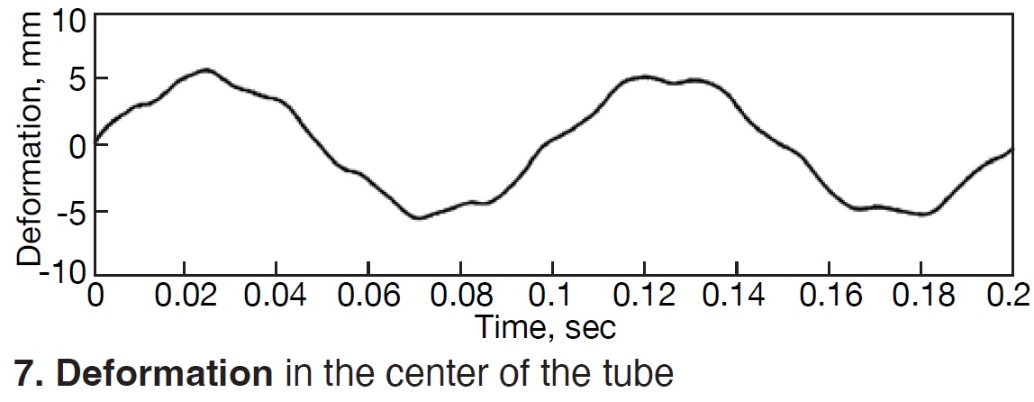

The testing and modeling also detail impact and tube to weld seams experience the greatest stress. This is where the greatest deflection can be observed. It is assumed the resulting harmonic. This harmonic did not result in permanent deformation (Fig 7).
