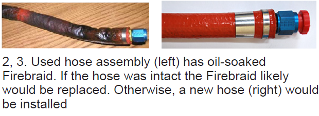

Some hoses are equipped with an exterior (usually orange) protective sleeve—usually called “Firebraid” after the trademarked product. Firebraid Flame Shield is designed to protect hoses, wires, and cables from the hazards of high heat and occasional flame. The silicone coated glass fiber sleeve protects continuously to 500F and will withstand a molten splash at 2200F. Made of knitted fiberglass yarns in a flexible substrate, it is then coated with a high-grade silicone rubber.
If the Firebraid is torn, chaffed, oil-soaked, or otherwise unable to perform its intended task, the hose should be removed from service (Fig 2). Firebraid and banding systems are available commercially as separate pieces. If the damaged protective sleeve is removed and the hose is found in good condition, the Firebraid can be replaced and the hose returned to service. Alternatively, the hose can just be replaced (Fig 3).
