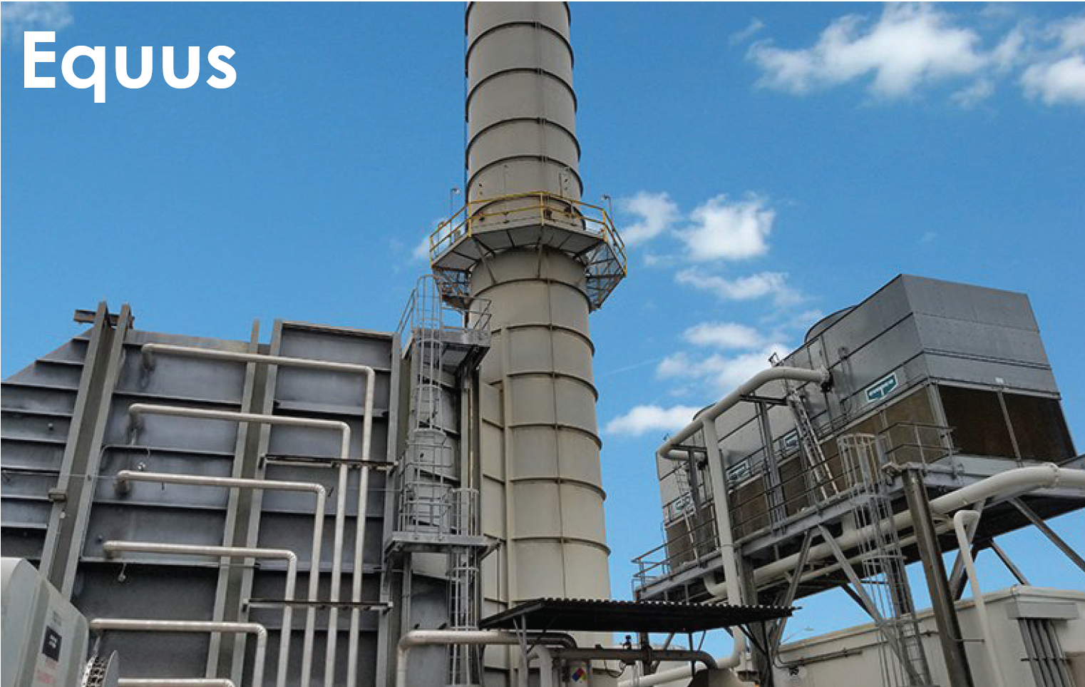

48 MW, dual-fuel 1 × 0 LM6000-powered peaking plant, located in Freeport, NY
Plant manager: Kenneth Ford

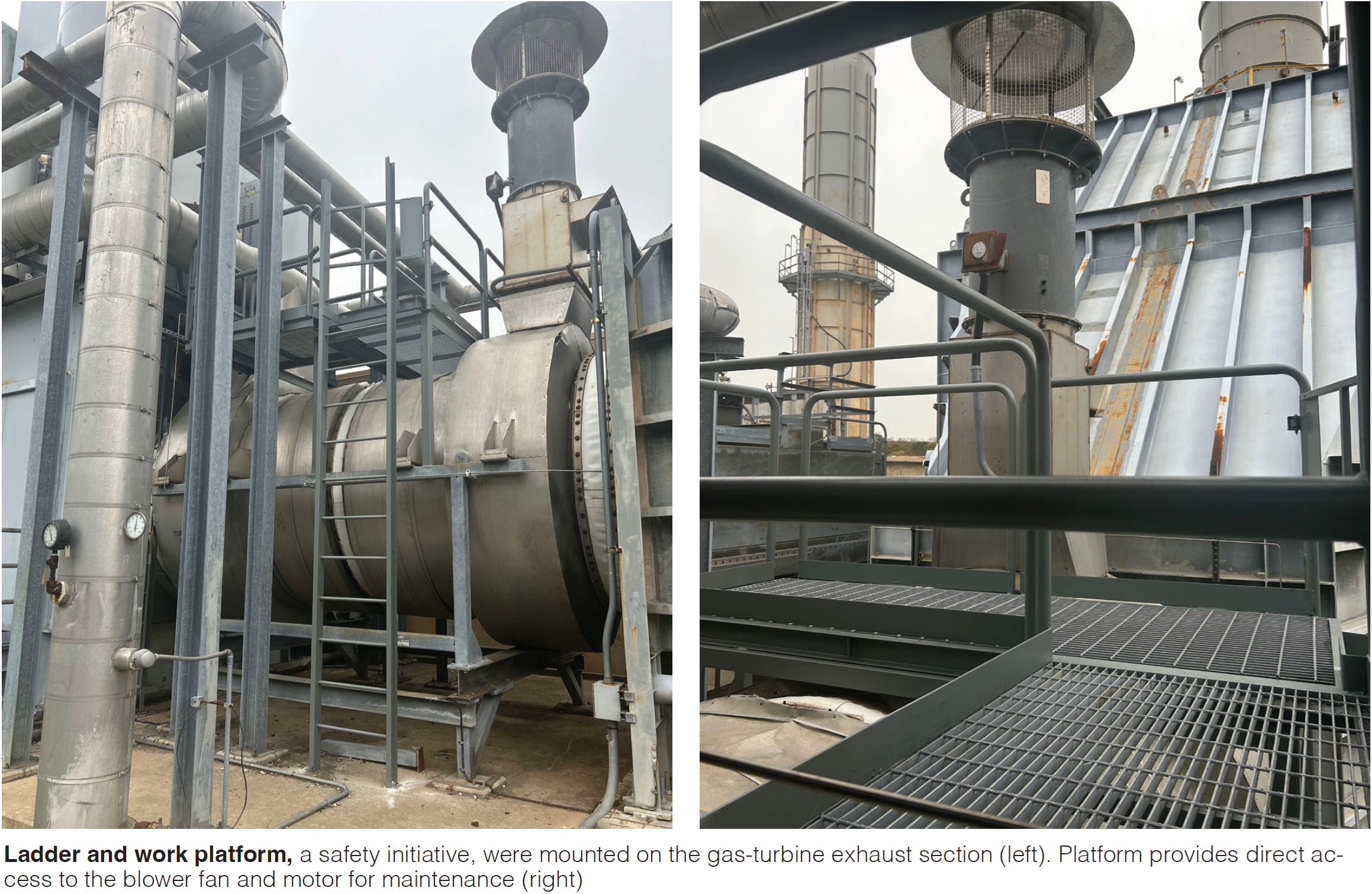

Challenge. Equus’ Higgot-Kane anti-icing system is mounted on the gas turbine exhaust section and relies on exhaust gas to heat air drawn into the machine for combustion. The system relies on a motor-driven blower and mechanical damper, both of which must be maintained. Unfortunately, anti-icing system components are located on the top of the exchanger, approximately 16-20 ft above grade.
Solution. Install a fixed platform with ladder to allow safe access for maintenance and troubleshooting of the motor, blower, and damper.
Results. Plant engaged a local fabricator that has manufactured and installed other fixed ladders and platforms for other J-Power assets on Long Island, NY. It designed, fabricated, and installed a suitable platform to allow safe access to system components.
