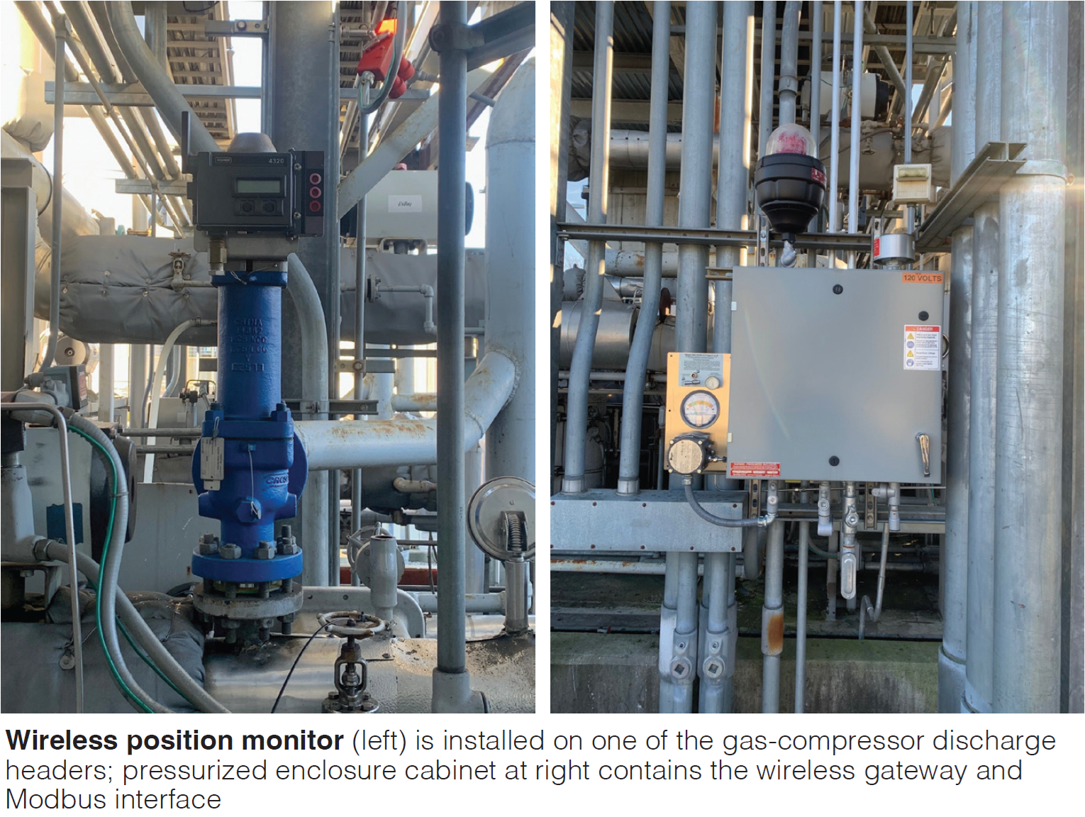

Solution. Management evaluated several options to prevent a recurrence of the event—including acoustic monitoring of downstream relief-valve piping to detect flow, and physical monitoring of relief-valve position. Wired and wireless installation was considered for both options.
Following research that included consultation with potential vendors and other powerplant managers, Edgewood management decided the most suitable option was to install wireless monitors on each of the valves to detect when any one moved from its closed-seat position. Minor modification of the relief valves was required to allow installation of position-detection hardware.
The monitoring devices were installed and connected through a wireless gateway to the GC-skid control system. Finally, system logic was modified to automatically shut down the skid should any of the valve monitoring devices detect a valve not in the closed position. Additional alarms and shutdowns were created to support the effort.
