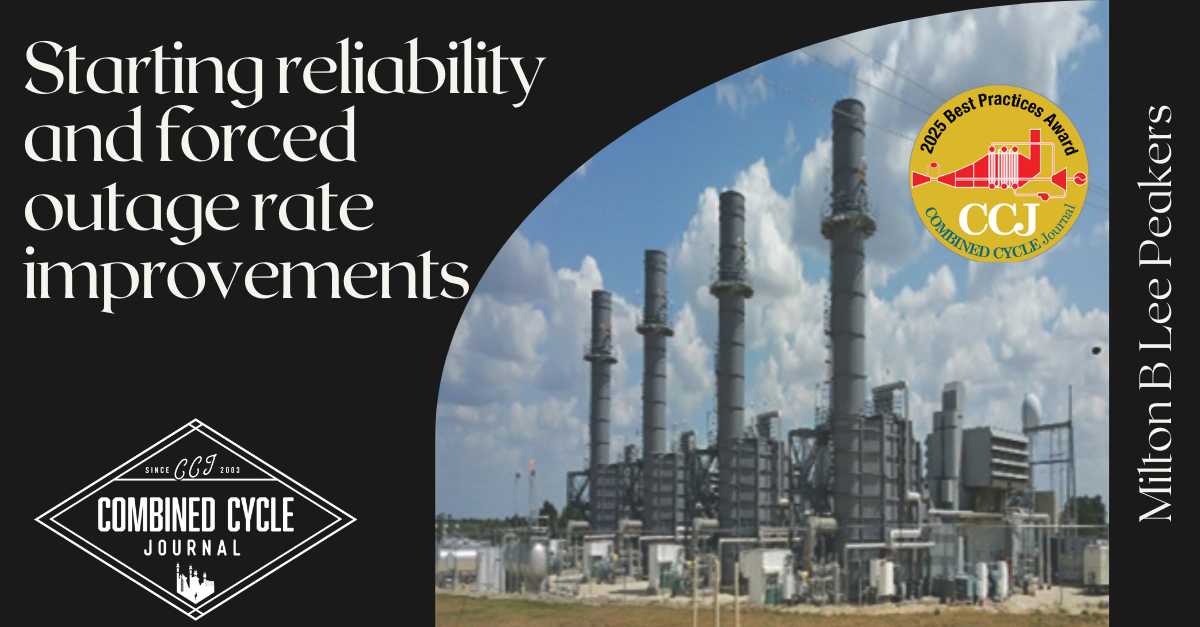

Milton B Lee Peakers
CPS Energy
376-MW simple cycle peaking facility powered by eight LM6000PC gas turbines located in San Antonio, Tex.
Plant manager: Ryan McDonnell
Challenge. Following an extended period of subpar performance, the owner partnered in 2017 with the gas-turbine OEM and an engineering firm to evaluate reliability across the eight LM6000PC peaking units and identify improvement opportunities. The objective was to restore expected reliability and improve unit readiness for peak-season dispatch.
