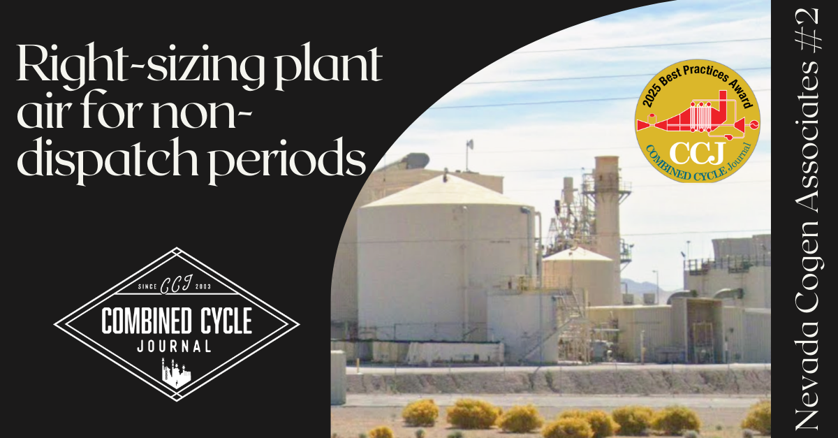

Right-sizing plant air for non-dispatch periods at Nevada Cogen
Nevada Cogeneration Associates No. 2
Owned by Panamint Capital
Operated by IHI Power Services
85-MW, gas-fired, 3 × 1 LM2500-powered combined-cycle cogeneration facility located in Las Vegas, NV
Plant manager: Chris Benkman
Background. Nevada Cogeneration Associates 2 (NCA2) shifted from a baseload operating model after a long-term power purchase agreement ended, and the O&M team targeted auxiliary loads that did not need “full-size” equipment when the plant was not generating.
Challenge. When the plant was offline or not dispatched, compressed-air demand typically dropped to essentials: instrument air, minimal service air, and system support. However, maintaining availability of dry, reliable air remained non-negotiable because it directly supported controls and device reliability.
