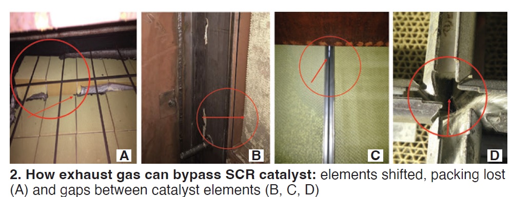

Catalyst should be inspected every outage to ensure its face is not blocked by rust or insulation. This can majorly affect catalyst performance by masking its active pore sites. The catalyst frame also should be inspected for any areas that may allow exhaust gas and ammonia bypass, which can greatly affect NOₓ and ammonia slip (Fig 2).
Ensuring these key maintenance and inspections are done regularly, and addressing problems when they are discovered, are essential to an efficient SCR system. To assist end users, Vector Systems offers comprehensive maintenance checklists for download at no charge for the following equipment:
