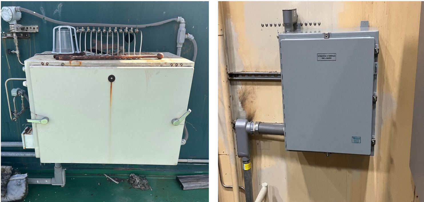

The webinar, viewable below, also reviewed how combustion-dynamics sensing has evolved over time. Early remote and close-coupled configurations relied on tubing, purge systems, and inline or near-line sensors. While these arrangements functioned adequately, they also introduced several paths for compromised data. If purge tubing was not kept clean, dry, and properly nitrogen-purged, unwanted frequencies could enter the signal. Vibration in the tubing and prolonged exposure to high temperatures added further opportunities for measurement issues.

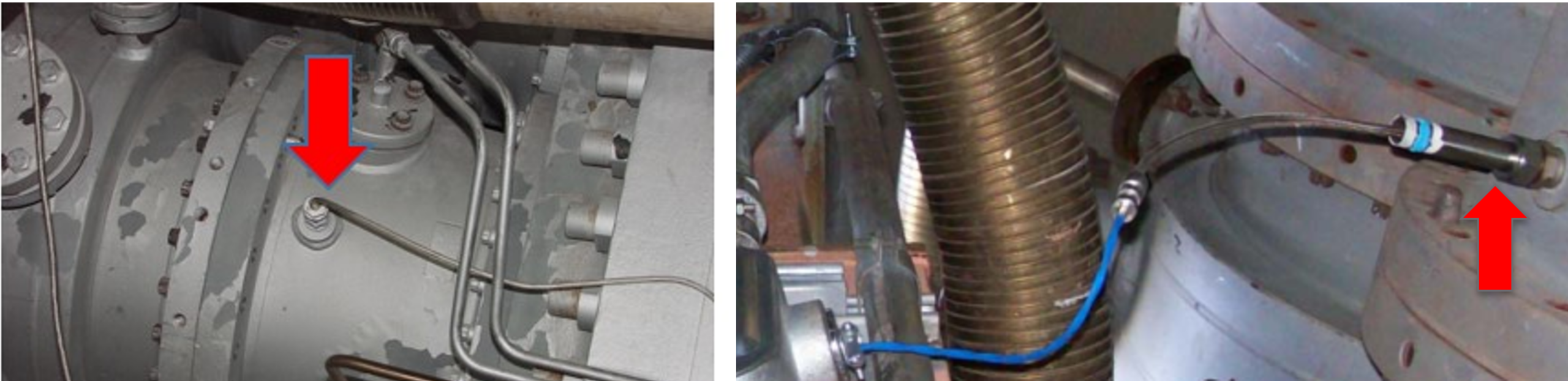

By comparison, sensors mounted directly on the turbine at the combustor avoid many of those complications. Designed to withstand temperatures approaching 1400F, these on-turbine sensors eliminate the need for purge systems, reduce maintenance requirements, and provide clearer signals. Martin noted that major OEMs now widely adopt these sensors for precisely those advantages.
Installation details matter. Sensors are typically mounted on the combustor casing, with the tip positioned either at the casing surface in a recessed mount or at the liner surface in a flush mount. Mounting methods include clamp nuts, screws, Swagelok fittings, and threaded sensor bodies torqued to specification. Martin showed examples from GE 7FA and Siemens 501F applications, along with cabinet hardware used in newer combustion dynamics monitoring system retrofits that replace older purge-box arrangements. The hardware chain itself is straightforward: high-temperature dynamic pressure sensor, extension cable, differential charge amplifier or signal conditioner, power supply, and the monitoring or data-acquisition system. But getting each link right is what determines whether the operator sees useful information or chases bad indications.
