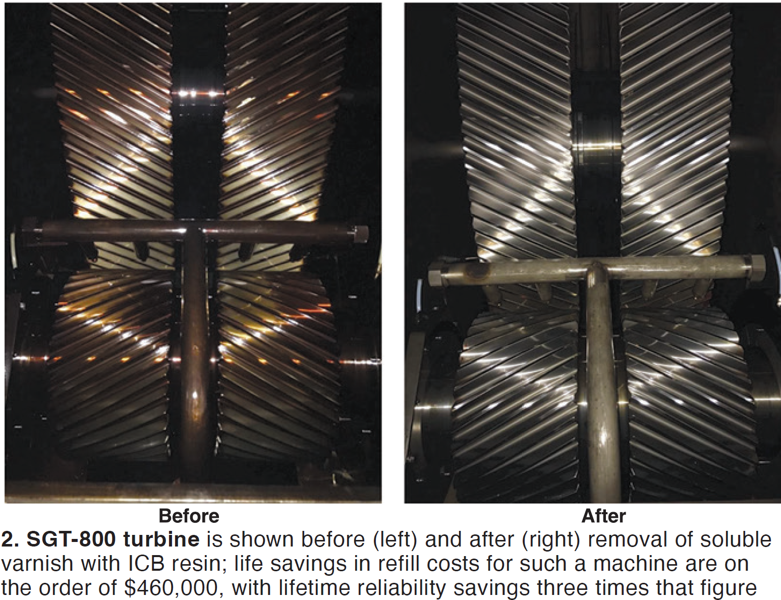

Engineered ICB ion exchange resins are thus the best option, according to Hobbs. Because oil-breakdown products are more attracted to the resin than to metallic component surfaces, these systems remove soluble varnish, which in turn reduces insoluble varnish, in a “positive feedback loop.” The amount of soluble varnish in the oil is dependent on operating temperature. Constant recirculation through ICB resins keeps the oil below the varnish saturation state.
The presentation, available at https://www.ccj-online.com/ept-webinar/, includes some dramatic video of varnish saturation changes with temperature and photos of MBC tests as well as varnished and unvarnished components (Fig 2).
