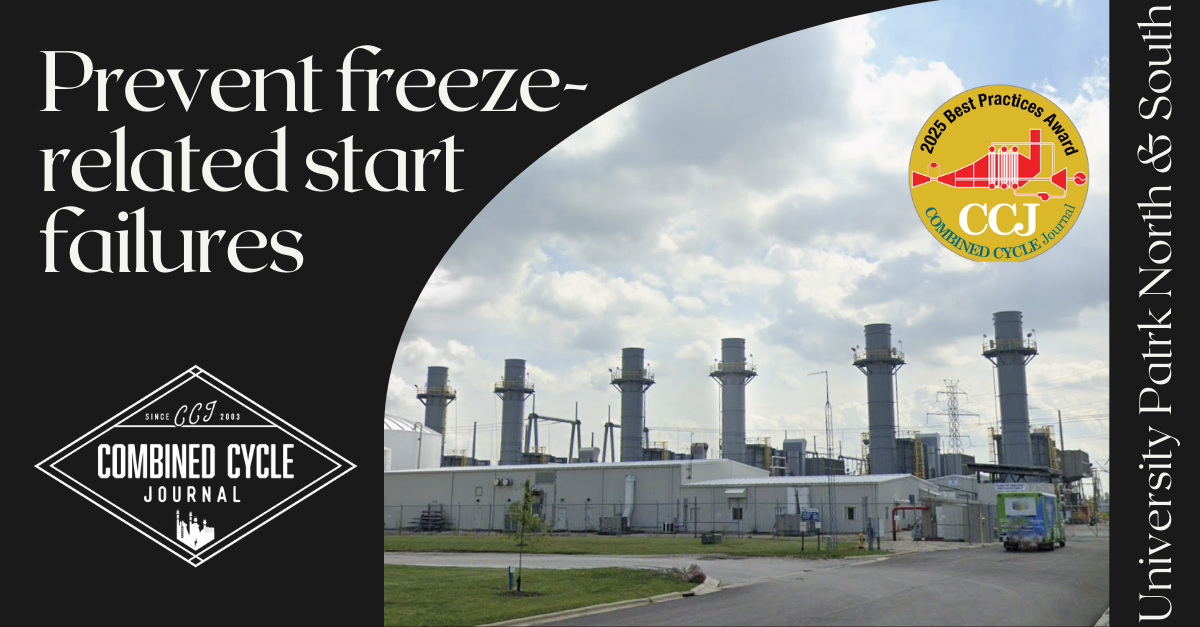

University Park North and South
North: 540-MW, simple-cycle peaking facility with twelve GE LM6000s.
South: 300-MW, simple-cycle peaking facility with six FT8 TwinPacs.
The plant is located in University Park, Illinois.
Owned by LS Power
Operated by IHI Power Services
Plant manager: Brandon Dupler
