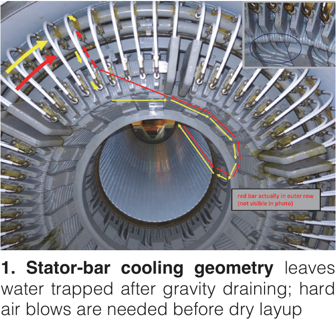

For long-term layup, the recommended path is drain and dry. The process starts by replacing water with nitrogen, valving out the stator from the cooling-water system, and using a series of hard compressed-air blows. Vacuum drying may follow, and pressure should be pulled below the vapor pressure of water at the coldest point. If the coil is dry, it can be left on air. If it cannot be dried fully, return to nitrogen conservation.
Gravity draining is not enough. Fig 1 shows why: the geometry of the stator-bar cooling path can leave water trapped in lower bends. Svoboda put the retained volume in a typical generator at about 500 liters. Vacuum drying after gravity draining will not remove that much water in any reasonable time. The water must be pushed out with hard air blows.

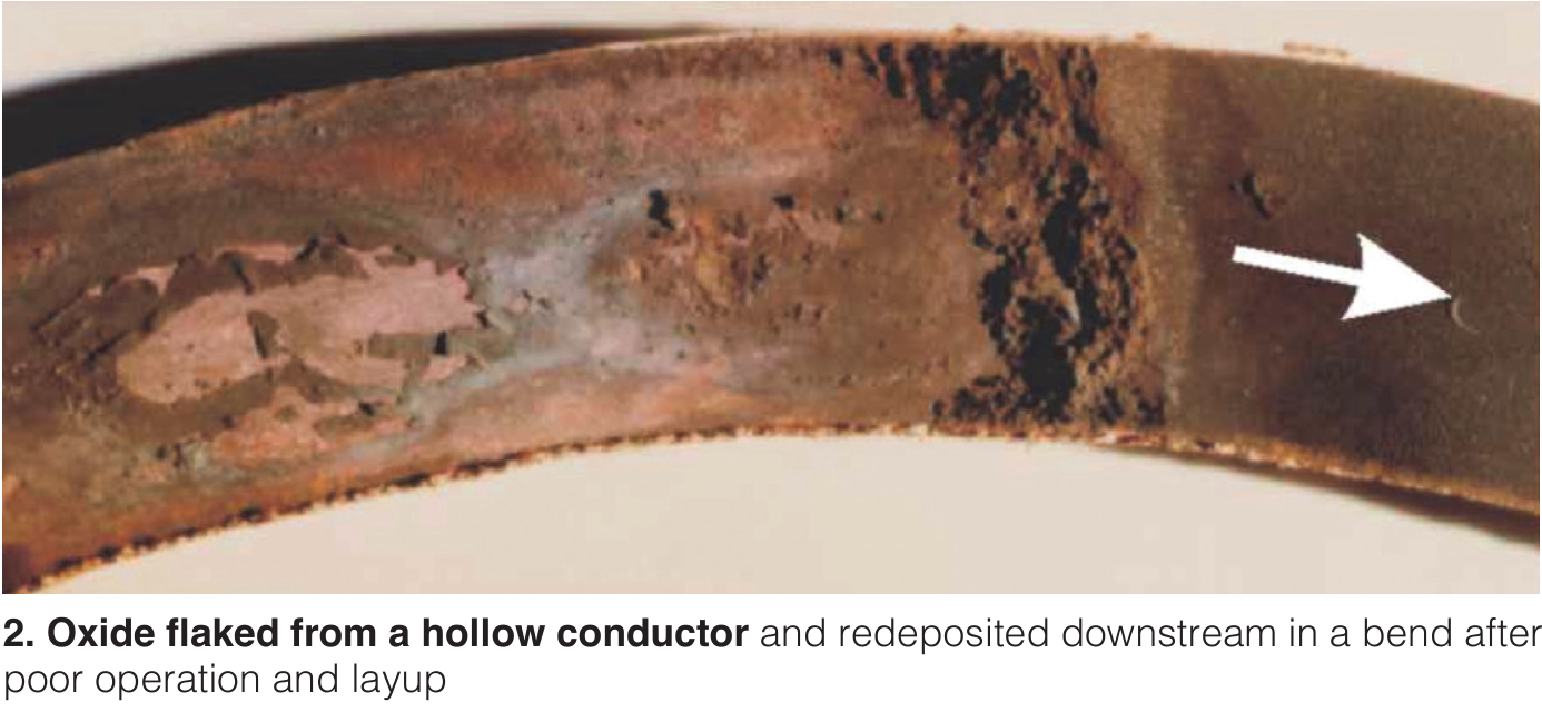

The clearest failure example involved a low-oxygen system that was actually running at 100 to 200 ppb oxygen during normal operation. The unit was drained and left idle in air for two weeks. At restart, after no proper layup, oxide flaked from a hollow conductor and redeposited downstream in a bend (Fig 2). The result was a melted stator bar and a shutdown that took months to recover from.

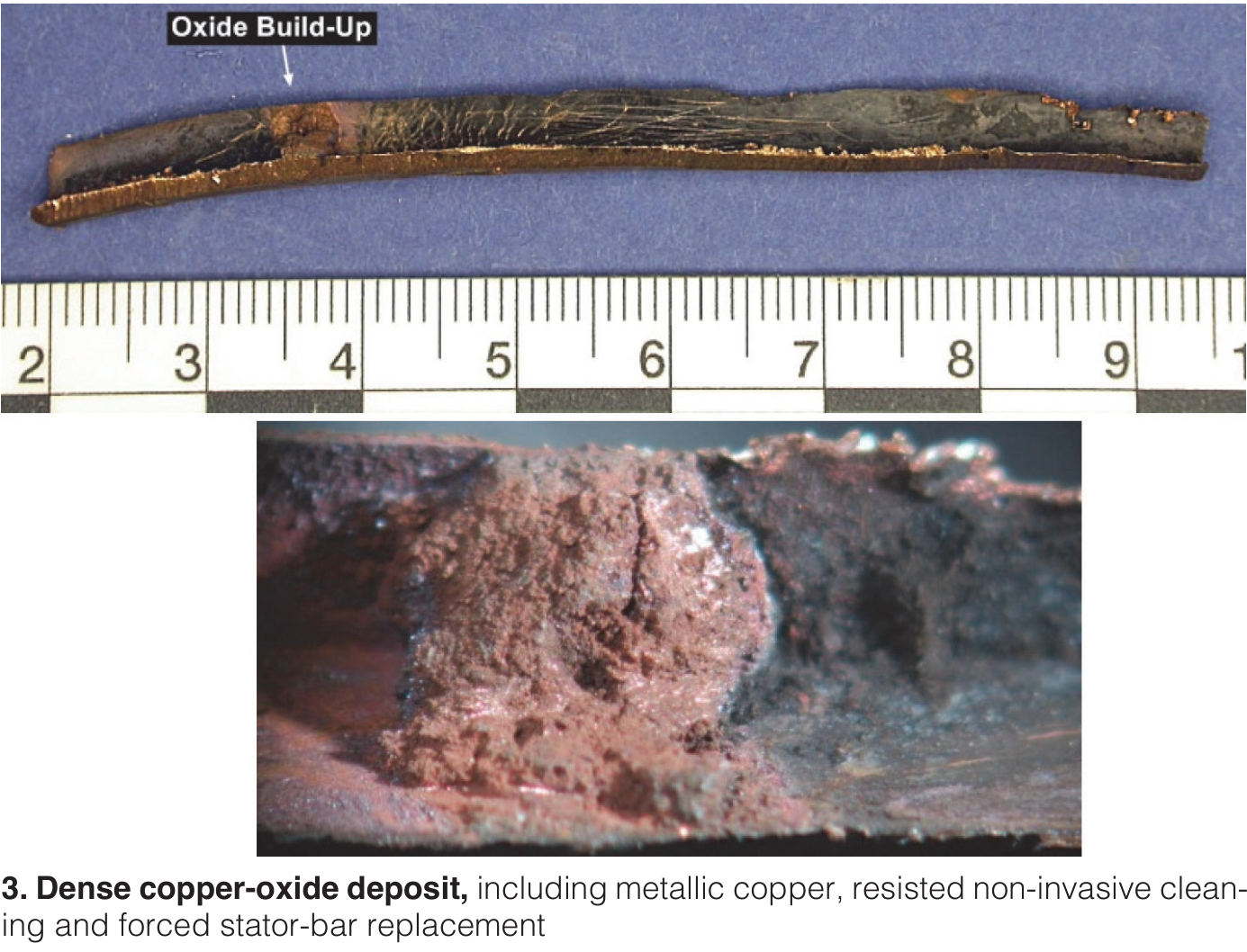

If deposits are already present, the choices narrow. Mechanical cleaning can include scraping, blasting, or brushing. Chemical cleaning can use acids or complexants such as EDTA, although Svoboda did not present acid as the preferred route. In the Q&A he said online cleaning with complexants has been performed about 150 times and is a proven method, but it is soft cleaning. Dense plugs may require combined chemical and mechanical work. In some cases replacement is the only practical answer (Fig 3).
