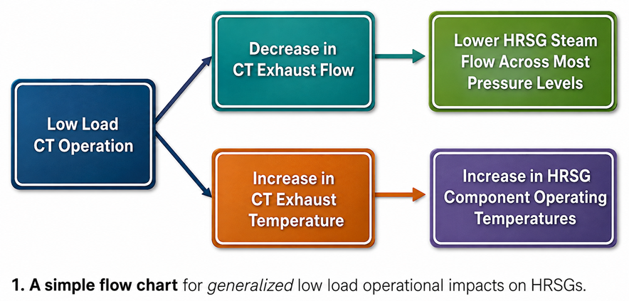

The general effects of low load CT operation on existing HRSG units can be grouped into two main categories as shown in Figure 1 below.
The conditions in Figure 1 are general guidelines rather than definitive outcomes for all low load operation. A combination of lower steam flow rates and higher exhaust gas temperatures can have impacts on fluid operating temperatures, flow rates, and velocities.

As depicted in Figure 1, low load operation typically results in higher CT exhaust temperatures and lower steam flow rates. The resulting effects increase the operating temperatures within the HP Superheater and Reheater systems. When incorporating new low load operating conditions, a thermal analysis can be performed to ensure that the Superheater and Reheater systems are operating within the original design conditions. Component re-rates or other mitigation steps can be taken into consideration to ensure component design temperatures are not exceeded.

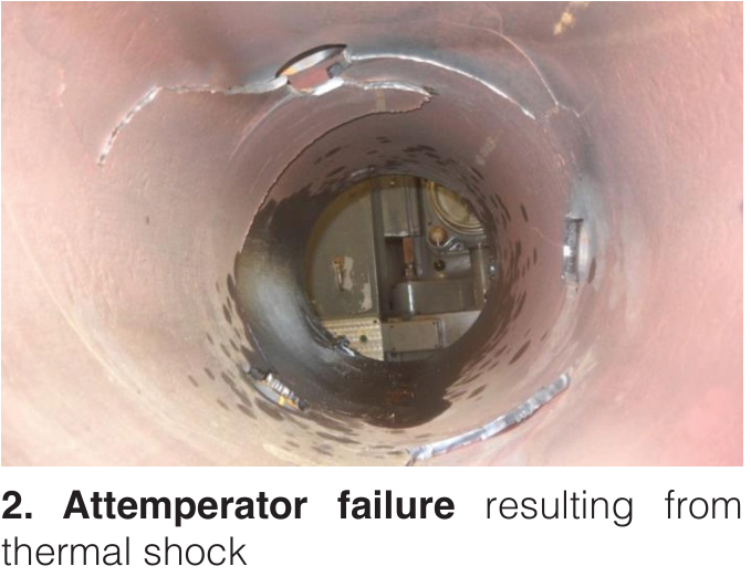

Attemperator systems also require specific consideration during low load operation. Due to the increase in CT exhaust temperatures and a reduction in steam flow, the required attemperator spray flow at low loads are often substantially higher than baseload operation. Subsequently, the minimum distance requirements for the downstream instrumentation and pipe bends may also need to be higher at low loads due to an increase in spray flow. Ensuring that the spray water is fully atomized by the time the flow reaches temperature measurement devices and pipe bends is crucial for the health and accuracy of the system.
During low load operation, the attemperator spray water temperature and the steam-side pressure commonly decrease. This results in the temperature of the steam flow downstream of the spray point approaching saturation conditions which can result in incomplete vaporization of the spray flow and subsequently quenching. An example of a failure resulting from quenching is shown in Figure 2.
