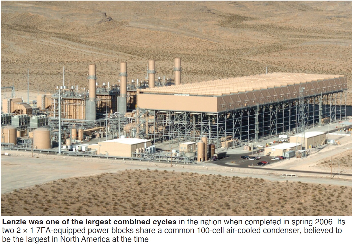

The following case history concerns NV Energy’s Chuck Lenzie Generating Station, a 2 × 1 natural-gas-fueled combined cycle located about 30 miles north of the Las Vegas Strip. The plant has two power blocks, each equipped with two 7F gas turbine/generators and one D11 steam turbine/generator.

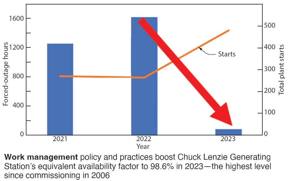

Lenzie, which went into service in 2006, achieved an equivalent availability factor (EAF) of 98.6% in 2023, its highest ever. While the number of starts doubled from about 63 per turbine in 2022 to more than 140 per turbine in 2023, the Lenzie team was able to reduce the plant’s forced-outage hours to only 153 compared to more than 1000 hours from the prior years. This was achieved primarily because of Lenzie’s strong adherence to NV Energy’s work management policy/practices (figure).

Process plants typically have a Computerized Maintenance Management System (CMMS) incorporating work orders that can build up over time if not properly maintained. Lenzie started 2023 by reviewing, with representatives from both operations and maintenance, each work order in backlog.
Result: The backlog of corrective maintenance orders was reduced from 600 to 120, the preventive work orders from 100 to 20. Note that NV Energy refers to a storage place for work orders that have not been closed as “The Backlog.”
