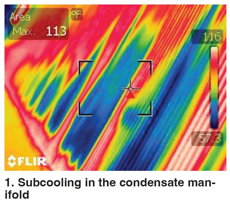

Sean Cusick, SPG Dry Cooling, offered Unlocking efficiency: overcoming subcooling challenges in ACCs.
He began with ACC fundamentals and focused on subcooling: “the difference between the calculated saturation temperature and the actual condensate or non-condensable temperature.” This is illustrated in Fig 1.
He outlined the sources of subcooling:
  • Uneven steam distribution.
  • Air flow (too much from fan or wind).
  • Steam surface availability.
  • Vacuum system issues.
  • Air ingress.
Subcooling, he said, leads to:
  • Freezing and a loss of efficiency.
  • Air ingress.
  • higher backpressure.
  • Increased fuel consumption and auxiliary load.
A fundamental: “Where there is air there is not steam; where there is steam there is not air. Condensate subcooling increases when the condensate passes through air within the heat exchanger.”
His bottom line: ACC performance matters; it impacts steam turbine output.
Cusick referenced a case study of the CPV (Competitive Power Ventures) Valley Energy Center in New York. To address negative impacts of continuous subcooling, even after a number of leaks were repaired, CPV implemented SPG’s remote performance monitoring system (ACC360), a “cloud-based solution that provides unprecedented insight into the performance and health of any ACC” through data analytics and modeling. For more on this plant, access this CCJ article.

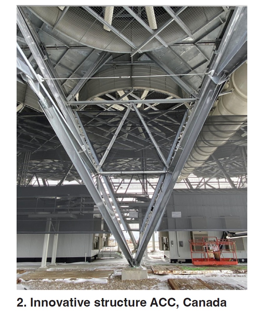

Jeff Ebert, Galebreaker Industrial, looked at Mitigating wind effects from high seasonal winds. He first addressed how wind and turbulence impact blade loading and ACC performance, followed by the benefits of wind screens to reduce wind effects.
Ebert discussed the 350 MW gas-fired project in Saskatchewan, Canada, with its innovative- structure ACC. See Fig 2.
Results show improved ACC thermal performance at a variety of wind speeds and ambient temperatures.

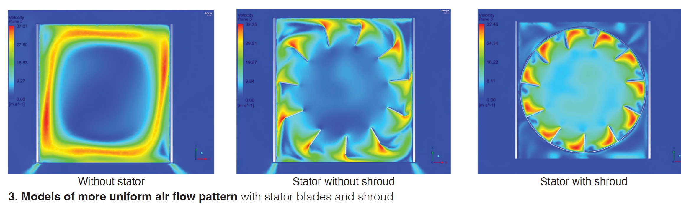

Mohammadreza Vaghar, Mapna Development Company, Iran, offered an Investigation of air flow over ACC tube bundles to improve cooling system efficiency.
This reviewed ACC module geometry, numerical modeling strategies (ACC and fans), fan stator blades and shrouds, data gathering methods and future studies. See Fig 3.

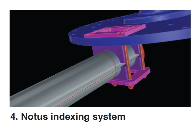

Chris Meyer, Notus Fan Engineering/Stellenbosch University, outlined From academia to industry (advanced fan technology). This presentation reviewed innovations in design based on aerodynamics, structural design, strength testing, and fan blade manufacturing. Field examples covered vibration testing, torque, power reduction, and an indexing system for blade strength. See Fig 4. Meyer, Stellenbosch University (South Africa), would follow later with Latest ACC research at Stellenbosch University.

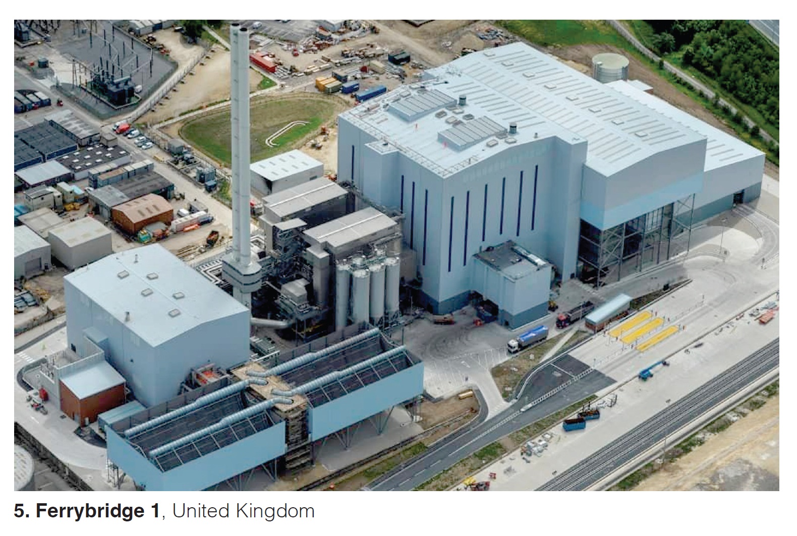

Lee Rhodes, Enfinium/Ferrybridge Power Station offered Ferrybridge performance improvement.
Ferrybridge is an 85 MW waste-to-energy facility in the UK (Fig 5), on line in 2015, with two boilers and one steam turbine processing 750,000 t/d of municipal waste. Gross power output is 86 MW.
The site installed Galebreaker wind screens on one unit based on CFD modeling in a cruciform and perimeter screen layout. Rhodes then showed comparative results of the units, with positive results on ACC vacuum vs ambient temperature following wind screen installation.

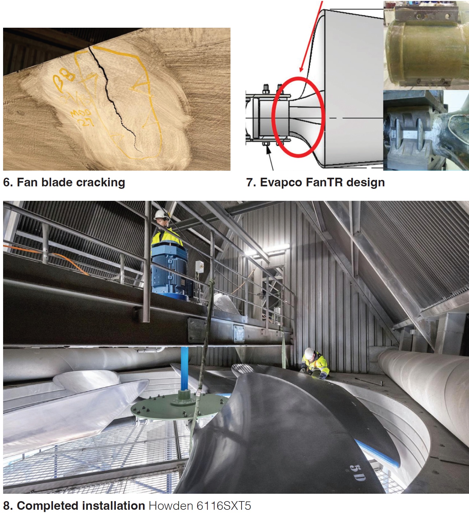

Patrick Saususs, Evapco Dry Cooling, offered Fan modification impacts on ACC vibration. His case study was the Virginia City Hybrid Energy Center, owned and operated by Dominion Energy.
This coal waste and biomass plant features 2 ACCs with 7-blade fans, 30 cells each. Blade cracking (Fig 6) has been an issue since 2016. The solution in this case was the 9-blade FanTR design (Fig 7).  Installations began in 2018.
This case history covered vibration fundamentals and standards as well as gearbox mounting studies.
One lesson learned: Seemingly minor modifications can have a big impact. You must look at frequencies in multiple directions, and be cautious of multiple fan interactions.
Jacques Muiyser, Howden (Netherlands), offered a Low noise ACC retrofit case study.
In this Howden Netherlands case study, the 10 existing fans had been in operation for 20 years. The goal was to improve cooling capacity in summer with no increase in noise level. The owner/operator also wanted to implement fan speed control to reduce fan power consumption when additional cooling was not required.
The retrofit method discussed involved baseline measurements of the existing fans, new fan selection, detailed engineering of fans and other components, and safety assessments, followed by delivery and commissioning specifics.
A Howden model 6116SX15 (Fig 8) was selected to deliver 30 percent more flow than the existing fans. Although the fans would run at higher speed, a decrease in sound power level of 3 dBa was expected. VFDs for fan speed control were added.
During commissioning, a reduction in blade angle of approximately one degree resulted in a desired increase in air flow while not exceeding the maximum allowable motor power. High vibrations occurred and the solution was additional stiffening plates to the fan casing.
“Due to the implementation of VFDs and speed control, energy could be conserved during periods where additional cooling was not needed,” he said: “This was a good example of every retrofit project is unique.”
