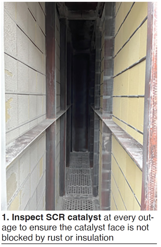

SCR catalyst should be inspected at every outage to ensure the catalyst face is not blocked by rust or insulation (Fig 1). This can majorly affect SCR catalyst performance by masking the SCR’s active pore sites.
Bypass can greatly affect NOₓ and ammonia slip. The catalyst support structure, as well as the perimeter seals, should be inspected to ensure there is no bypass of exhaust gas and ammonia. Assure catalyst modules are well packed to prevent ammoniated exhaust gas from passing unreacted through gaps around the catalyst bed. On a high-performance SCR, small amounts of bypass can drastically add up to the inability to meet objectives.

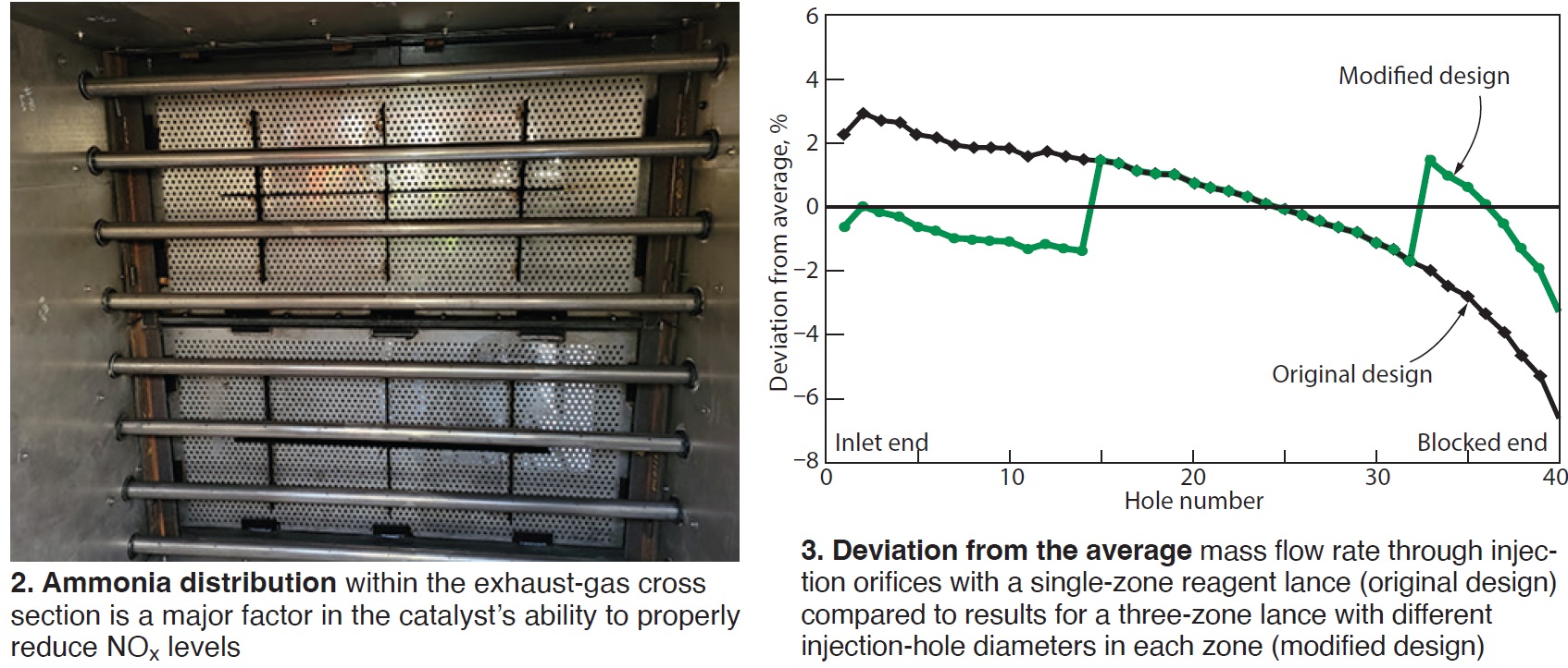

Ammonia distribution within the exhaust-gas cross section is a major factor in the catalyst’s ability to properly reduce NOₓ levels. This important part of the system falls on the design of the ammonia injection grid. AIG design must consider the amount of ammonia and diluent required for the reaction, as well as the ability to inject and mix the ammonia with the NOₓ present in the exhaust gas (Fig 2).
Give careful consideration to injection pressures, mass flow, and density change along the length of each AIG lance. Injection-grid design for advanced NOₓ control will carefully vary injection orifice sizing, spacing, and angle of injection necessary to ensure the NH₃:NOₓ distribution is matched to the volume of catalyst (Fig 3).
Inspect the AIG every outage to ensure there is no significant plugging, which could have a huge impact on catalyst performance. Clean the AIG if you find plugging, then determine the root cause. Often, the design of the AIG can be improved to achieve better performance and provide some resilience against frequent plugging issues.
