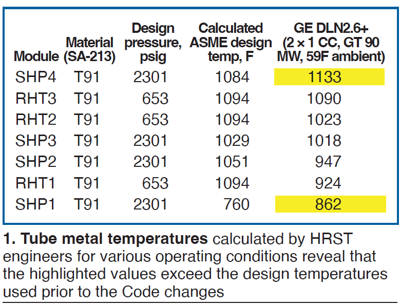

The reduction of ASVs has a direct impact in HRSG design considerations. At a typical operating condition with a tube metal temperature (TMT) of 1100F, the new ASVs for Type I and Type II materials see a reduction of 15.5% and 11.6% respectively. This directly results in a higher MWT requirement for the same operating temperature; conversely, it reduces the allowable TMT for existing designs.
In addition, there are many other industry changes that add to the considerations of the Code change. Many plants have implemented GT upgrades which often create more demanding conditions for the HRSG. Operating profile changes, especially more frequent operation at lower loads also have a significant impact on the expected life of systems using Gr 91 material. Other issues such as non-uniform flow distribution in the burner duct area, increased firing temperature, missing baffles that create bypass lanes, and internal oxide growth can exacerbate the problem.

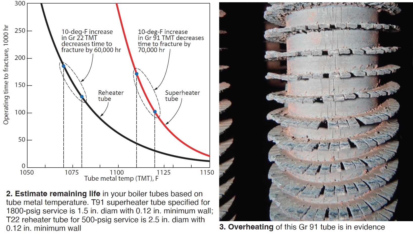

Most HRSG designs employ Gr 91 material near its limits, which creates a situation where a small increase (15 to 20 deg F) in TMT could have a drastic reduction in the expected life of the material (Figs 2 and 3).
HRST has performed analyses of specific cases using the Larson-Miller Parameter (LMP) for creep-life approximation and found up to a 40% reduction in expected operating hours for an 11-deg-F TMT increase. Given the possibility for these types of situations, consider putting steps in place to evaluate the current condition of your Gr 91 systems.
