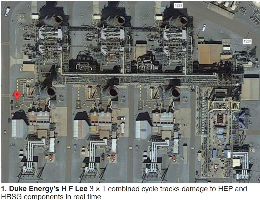

The reference plant (Fig 1) has three triple-pressure HRSGs behind Siemens F-class gas turbines that have accumulated 70,000 service hours since 2012. Currently in baseload, the plant is moving into cycling operation, expected to increase wear and tear on the units.

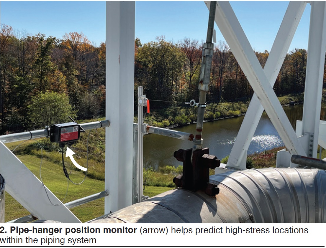

The presentation includes descriptions of data collection nodes and e-mail notifications, highly valued at St. Charles because of limited engineering and walkdown staff.
Cycling concerns led to wireless monitoring of the HEP system, again working with SI (Fig 2). HEP monitoring examples highlight a growing area of concern at many plants.

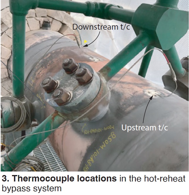

This includes discussion of HRH bypass thermocouple locations (Fig 3), circumferential data with thermocouples at 12:00, 3:00, 6:00 and 9:00 locations, and results of data over time.
Bauver looks at a specific HP-to-CRH bypass event, and data indicating non-uniform attemperator spray and indications of possible bypass-valve leakage.

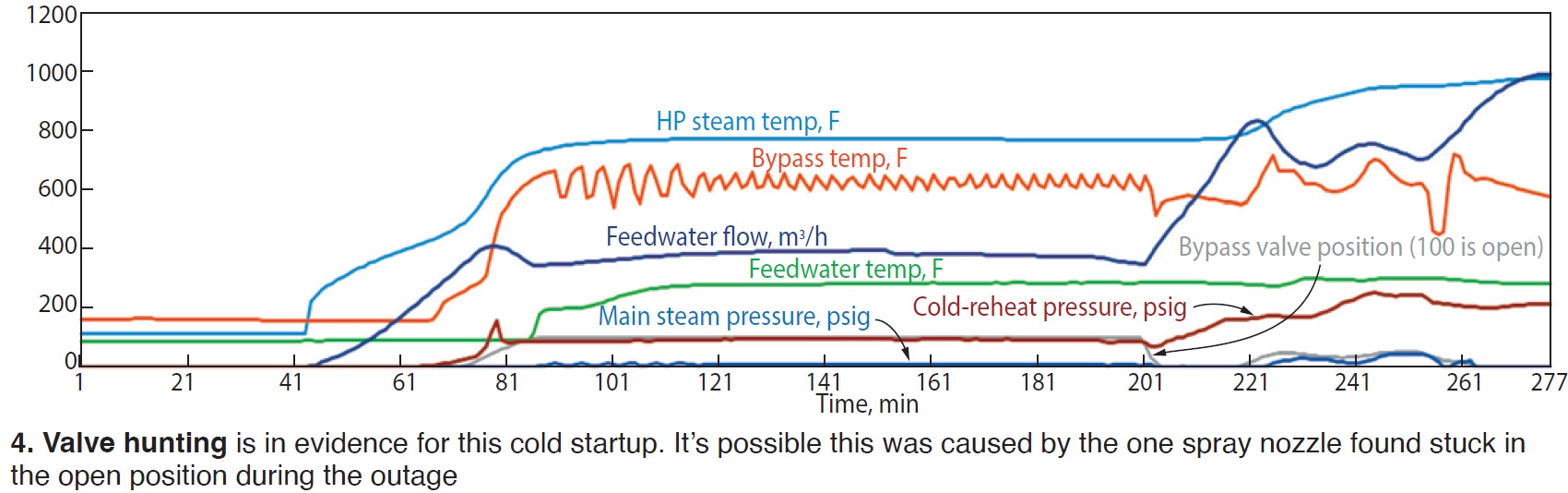

Bauver ends with a look at typical cold starts and graphic evidence of valve hunting (Fig 4).
