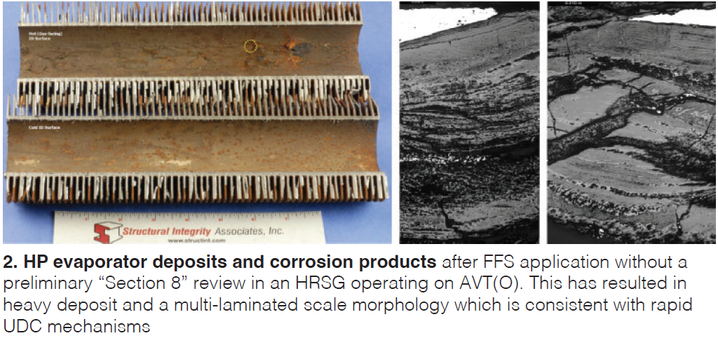

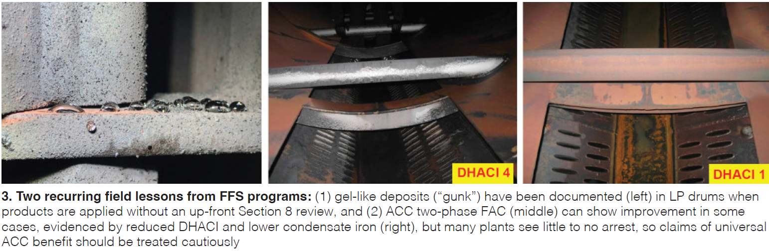

A large portion of the webinar focused on adverse experiences reported in the industry when FFS are applied without understanding baseline conditions. Dooley listed outcomes that have been associated with poorly controlled application in some plants: increases in internal deposits, under-deposit corrosion and tube failures, gel-like deposits in drums and non-heat-transfer areas, turbine deposits, and plugging of strainers and filters.

Hater noted that some FFS products appear to “clean” by loosening porous oxide or mobilizing particulate, which can reduce transport after the initial period. The risk is that mobilized material can redeposit, accumulate as gels or agglomerates, or contribute to under-deposit corrosion in susceptible HRSG and boiler sections. The practical message is that deposit condition must be assessed before dosing begins; referred to as a Section 8 review as delineated in the IAPWS TGD.

Dooley presented HRSG HP evaporator deposits and tube failures that occurred after application without adequate up-front review. He emphasized that deposit loading and deposit character in these circuits should be assessed using IAPWS tools before any FFS decision. He also noted that some recent failures suggest mechanisms that merit further research and broader industry sharing (Fig 2).

The webinar highlighted air-cooled condensers as a special case because two-phase FAC at tube entries can be visually tracked and indexed. Dooley provided an example in which an FFS program aligns with improved ACC indicators, while also stressing that many cases exist where neither FFA nor FFP arrests ACC FAC. Plants should treat claims of universal ACC improvement with caution and rely on site-specific monitoring (Fig 3).

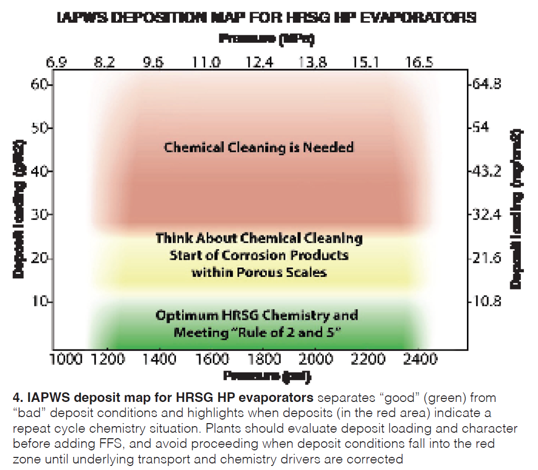

- Achievable iron targets. Total iron levels should be compared to “achievable” benchmarks for the plant’s treatment approach and configuration (including ACC units). Values above benchmarks indicate repeat cycle chemistry situations that require correction before adding FFS.
- Flex-operation tools. For frequently started units, the webinar describes tracking iron decay during startup and comparing performance to an IAPWS decay map.
- Deposit screening. For HRSG HP evaporators, deposit loading should be assessed and compared to IAPWS deposit mapping guidance. Plants in a repeat cycle chemistry condition should not proceed with FFS until underlying issues are corrected. It was also shown that deposit analyses are equally applicable for fossil plant waterwalls (Fig 4).
