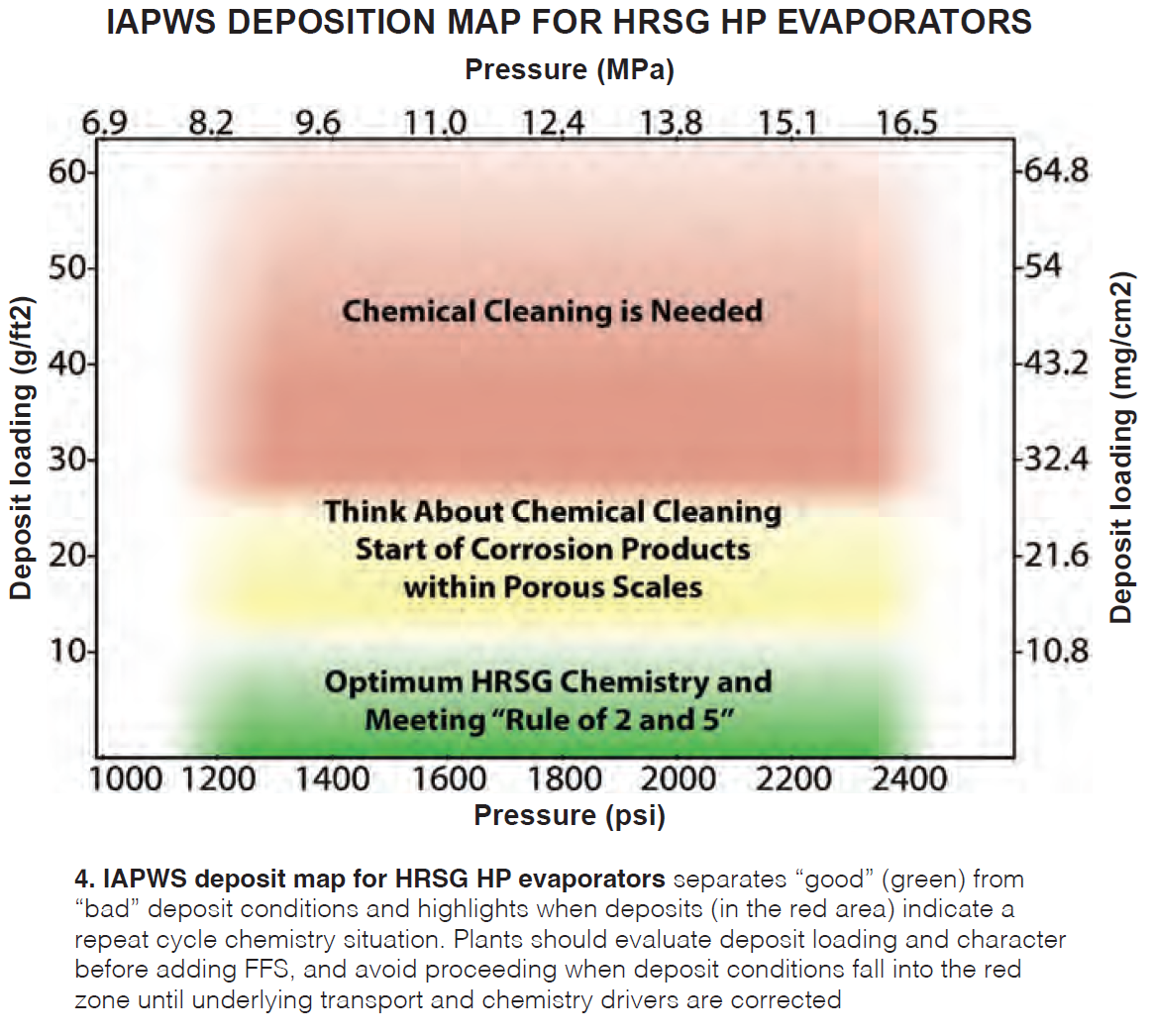

Baseline, screening, verification
The presenters repeatedly framed FFS as an engineered change that should be implemented with defined objectives, staff training, and clear verification methods. They described “Section 8” as a structured path to reduce risk and to determine whether an FFS program is delivering value.
Key elements include:
  • High quality corrosion product monitoring. Methods must include full digestion and detection limits suitable to resolve meaningful improvements.
  • Achievable iron targets. Total iron levels should be compared to “achievable” benchmarks for the plant’s treatment approach and configuration (including ACC units). Values above benchmarks indicate repeat cycle chemistry situations that require correction before adding FFS.
  • Flex-operation tools. For frequently started units, the webinar describes tracking iron decay during startup and comparing performance to an IAPWS decay map.
  • Deposit screening. For HRSG HP evaporators, deposit loading should be assessed and compared to IAPWS deposit mapping guidance. Plants in a repeat cycle chemistry condition should not proceed with FFS until underlying issues are corrected. It was also shown that deposit analyses are equally applicable for fossil plant waterwalls (Fig 4).
