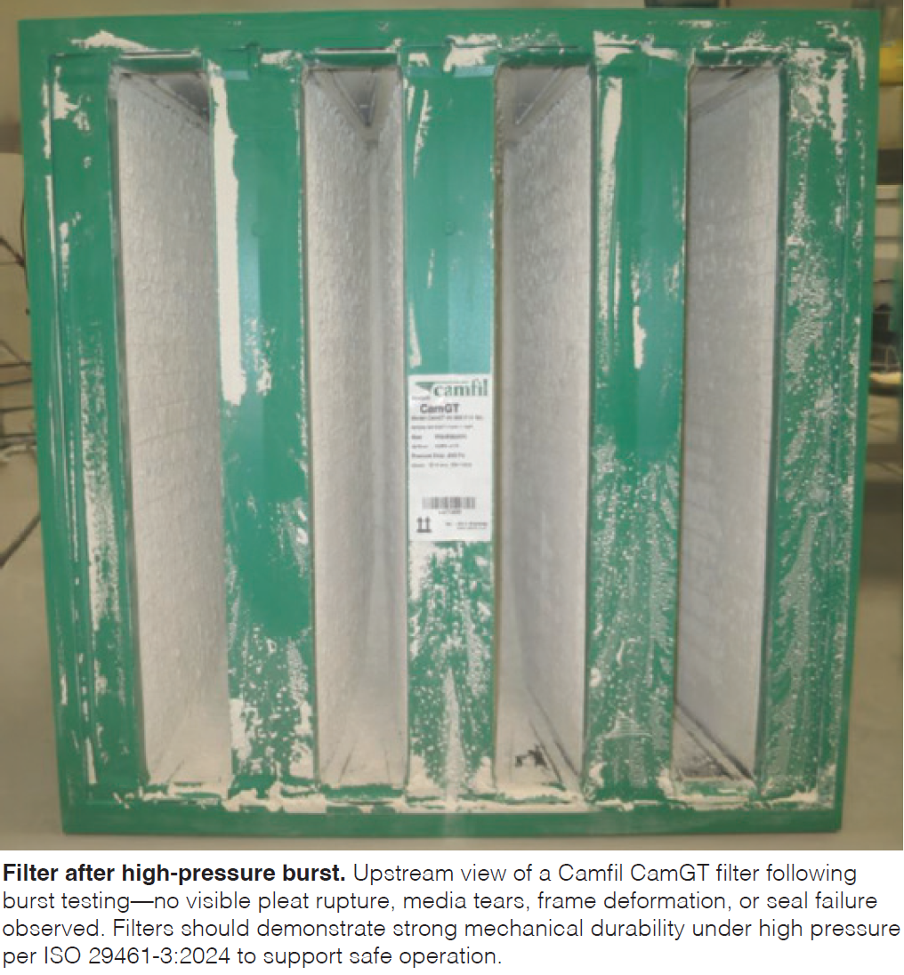

  • Post-burst efficiency check. After wet burst exposure up to about 25 in. w.g. (approximately 6250 Pa), the standard assesses damage and any drop in particulate efficiency. A filter rated T10 in new condition, for example, might degrade to T8 if the media has torn or structurally yielded in service. ISO 29461-3 measures and reports that change.
Three-step method: Confirm initial efficiency per ISO 29461-1, perform the wet burst to the specified pressure, then verify no loose pieces, no sudden pressure-drop reductions indicative of tears, and measure any efficiency reduction.

Filter after high-pressure burst. Upstream view of a Camfil CamGT filter following burst testing—no visible pleat rupture, media tears, frame deformation, or seal failure observed. Filters should demonstrate strong mechanical durability under high pressure per ISO 29461-3:2024 to support safe operation.
