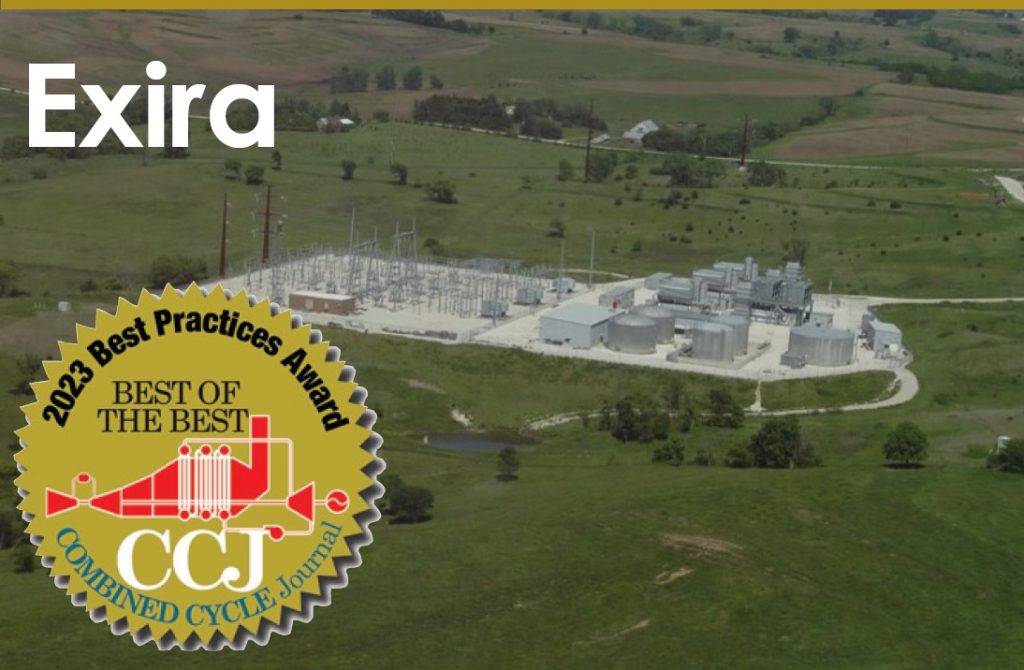

Exira Station
Owned by Western Minnesota Municipal Power Agency
Operated by Missouri River Energy Services
140 MW, 3 × 0 gas-fired peaking facility with diesel-oil backup, located in Brayton, Iowa. The LM6000PC engines are equipped with Sprint
Plant manager: Ed Jackson
Background. Exira Station’s design minimum operating temperature is ‒26F. Plant often is called on to run at sub-zero temperatures and has operated as low as ‒30F.

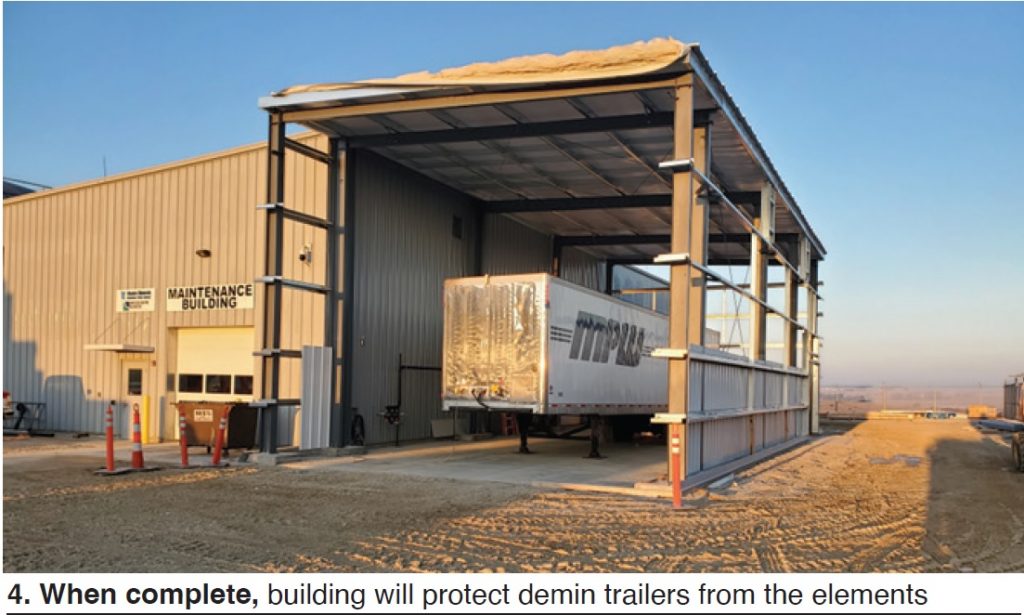

Challenge 8. The demineralized-water trailer sits outside on a cement pad with fire hoses to connect to plant piping that send raw water to the trailer, and demin water from the trailer to the plant. This creates many problems—including freeze-up of access doors preventing operators from gaining access to the trailer, and the need to handle hoses in sub-zero temperatures. Staff cannot leave the hoses outside overnight and when needed in the morning must pull them out, connect them, and get water flowing before it freezes.
When finished making water for the day, staff must shut down the demin system and disconnect the hoses and pull them into a heated building before they freeze-up. If the demin system shuts down automatically because of a system upset, personnel must rush to get hoses pulled inside before the water in them freezes.
It’s almost impossible to handle a frozen 2.5-in.-diam water hose. At times, personnel had to abandon the hoses in place and run new ones to keep water flowing. Also, trailers have been frozen in place with large ice dams preventing staff from replacing the trailers.
Solution 8. Exira is enclosing the demin-trailer pad and making it a heated building (Fig 4). When complete, it will accommodate two trailers side by side. A 26- × 18-ft roll-up door is being installed to close the building. This will greatly increase safety by preventing ice in the demin-trailer area and not having to handle water hoses during extreme cold conditions. Also, it will increase reliability by allowing access to the trailer and hoses at any time.
