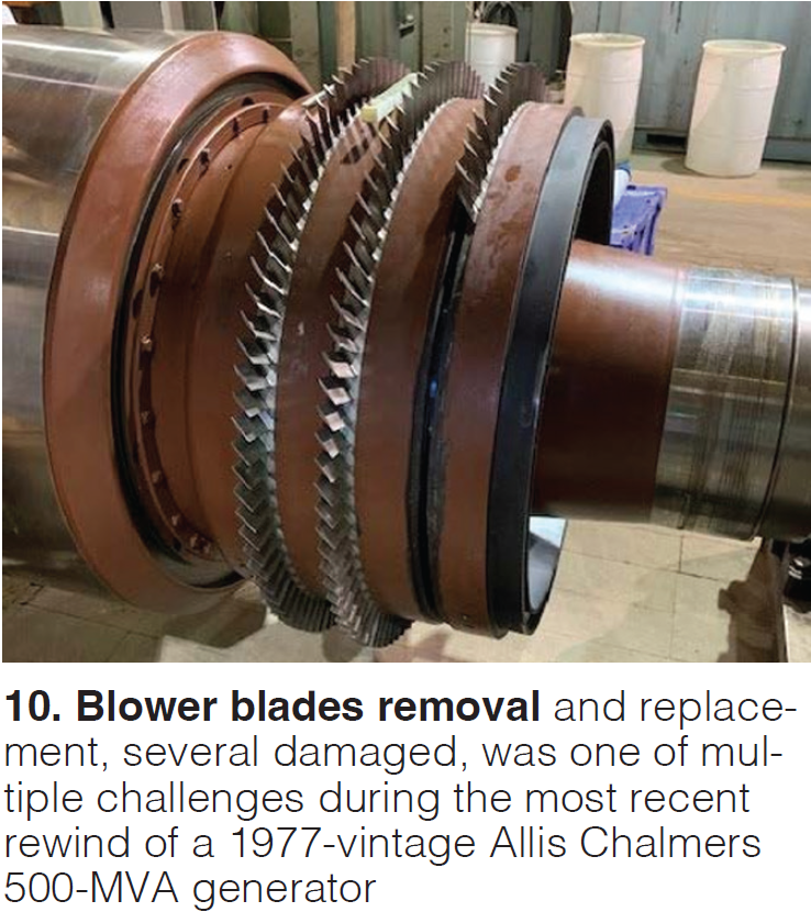

“Managing through a generator rotor ground indication and rewind” could be retitled four and a half decades in the odyssey of a generator in peaking service on a conventional fossil unit. The 500-MVA Allis Chalmers H2 and water-cooled unit entered service in October 1977, experienced a forced outage of unknown cause in 1978, and had 1000 starts under its belt by July 1985, and 2000 starts by June 1994. The rotor was rewound in 1998, and again in 2009.
The unit’s first ground alarm occurred in early May 2023 and field ground alarms began to initiate sporadically into late June. Because the consequences of a second ground can be catastrophic, the presenter asks two critical questions: What is an appropriate value to alarm and what is an appropriate value to trip or remove the unit from service?
Alarms became more consistent, and the plant began planning disassembly for repairs in the fall. It took fifteen days to get the rotor on a truck to the shop, where multiple issues were discovered, including heavy oil contamination, retaining ring liner crack, slot liner patch from the 2009 rewind, turn insulation not properly applied, and coil cracking. Next step was a rewind.
You’ll have to check out the slides to learn the challenges overcome during the rewind, subsequent overspeed test, and rotor rebalancing (Fig 10). Once the rotor appeared ready for service, vibration began to creep up three months into operation. One unique finding during the investigation: a snapped structural H-brace, apparently added two years after COD, with loose mounting bolts on the exciter outboard bearing which was found loose and unloaded in its spherical seat.

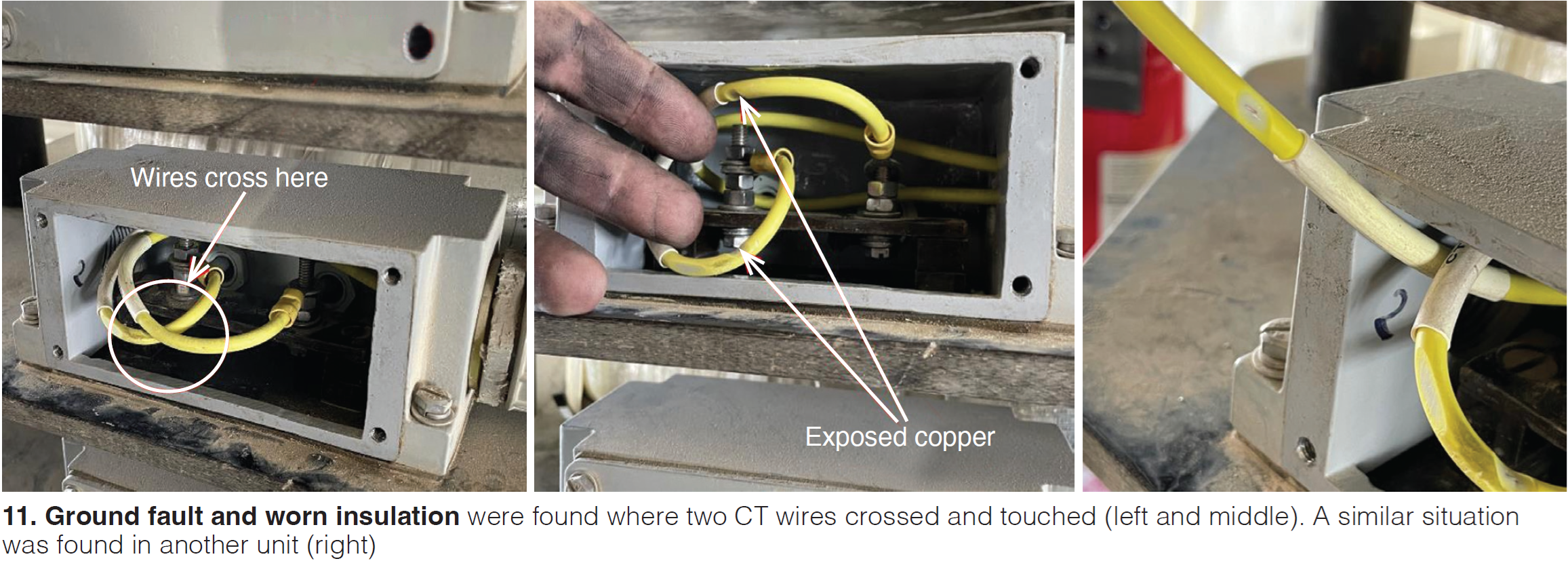

“GE 324 Generator Rewind Case Study” covers the challenges faced after a 263 MVA unit tripped on A phase differential running at 110 MW (unit rated at 197 MW). Subsequent O/O and OEM electrical tests were inconclusive. Three months before, the ST/G unit went through a three-month overhaul outage under an LTSA with the OEM at which time it passed all electrical tests but failed a bump test when the plant was looking into the modifications recommended under TIL2417 R1.
Management decided not to perform the mods for reasons listed in the slides, the most notable being a generator field replacement scheduled for 2027. You can guess what happened when the last slide recommends to the audience that they make the end winding modifications under 2417.
The other important recommendation is to check current transmitter wiring. This site found worn insulation and a ground fault where two wires crossed and were touching (Fig 11). Two similar instances of crossed CT wiring were found on other units.

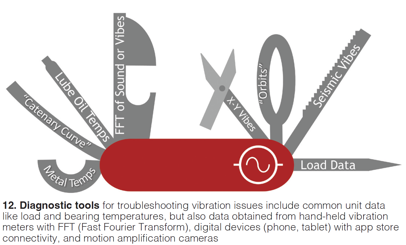

“Troubleshooting generator vibration” is about as concise a guide to the subject as you’re likely to find written for plant personnel (not vibration specialists) and available for free. The material presented is relevant for “about 75% of the vibration issues you’ll typically see.” This is a “must view” if you’re training a plant engineer or technician in vibration analysis.
One of the first slides is “know your tools.” A large table (vibration issues in rows, measured parameters and characteristics in columns) offers guidelines to link different issues with their common data patterns and determine what is commonly seen with that issue, and what is not (Fig 12).

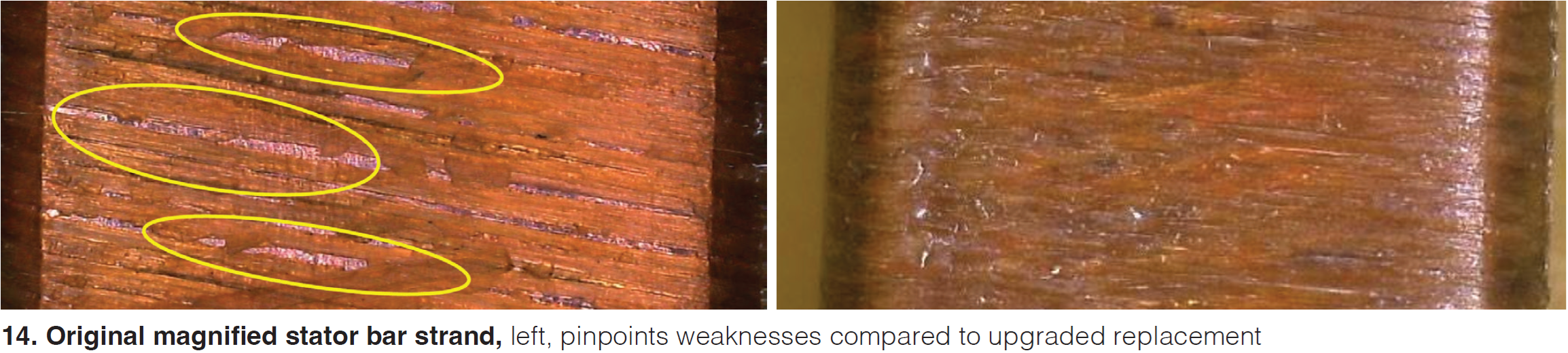

Big headline from this presentation is that a huge number of stators are reaching the end of their design lives, there are more unplanned stator rewinds than ever, large O/Os are planning/budgeting fleetwide stator and field rewinds over the next five years, and the shop and field service resources to handle all this isn’t increasing.
The more specific headline items from this presentation are (1) bolted joint integrity (and failure of the brazed joints) is a “big issue” but can be detected with on-line monitoring, (2) all OEMs have bulletins out on end winding issues, (3) global core looseness can be a problem with newer GE units, (4) loss of core compression will lead to core winding faults, (5) OEM upgrades often ignore generator constraints or operating history, (6) every unit should have a flux probe installed and a flux probe evaluation should be conducted at least once a year, especially if you have changed operating profiles, (7) the OEM should do a borescope inspection under the retaining rings during a minor, and (7) it takes 4-6 months to get a new set of windings.

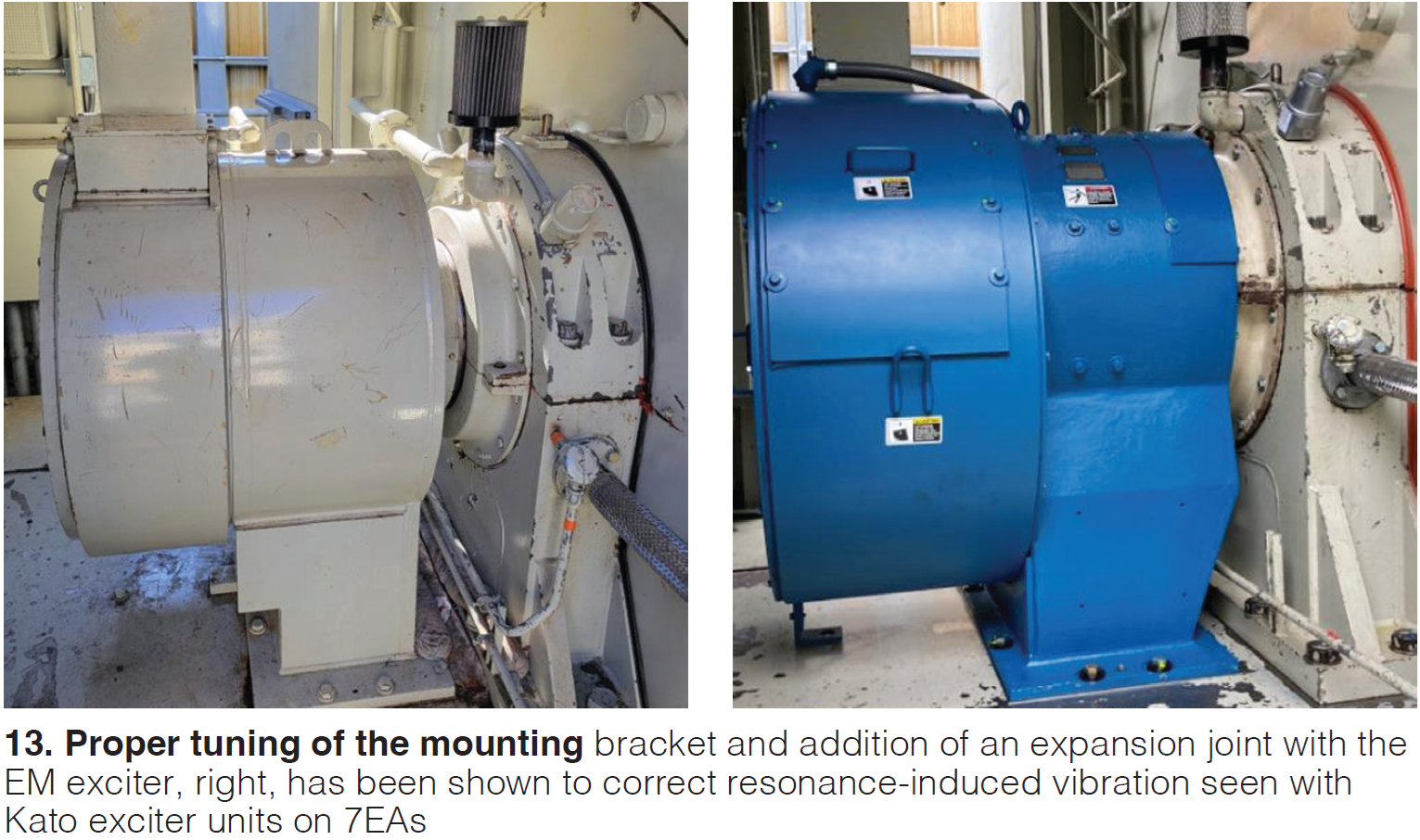

“Diagnosing and Correcting Exciter Cab Resonance,” Danny Besmer, WEG(EM)
Slides convey the lessons learned and troubleshooting methods while resolving vibration issues attributed to natural frequency resonance found on 7EA generators. In particular, design and mounting features of an EM exciter have been found to correct resonance induced vibration characteristic of Kato exciters in some projects (Fig 13).
