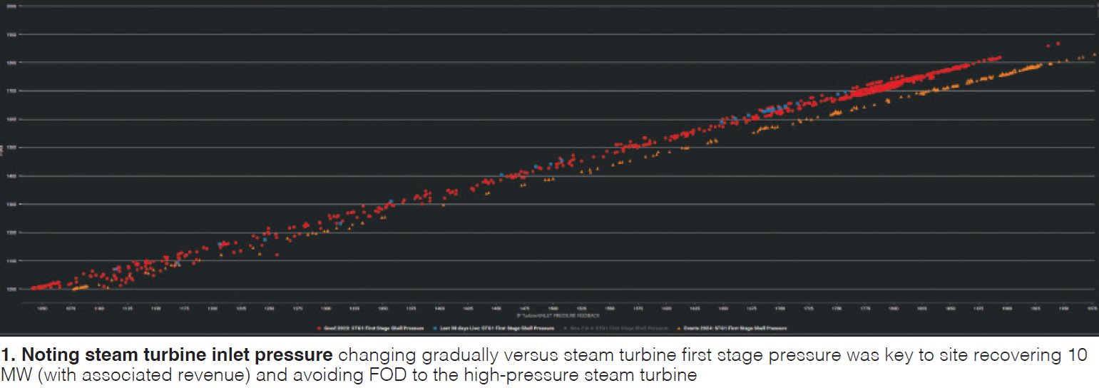

Gain MW, prevent FOD. Summer of 2024, CAMS APM was investigating possible performance loss on a CCGT block triggered by the APR software. Utilizing pin charts (which quickly separate groups of data by color), a gradual shift was noted, from the previous year, of steam turbine inlet pressure vs steam turbine first stage pressure (Fig 1).
The site was able to schedule an outage, before capacity testing, during which heavy debris was found in the steam turbine main strainer, along with a sheared pin from one of the main-steam stop valves. The planned outage repairs allowed the site to recover 10 MW, which allowed for $700,000 additional revenue. Also, the timely outage prevented the valve pin from releasing downstream and causing foreign object damage (FOD) to the high-pressure turbine. A previous similar FOD incident resulted in damages costing $5-million.

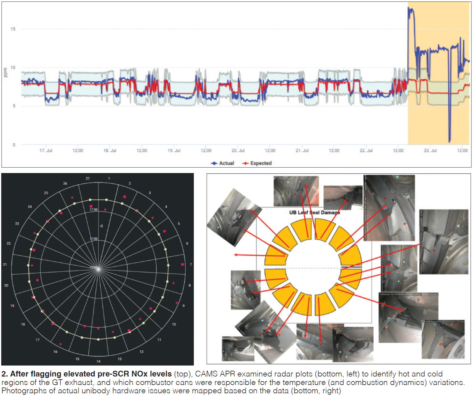

Fix NOx, combustor issues. Last summer, CAMS APM noted an increase in engine exhaust NOx upstream of the catalyst at a site. Utilizing live radar plotting (Fig 2), experts identified hot and cold regions in the exhaust profile to help the site identify which combustion cans were possible culprits. These temperature variations, together with combustion dynamics changes, supported an in-depth analysis by the OEM to improve operability until the planned major inspection the following spring.
Meanwhile, the site took advantage of its fall planned shutdown to borescope the unit, subsequently discovering multiple issues with the unibody seal and one combustion nozzle. This compelled the site to extend the outage prior to the winter run season and address these issues. The work performed has returned GT exhaust NOx to appropriate levels, alleviating concerns with permit exceedances until the spring 2026 planned shutdown.

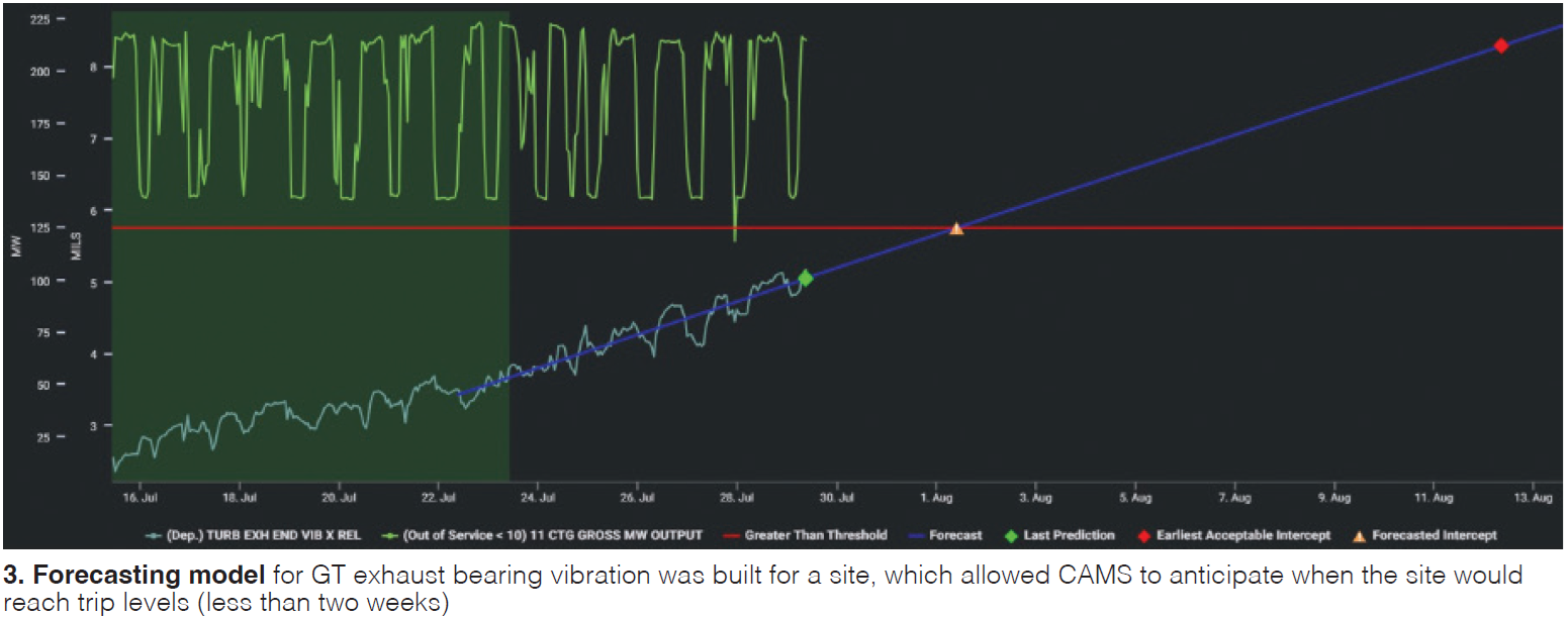

Forecast bearing trip limit. In May 2025 CAMS APM noted an increasing rate of change on the GT exhaust bearing vibration at a site. OEM reps were contacted, who suggested the behavior and values were normal. To ensure this situation was being adequately monitored, and to inform the customer well in advance of an impact on operations, CAMS APM added a forecast model (Fig 3). Five months later, the model indicated the situation was worsening. The site was notified that it had 13 days before reaching the trip limit on the exhaust bearing vibration.
The site again contacted the OEM reps. The OEM reiterated that the behavior and values were normal. However, as a precaution, the trip limit parameter was raised by the OEM. This prevented the unit from going into a runback or trip so the site could make it to the spring 2026 major inspection.
