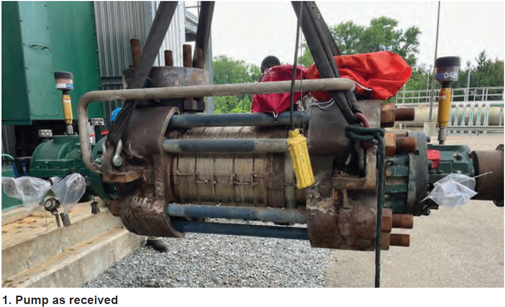

After experiencing high vibration, casing leakage, and other indicators of poor performance early in service, a combined-cycle owner/operator (O/O) identified design vulnerabilities and pursued modifications to improve robustness and restore best-in-class tolerances. Working with Hydro’s Atlanta facility (Hydro South), the team implemented upgrades focused on three areas (Fig 1):
- Eliminating leakage paths
- Minimizing wear and restoring rotor stiffness
- Reducing axial shuttling and balance-device-driven vibration

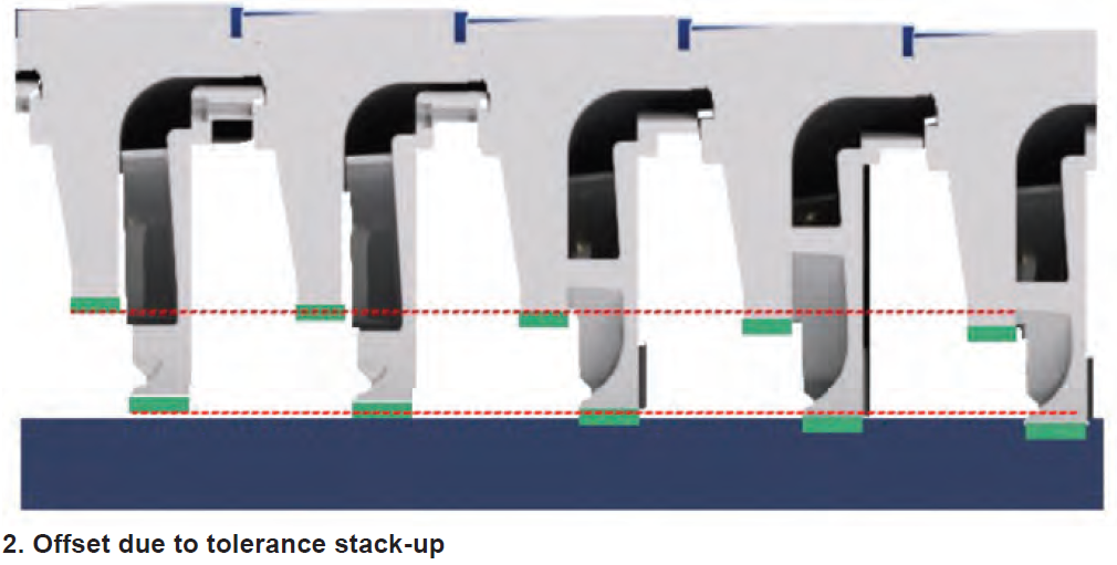

A foundational step in any multistage pump refurbishment is restoring components to best-in-class standards. Segmental-ring pumps demand experience and attention to detail during restoration and assembly. Tight control of bore geometry, face runout, and shaft straightness reduces the drivers of misalignment. Avoiding excessive fit-ups is also essential: because these pumps consist of stacked components, excessive register fits can accumulate and produce large offsets across the assembly (Fig 2).

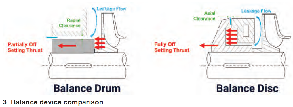

One reason the pump was susceptible is that it uses a straight balance drum rather than a flanged balance disk. The balance device reduces axial thrust during operation, lowering thrust-bearing load. A flanged balance disk, with both axial and radial clearances, is generally a self-compensating design capable of balancing axial thrust across operating points. A straight balance drum, by contrast, typically balances thrust at only one operating point (Fig 3).
Balance-drum sizing is based on total axial thrust from pressure acting on impeller hubs, which depends on wear-ring diameters. If wear-ring diameters change, residual axial thrust changes. During standard refurbishment, wear-ring clearances are often renewed by skim cutting the impeller hub and/or stationary wear-ring locating bore to remove damage, then installing a new wear ring sized to restore the intended clearance. This approach can result in varying wear-ring diameters across stages, depending on how much machining was required.
In this case, wear-ring diameter changes were sufficient to disrupt the intended residual axial-thrust balance. Axial thrust could also be affected by hydraulic instability at the impeller discharge when operating away from best efficiency point (BEP). Off-BEP operation can introduce intermittent, unpredictable swirl that increases the likelihood of axial thrust reversals—detrimental to bearing and seal life. To reduce this risk, Hydro South re-established not only design clearances, but also preserved the original design diameters of wear components.

Hydro South has upgraded three of the end user’s BFPs using the modifications outlined above and expects to complete the remaining pumps over the next several years (Fig 4). The improved operating behavior and reduction in vibration demonstrate that chronic instability in segmental-ring designs is not inevitable.
