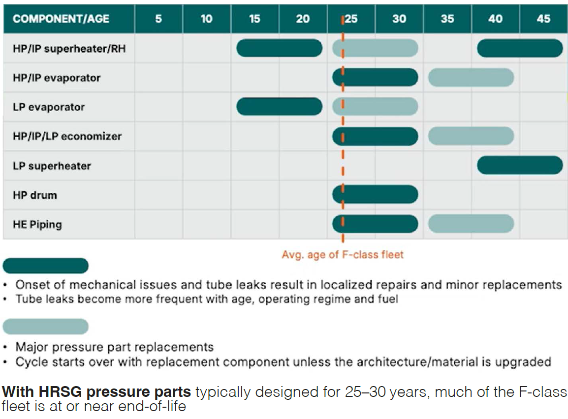

Why the urgency? Much of the F-class HRSG fleet is now past 20 years, and many units are entering a repair cycle characterized by more tube leaks, header cracking, and forced derates. When leak frequency and tube plugging begin to accelerate, owner/operators should evaluate whether continued repair-and-plug approaches still make sense versus scoped replacements that remove chronic pain and align the HRSG with planned or potential uprates.
