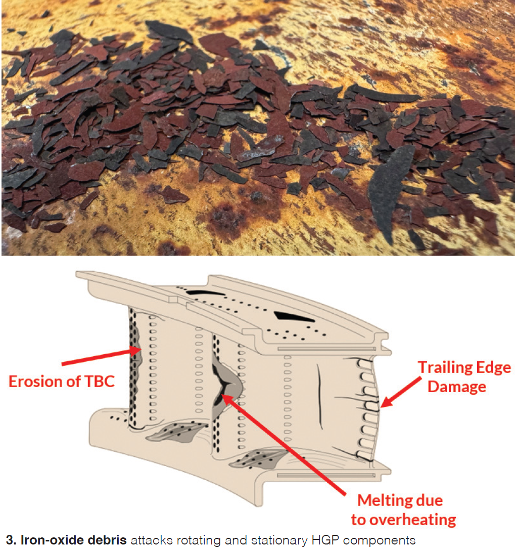

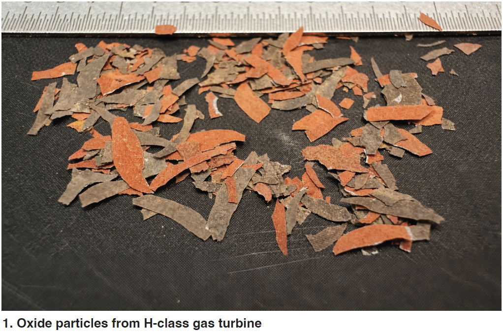

“Stop debris at its source, not after it forms,” cautions Eric Duvekot, VP of Engineering at Integrated Global Services (IGS), as he explains how field-applied high-velocity thermal spray (HVTS) addresses oxide flaking in the hot, high-pressure compressor sections of advanced-class gas turbines, and outlines proof points from OEM testing and fleet experience (Fig 1). The webinar session, viewable here on-demand, includes application methods, scope options and Q&A on components and materials.

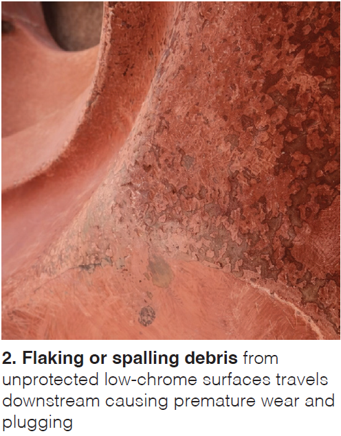

Background.  Rising compressor pressure ratios in advanced frames drive late-stage compressor temperatures above 500C, exposing low-chrome steels in casings and other internals to accelerated oxidation. The resulting oxide scales lose tenacity and exfoliate as flakes that migrate downstream. These flakes can plug cooling passages, erode thermal-barrier coatings and contribute to hardware distress (Fig 2).
Challenge.  Users report visible flaking in multiple fleets and OEMs, with severity influenced by operating conditions. In some cases, oxide exfoliation occurs simply from daily thermal cycling—sun heating by day, cooling at night—without machine operation. Consequences range from S1 vane damage to shovel-worthy accumulations of debris during inspections (Fig 3).
