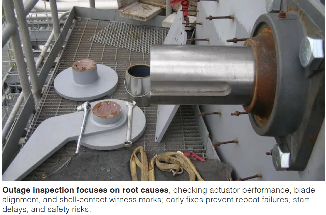

Most damper issues trace to the drive train and alignment. Marginal power, tired gearboxes, worn seals, or contaminated pneumatics cause partial strokes or stalls. Even small losses in torque or pressure can halt motion as exhaust backpressure rises. Misaligned or racked blades then add drag against the shell or stiffeners. Witness marks on the liner, shiny rubs, and uneven seal wear are common clues. The added friction loads the actuator, stretches stroke time, and evolves into repeated start holds. Misalignment seldom locks a damper immediately; it produces slow, inconsistent motion that increases actuator stress and erodes sequence predictability, leading to more manual intervention and occasional aborts when permissives are missed.

A short maintenance routine prevents the slow creep toward unreliable starts. During outages, verify frame squareness, re-shim hinges, replace worn bushings, clean and re-grease linkages with high-temperature lubricant, and re-set limit switches. Confirm torque switch or regulator settings against the acceptance record. Before return to service, run a cold functional test to measure stroke time and smoothness, then verify again hot after several hours online and watch for drift as the frame grows. In service, trend analog position versus command to catch slowing movement. Log minutes from open command to open proved as a KPI and investigate increases. After nuisance holds, check actuator output pressure or current under load and inspect for new rubs or witness marks.
