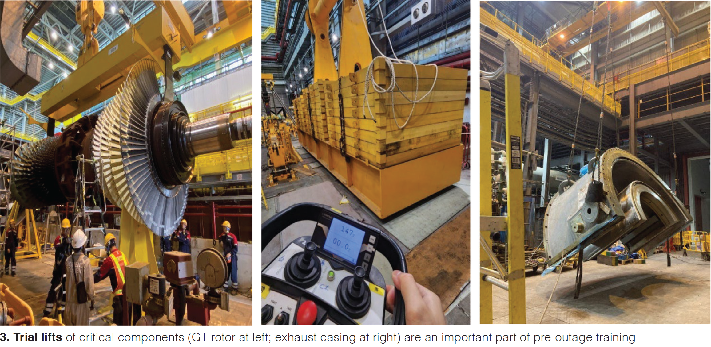

To ensure the safety message was well received by the personnel involved, some critical work packages were selected to test their understanding. For example, the gas-turbine upgrade project requires frequent heavy lifting of engine components, which involves complex handling operations.
Trial lifting of the gas-turbine rotor (Fig 3 left) and flipping of the exhaust casing (Fig 3 right) were performed to review the effectiveness of the lift plan and ensure all safety measures are being observed. A post-trial briefing was conducted for findings observed during the trial to ensure understanding and the drive for improvement.

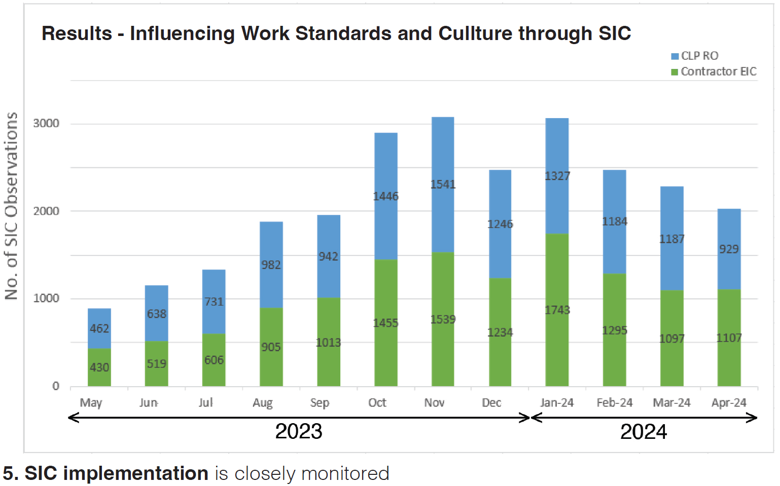

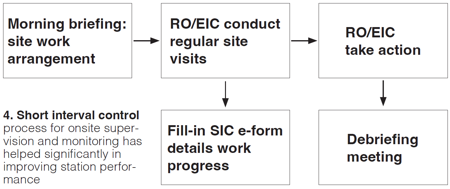

The first implementation of short interval control (SIC) for onsite supervision and monitoring in 2023 contributed significant improvement to site inspection and overall performance. SIC is a structured process that brings insight into identifying opportunity times for improvement and managing site safety, productivity, and quality performance—thereby enabling instantaneous actions to improve effectiveness and efficiency of activities and processes (Fig 4).
Regular site visits by CLP Power’s responsible officer (RO) and the contractor’s engineer-in-charge (EIC) can strengthen construction site management and directly instruct contractors on the owner’s requirements. Direct and timely supervision can effectively deliver the utility’s work expectations.
In each site check-in, the RO assures active supervision to provide the following:
- Timely calibration on site management.
- Seamless cooperation with contractors to address unforeseeable issues.
- Regular site performance records for analysis.
The direct benefits of SIC include empowering the RO to maintain adequate control and understanding of construction-site condition. When necessary, the RO can take immediate action to ensure effective site management. Any issues that arise during site checks are meticulously recorded and used to promote continuous improvement.
As the SIC process evolved from mere compliance to general use, it has played a crucial role in shaping the mindset of both the RO and contractors regarding effective site management. By bridging cultural and behavioral gaps that are aligned with CLP’s expectations, this process enhances the competencies of both parties.
Insights and observations derived from SIC undergo a thorough root-cause analysis (RCA). Lessons learned and action items to address identified issues are registered and communicated to both the RO and contractors via a pre-outage communications program. This proactive approach enables the outage management team and different working parties to make necessary preparations for any foreseeable risks in upcoming work.
With SIC implemented, ROs and EICs are required to proactively supervise work and capture the safety, quality, and productivity performance of site activities. An “SIC App” using “Power Apps” has been developed using the “Power Automate” platform for users to submit site observations for every job. The application streamlines processes by recording work planning data automatically and creating a database for all observations onsite while facilitating data analysis by the outage management team.
This analysis is used to facilitate discussions in the management control system as well as with the contractor management team in its drive for work ownership and continuous improvement.
Result. The effectiveness of SIC implementation has been monitored closely since its launch. Staff has found that the quantity of SIC submissions significantly increased during the outage season (October to April), indicating a higher level of work ownership on both the CLP in-house maintenance teams and contractor teams (Fig 5).
Numerous areas of improvement, which CLP calls “opportunity time” also were identified to improve outage performance in terms of productivity, quality, and safety. Since January 2024, an increasing trend of good observations also was reported through SIC exercise, revealing a positive change in the mindset and working behaviors of different contractor teams.
To achieve operational excellence, more support, guidance, and coaching from CLP Power was provided to selected contractor EICs and site supervisors, allowing them tighter control of the workforce and the ability to address productivity issues by taking immediate actions onsite. Productivity and quality of work improved accordingly.
Result. During a recent Unit D1 outage, the day and night shifts were scheduled to speed-up progress on critical-path activities; ROs were assigned shift duties to monitor work performance and progress. Past experience had indicated that a reduction of supervisory personnel during night shifts led t more relaxed behavior and lower productivity among contractors.
SIC process observations provided valuable findings into the specific items that had to be addressed, thereby enabling follow-up to rectify issues and improve overall performance.
Example of a productivity issue identified and improved at an early stage of the outage: Multiple SIC observations by RO reported that a contractor work team was not present from 11:30 p.m. to 1:10 a.m. for its meal break and also left the site at around 6 a.m. for an 8 p.m. to 8 a.m. shift.
CLP Power raised the issue with the contractor’s representative in a weekly RCA meeting and requested that the company provide the work team clear instructions regarding the need to return on time after meal breaks and to remain working onsite until at least 7 a.m. The resulting improvement enabled early commissioning.
In 2023, three of seven Black Point unit outages were completed successfully in fewer days than expected thanks to SIC support. The remainder of the outages were completed on time.
