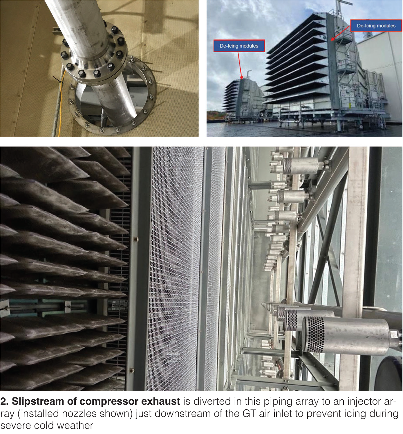

GT inlet air anti-icing. Presentation is mostly a richly detailed photo montage of one plant’s journey (update New York location) from an extreme snow and GT inlet-air-housing icing event in 2022 to an installed anti-icing system in 2023. The new system (Fig 2) “takes up to 5% of the compressor discharge (bleed heat) and diverts it to a 239-nozzle injection grid installed in front of the pre-filters.”
Key features include hard stops on the control valves, auto-draining filters on the anti-icing instrument air supply lines, and fully operable inlet bleed heat (to bellmouth), with the control logic permitting the IBH to override the de-icing system to ensure compressor safety.

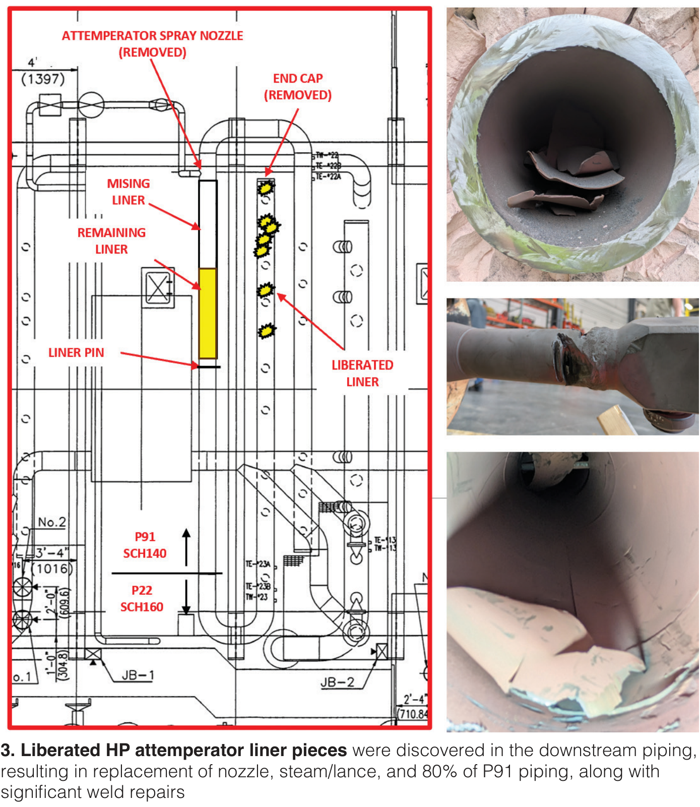

Attemperator failure. A 2002-vintage CC in Missouri reported on a high-pressure attemperator failure occurring in 2024, during which the spray nozzle and the liner were damaged, with pieces of the liberated liner discovered well downstream (Fig 3). Repair sequence included replacing the nozzle and stem/lance and patching welding where needed; performing non-destructive examination (NDE) on all P91 and P22 pipe, replacing 80% of P91; cut/rewelding poor welds; and borescoping, accessing, and replacing the liner.
The silver lining (pun intended) was that repairing and redesigning the attemperator could recover lost ST/G output. Other slides detail the pre-failure operational situation, distinction between an attemperator and a desuperheater, and explanations of how both work, major equipment, risks from failures, tips on inspections, and failure prevention. Regarding the last, this plant increased inspection frequency from every three years to annually. Also, if your GT has been upgraded, make sure your attemperator design is still suitable.

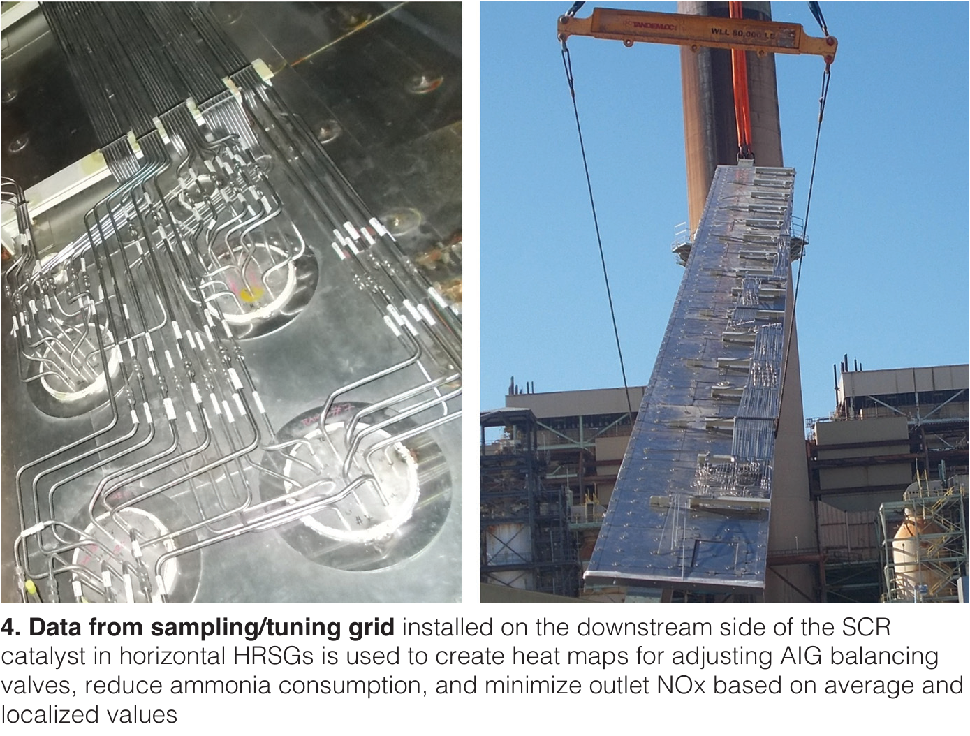

After a review of the SCR process and equipment, presentation explores causes of SCR under-performance, monitoring needs, and solutions, with a case study investigating NOx stratification at the stack. Holden emphasizes regular catalyst activity testing, as it is a better predictor of catalyst replacement intervals than ammonia slip (a lagging indicator), and maintaining SCR operating temperature within 50 deg F of its target.
To address stratification, plant in case study added distribution grid hardware between the ammonia injection grid (AIG) and the catalyst, trimmed the baffles, modified the outlet duct and stack geometry, and installed a permanent grid of “test ports” (Fig 4) for in-situ sampling and tuning.
During Q&A, about half the audience raised hands when asked if they tested catalyst samples. One user claimed his SCR had never been tuned, only cleaned, during its 23 years of operation. Others mentioned that high ammonia salts levels are being discovered because of sulfur levels in the exhaust from burning fracking gas.

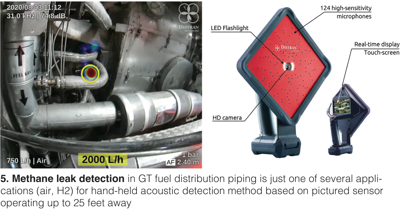

Move over snoops, soap sprays, and other ways to detect leaks. According to Distran, handheld portable ultrasound “camera” devices can check for gas leaks by converting the sound emitted into an optical image of estimated leak size, regardless of the type of fluid or composition. Background noise is filtered out. Devices can also detect partial discharges from transformers and electrical equipment. Leak detection is safer because the device works from 25 ft away (optimal distance). Some dangerous leaks, such as dry steam, are invisible to the naked eye (Fig 5).
Leakage flow is an estimate within +/-30%, good enough to make informed safety and O&M decisions. Several people in the audience vouched for the devices, one saying they are “really good for air leaks and checking H2 lines.” Power plant applications include hot air from gas turbines, methane in fuel systems, condenser vacuum leaks, steam, and H2.

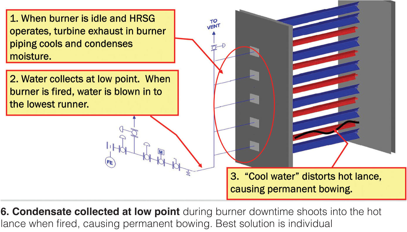

Seemingly anything that might go awry with a duct burner is covered in this 60+ slide presentation, and that’s after the basic review of its purpose, location, and components. The photo gallery is a veritable no-cost guide to what to look for when inspecting your HRSG aux burners.
Two non-obvious recommendations:
  • Conduct a CFD (computational flow dynamics) study after a GT upgrade. Mal-distribution of turbine exhaust can damage side wall liners downstream of the burner elements and flame holders, and cause coking.
  • Add block valves and drains to prevent condensation from collecting in the lower manifolds when not operating (Fig 6). Moisture can cause burner element deformation upon firing after downtime when the cold moisture shoots into a hot lance.
One obvious, but obviously neglected, recommendation: Install better viewports so you get good eyes on flame shape and distribution, and potential impingement on pressure and non-pressure parts. Even better, consider installing video cameras on the floor, roof, or walls for 24/7 monitoring in the control room.
