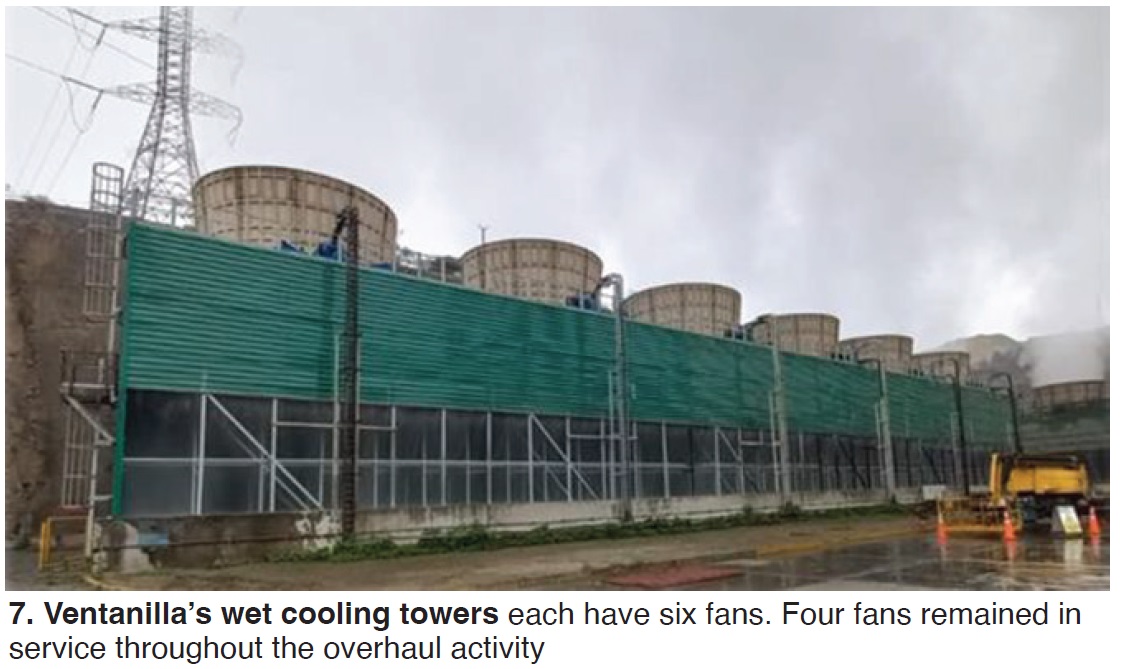

Challenge. Ventanilla’s No. 2 cooling tower had deteriorated to the point that a total failure was a distinct possibility. Loss of a tower would force the plant into a 1 × 1 configuration with a loss in revenue of about $100,000 daily.
A thermal study conducted in 2018 revealed the following:
- An increase of 1.4 deg C in cold-water temperature compared to historical data. Causes included clogging of circulating-water circuits by sediment and leaks.
- A thorough inspection in 2019 identified severe structural wear and tear (Fig 6).
- A flow imbalance between the two towers which caused non-uniform heat transfer and operational inefficiency.
Solution. A complete overhaul of the tower (Fig 7) was necessary to increase cooling-air flow—including fill replacement—and to reduce the temperature of circulating water flowing to the condenser.
To increase air flow, it was necessary to stabilize the tower by reducing the vibrations attributed to worn/broken structural members. But because the entire structure was in poor condition, plant management decided to replace it, changing the structural material from wood to glass-reinforced plastic (Fig 8, left and center).
The upgrade work was conducted in a manner to keep the plant operating. This was done by removing only two cells from service at a time, leaving four in operation.
Also, to guarantee the circulating-water temperature at its design value of 2200 m³/h, the orifice plates for each cell in the six-cell tower were resized for a balanced supply condition and even distribution in all cells.
Result. Increasing cooling-air flow and changing fill improved tower performance to deliver 0.7 MW of increased generation. The financial impact was an additional $134,000 in energy production annually plus a $41,000 boost in capacity payments.
By removing two cells from service at a time, rather than all six, saved an estimated $6 million.
