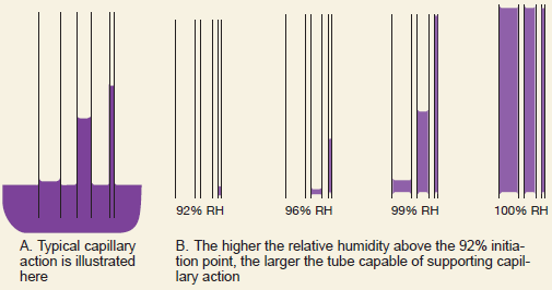

Capillary action is not well understood by many power-industry personnel. Without a strong background in related studies, the intuitive explanation of capillary action almost certainly will be guessed wrong. Capillary action occurs because water molecules want to stay close together. The resulting adhesion causes the molecules to be attracted to each other but also to adhere to other substances.
In a small tube, or a set of parallel plates that are sufficiently close together, this adhesion will cause a force on the liquid at the edges and result in a meniscus which turns upward. The surface tension acts to hold the water surface intact. Capillary action occurs when the adhesion to the walls is stronger than the cohesive forces between the liquid molecules. The height to which capillary action will take water is limited by surface tension, the diameter of the tube (or plate spacing), the relative humidity, and fuel viscosity. The same effect occurs with both horizontal and vertical capillaries.
A moist atmosphere (dew point temperature approaching the equivalent of 92% relative humidity) will allow capillary action to take place. Fig A illustrates capillary action in three tubes of different diameter; Fig B illustrates the effect relative humidity has on capillary action.
The conditions under which filling occurs are peculiar. With dry air (no humidity) at the end of the capillaries, the tubes contain only air; there is no capillary action. With the humidity increased to the point of moisture condensation, water starts to condense inside the smallest tube. This phenomenon only begins to occur at about 92% relative humidity (RH).
Increase the humidity further and water starts to condense in the next larger tube; meanwhile, the smaller tube has taken on more water. With nearly saturated air at the end of the capillaries, water starts to condense in the largest tube; the smaller tubes have taken on more water. Under saturation conditions, 100% relative humidity, the capillaries continue to fill toward maximum.

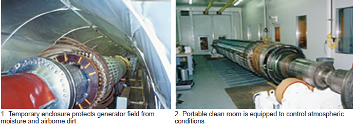

For the rotor, on high-speed generators—for example, 2-, 4-, or 6-pole machines—an enclosure should be provided. This may be as simple as a temporary plastic sheet enclosure or a more complex transportable enclosure (Figs 1 and 2). In every case where humidity can be controlled using dehumidifiers and/or heaters (and cleanliness assured), it should be done. On low-speed units, such as large hydro-generators, control of humidity (and cleanliness) can be challenging.

    • Perhaps the easiest way to remove moisture is by machine rotation. The windage loss provides heat and rotation provides ventilation. This method, of course, is not effective on a closed ventilation machines—such as hydrogen-cooled generators.
    • At standstill, drying can be accomplished by supplying dry air and/or heat. This may become rather complicated and may take several days to accomplish necessary moisture removal to reach satisfactory insulation resistance and polarization index.
